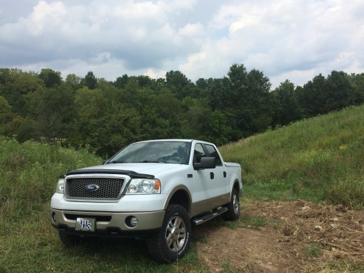

I thought I'd start and share a build thread upon the suggestion of a member. My current truck is a 2007 F-150 Supercrew Lariat 4x4. I've owned the truck for about five years, but really only started modifying the suspension within the last year. I love what I've seen from everyone in the Build Threads section and this will probably pale in comparison to what some of you are working on, but I thought i'd join in on the fun.
Here's my old man truck as it currently sits.
Current mods:
-2.5-inch Rancho Quik-Lift Coilovers
3-inch MotoFab rear blocks (steel, not polyurethane)
-275/70r18 BFG A/T KO2s (33-inch)
-MBRP exhaust
-PowerStop drilled and slotted rotors
Planned Mods:
-Warn winch (with hidden winch mount)
-Replace stock running boards with rock sliders
-Replace tonneau with ARE or Leer full Camper top (should make storing and loading gear much easier)
-Any suggestions from fellow outdoorsmen/overlanders on here!
