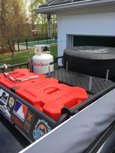

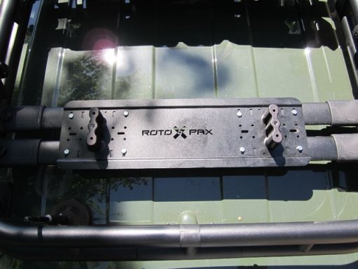

Snapped a couple pre powdercoat shots of the Rotopax and the tank mount. Everything's coming together just like I planned... which makes me worry haha.
I hate those disposable bottles for a number of reasons so I wanted to get away from having to use them. Tank is a 1 gallon/5lb bottle that I can use to run multiple things at the same time. It's lockable and as usual I'm using Fourtreks to mount things up. Rock solid and unbelievably versatile.
The locks are removed but the rotopax cans fit perfectly across the Yakima Load Warrior. I have 2 fuel and 2 water cans. Front and center you can also see the Fourtreks mount that I adapted to hold my highlift jack base.

That looks great! How do the Rotopax secure themselves? I've been thinking I may need to grab something like that for bringing water/fuel on upcoming camp outs. Do they just free float in the basket? Can't quite tell from your shots.

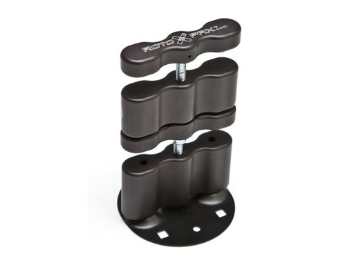

Thank you. There's a plate with uprights that pass through the cans.
I have extensions to be able to secure more than one can. Everything threads into each other and then you tighten the top handle down to secure the cans in place.
Lastly I use the LOX mounts as a theft deterrent instead of the regular one pictured above. This is what's removed in my picture to keep it out of the weather until needed.

Is the propane bottle holder also from Fourtreks? I have the same bottle and all the mounts I have seen are for the other style of 5lb propane bottle.

It's not from Fourtreks, only what's holding it in place is. It's a modified 10lb bottle holder from Powertank. I obviously had the same issue finding a solution and discovered that their 10lb bottle has the same diameter as that 5lb bottle. From there it was easy.

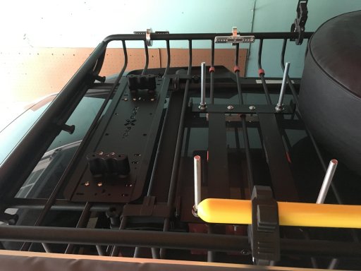

As much as I like the BROG bag for my Traction Jacks I've always wanted them on the roof. I know you can 'mount' the bag up there but it's really not a great setup for a busy basket. Pretty happy with how it turned out. VERY little wasted space.

As much as I like the BRO bag for my Traction Jacks I've always wanted them on the roof. I know you can 'mount' the bag up there but it's really not a great setup for a busy basket. Pretty happy with how it turned out. VERY little wasted space.
Looking good, dude! How'd you mount those long bolts to the basket for your TJ's?

Any leak issues with having the rotopax mounted horizontally?
Thank you! All of the cans are brandy new so I have zero experience with them. I'll probably run one gas and one water can this weekend to try them out but to my knowledge there are zero issues running them flat. I searched a lot before pulling the trigger on them a couple months ago because it was a concern of mine and the whole reason i wanted them.
+1 [emoji16]
Thanks! Initially I bought a universal Traction Jack mount that was going to go on my rear bumper. I haven't had the time and I wanted them out of the car in a bad way so I cut the mount. It sat lower than the rest of the flat steel and as a result was in the way. Using the existing holes between the long bolts is where I secured it. I used SS hardware and cut angle aluminum long enough to sandwich 3 crossbars of the basket. I apologize because I meant to take a picture with nothing in the way but forgot. If this were my original plan I definitely would have fabbed something up myself.
After maybe three trips, my traction Jack's started wearing through my roof mounted BROG bag. So good call getting them mounted.
Thank for confirming one of my concerns with the bag in the basket. It's been fine in the back of the car but they're noisy, in the way, and lets be honest here...Subaru. Hahaha.
