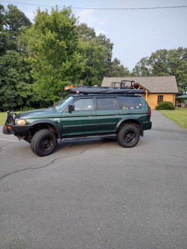

Here's the Raider:
Here's the Sequoia, which is used for some camping and mild offroad stuff, but mostly for towing and recovery of my stage rally car and hauling gear
Here's the Trailer, with the Raider and my old Sequoia

I have a 01 montero sport, I agree that different builds make it fun.
nice! The guy who leads most of our trips actually has a Montero Sport as well (I forget what year) that he also uses for stage rally Sweep. He's slowly building it up, but it's quite capable even stock-ish with good tires.
