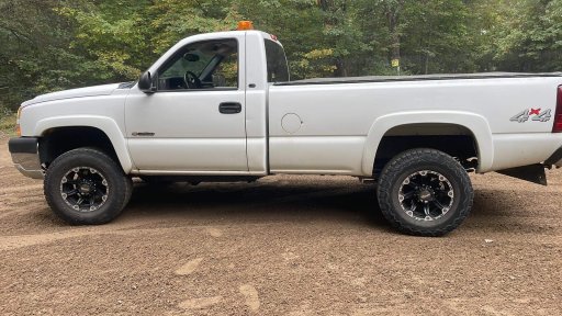

So I have a 05 Chevy Silverado 3500, 6.0, 4l80, so I'm going to start off by saying I occasionally haul things but really want to use this thing for off-roading mainly, maybe even just getting to a destination with a trailer and sleeping the night, other times it may be full out 2 tracks and mountain climbing, not sure what to do suspension wise, obviously it is one of the most important pieces of overlanding, not sure if anyone has any ideas, currently have a stock ride height and not afraid to lift it just want to make sure I make the right choices and not just blowing money away. There's a picture about as it sits, removed the top light, will be removing the rear plow setup soon.

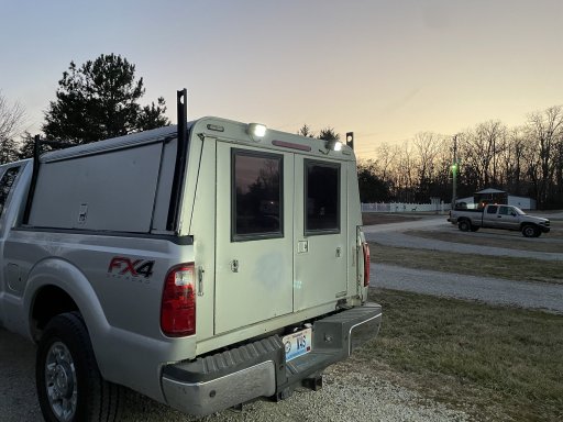

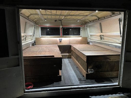

I'd find a cheap topper like mine, add some bunks and storage and hit the trails. I slept in my a few weeks ago and woke up to 32*. Didn't need a heater with a good bag and hiking matteress.

Did you do anything to suspension at all or just went with stock? I do have a hard topper I need to paint and get a back glass for then I'll be in the works of adding some type of sleeping arrangement.

Yup I'm at a point where I've been looking into lifts and some different suspension setups and I think I'm going to go for a 6" lift which is 6 in the front and 4 in the back so I can run some deaver springs which unfortunately only have a 2500 but the quality on them is immense, then probably go with a bilstein or fox shocks.
