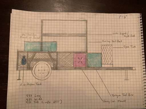

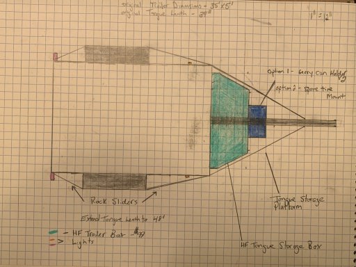

So, here’s my mock up on a 3.5’x5’ carry on trailer from Lowe’s. Going to flip the springs as soon as I get to increase clearance. Ideally, I will replace the axle with at least a torsion axle, if not Timbren independent, strengthen the frame, extend the tongue along with a lock n roll/max coupler (still researching which is the better option), sliders and an RTT tent. Going to use the “steelies” off my BD (replacing with Pro Comp D windows) so I can match up the bolt patterns. Should be able to make a handy, versatile trailer out of it.807D98E7-C1B1-40A2-942D-E200CB9F6902.jpegA7387BAB-26CD-493D-9C33-B168CA0D9C7B.jpeg
