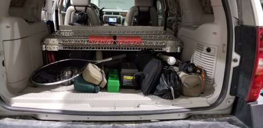

For your end shelving I would consider metal wire shelving units. You can install hinges on them so it will easily lift up plus you can secure items under the shelves too. They are very strong and pretty light too and do not need any bracing in to the floor in the middle. Plus it only takes a few minutes to lift them out. This photo is with the last section folded over for easy access.

Thanks Charles! Really enjoying the build process and the creativity aspect.
That’s a fantastic idea! My plan at the moment is a solid wide drawer. A man RV company (Mor/ryde) makes one that I have been eyeing. The idea is to build a pull out kitchen on it space for a Dometic fridge.

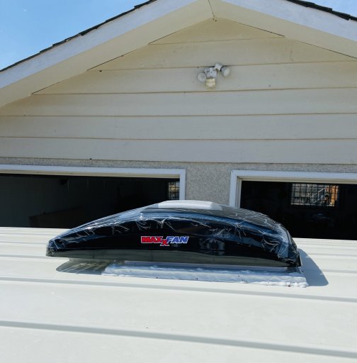

This has been a moment I have been dreading from the moment I decided on installing a maxxair fan. After the first drill hole it gets easier!
Enjoy the down time folks and keep healthy. As a frontline healthcare member in Emergency I cannot stress enough to keep up with social distancing until this Covid19 is under wraps!

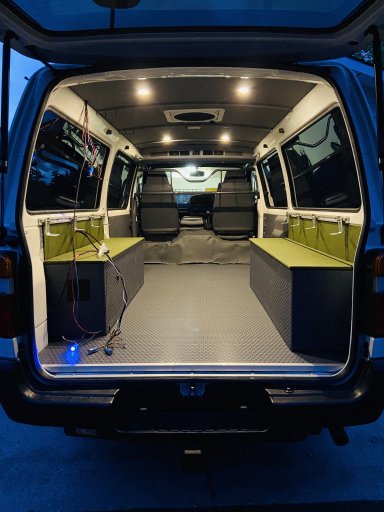

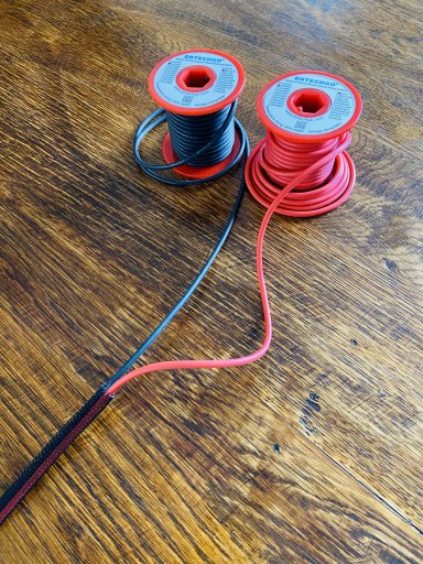

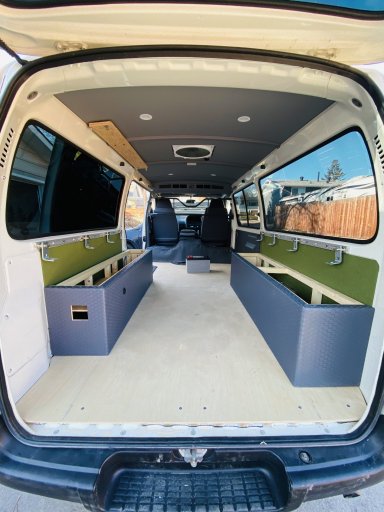

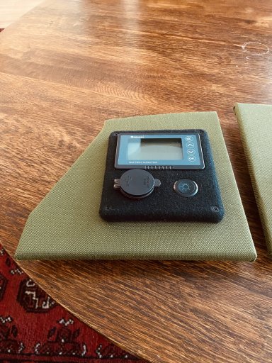

Progress is slow.... actually wiring is slow haha. Up to this point I have ran all my wiring for my LED pot lights (2 in the rear hatch for the kitchen, and 4 in the main overhead with 1 below for the gear area. Fan has been installed. Today I finished the fab job on my magnetic panels, wrapped in Denier fabric. Trying not to get ahead of my self.
View attachment 148709 View attachment 148710 View attachment 148711

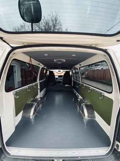

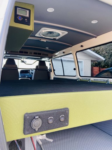

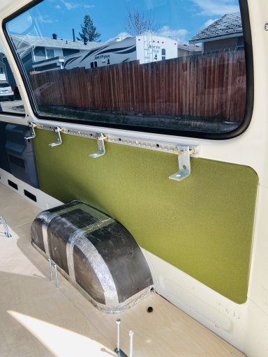

Finally getting closer...

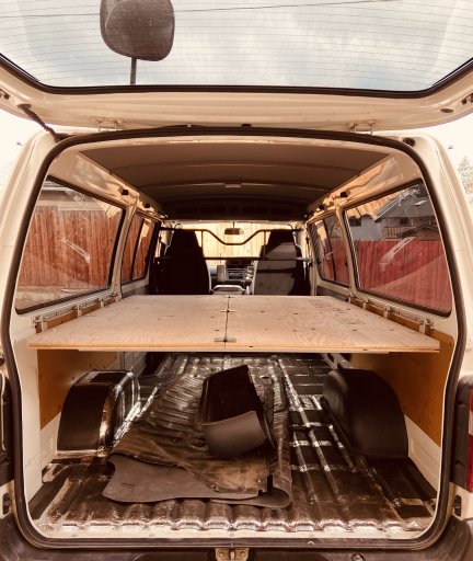

Interior is nearly complete. Still need to get the slider tray ordered and installed. The bed height is temporary at the moment and will be raised to accommodate a Dometic cooler height. The new bed height will allow access to the right hand side wheel well storage compartment.
Big ticket items to be purchased are the pull out cargo tray, 2 person seat, and roof rack.
View attachment 155590 View attachment 155591 View attachment 155593 View attachment 155592 View attachment 155594
