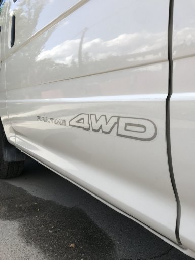

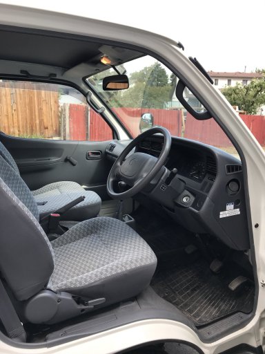

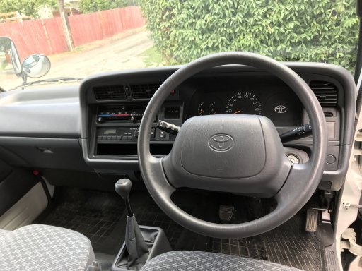

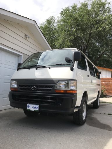

Hello fellow Overlanders!

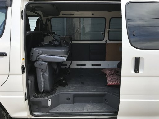

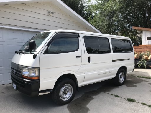

New to overloading and new to this beauty that I recently imported from Japan. The build will be a slow process as I prioritize what I want to focus on so bear with me and enjoy!
Specs:

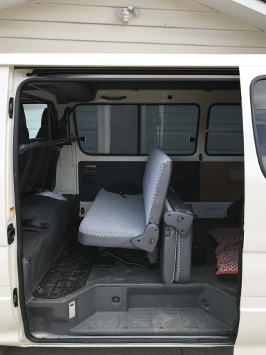

2003 Toyota Hiace 4WD - Long wheel base

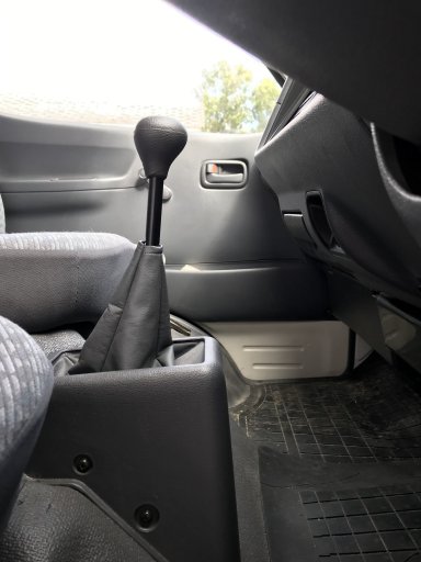

5spd manual Diesel
Original 8,750kms on the ODO.
Carrying capacity 1250kg
Seats 9 currently
Creature comforts: AC & Heat front cabin and separate AC & Head for the rear
Additions so far:

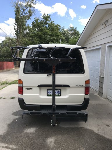

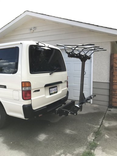

Custom 2" receiving hitch
Kuat Swing away
Recon Rack x4 Bike Carrier
The mechanic who inspected this vehicle when it came into port said it was the cleanest vehicle (interior/exterior/mechanically) he had ever inspected from over seas. He has been inspecting vehicles for over 15 years and inspects roughly 300 vehicles annually. Ha I just did its 2nd oil change of its life!

I love clutches. Not sure how well I'd do shifting with the wrong hand tho.

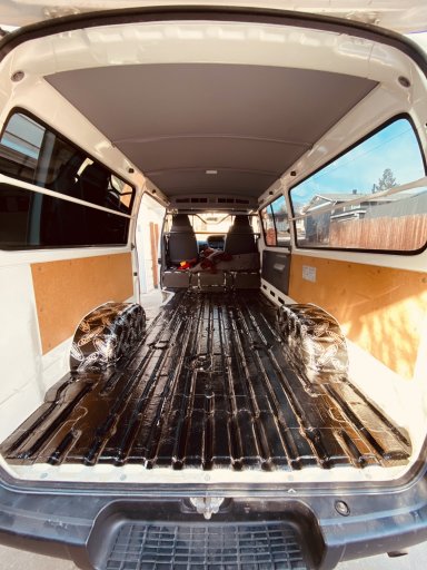

1st step: Vacuum/wipe surface with isopropyl alcohol
2nd: Apply Noico Black 80mil
3rd step: Noico Red 150mil (Pics tomorrow)
I had some Dynamat material that I covered the rear wheel wells with and my impression of the noico vs. dynamat is that the dynamat is much easier material to install and work with. Both materials offer a great reduction in road noise however up to this point though anything was better than the previous tin can noise.

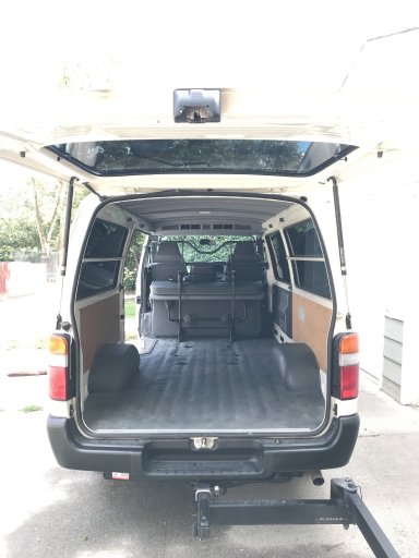

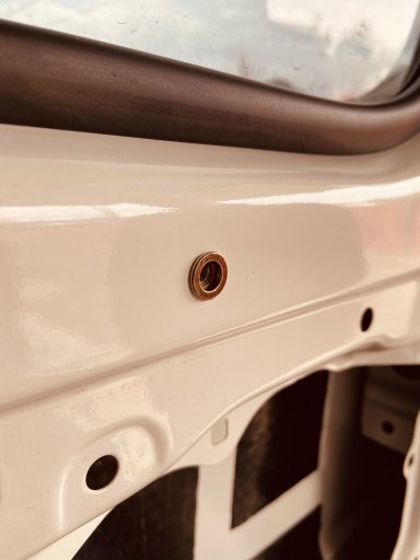

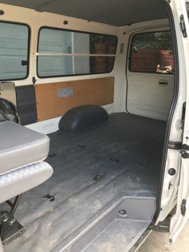

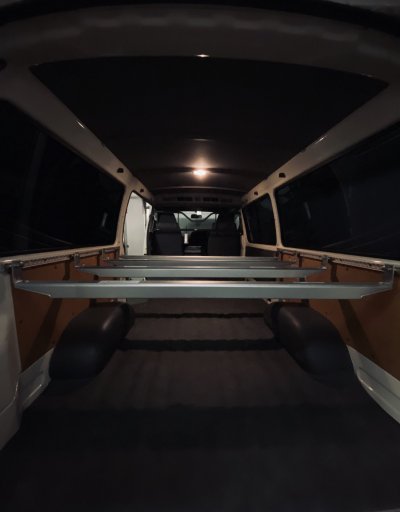

Made a little progress today. I officially screwed the first few holes in the van for the rivnut application and mounted the L track. Still a long way to go but a step forward none the less. Have sourced all my fabric options and waiting on swatches for the panels. Tomorrow I will hopefully get the mounting brackets for the L track finished and the cross members on for the bed platform.
Goal: Simple and clean.
Rivnuts are the cats meow (installed correctly). Super easy install.
Thinking about applying Rockwool for insulation behind the panels. Thoughts?
Feel free to critique/suggest as this is my first build.
