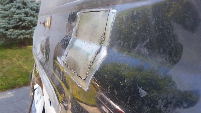

Fix up the body - Just rockers for now, frame is surprisingly decent.

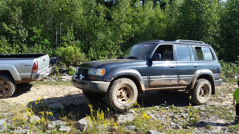

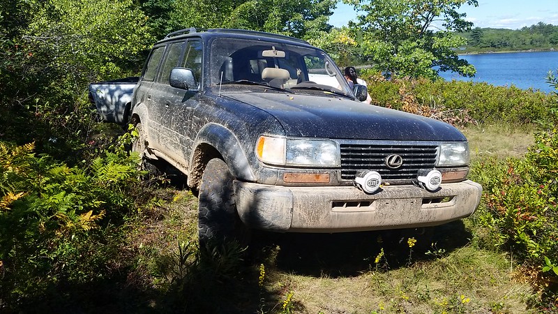

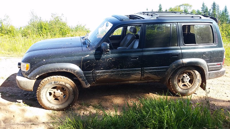

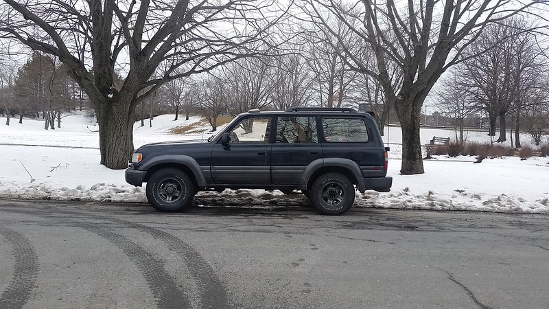

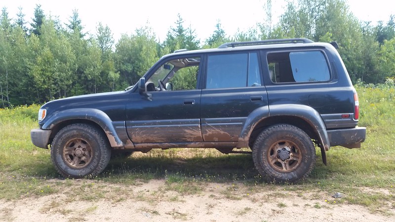

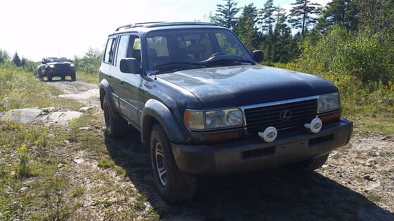

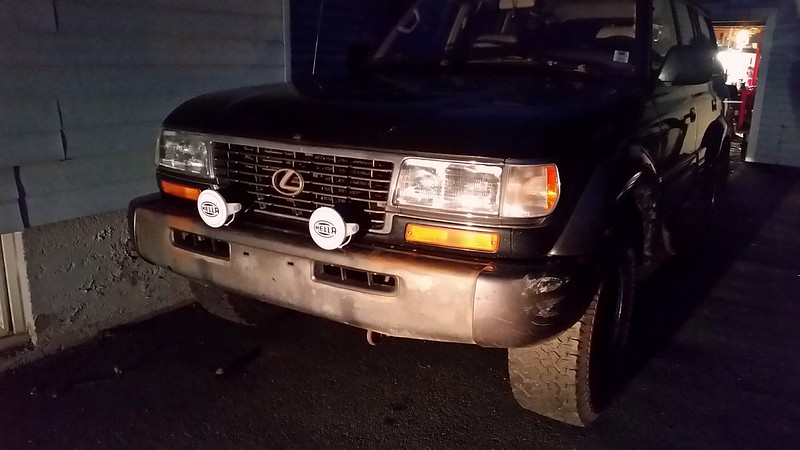

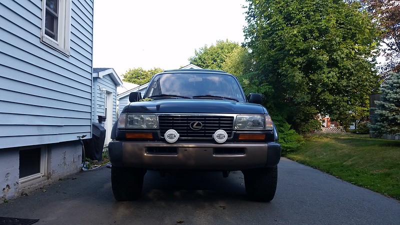

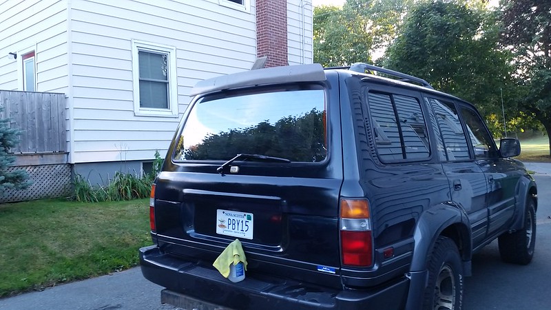

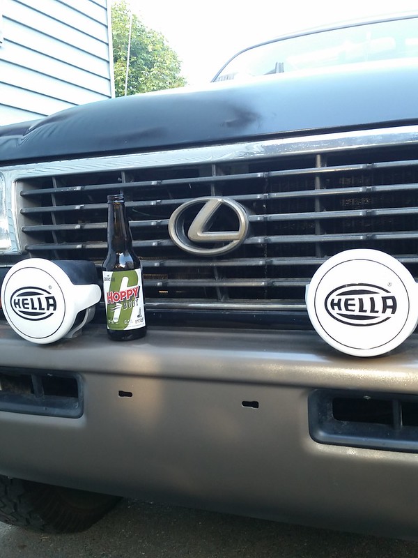

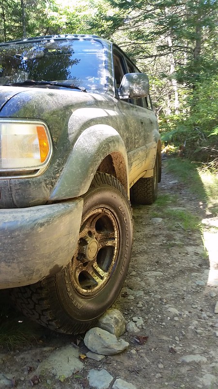

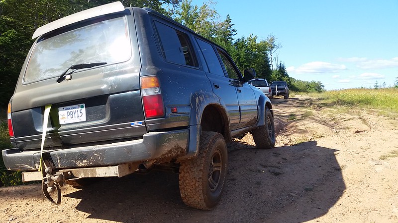

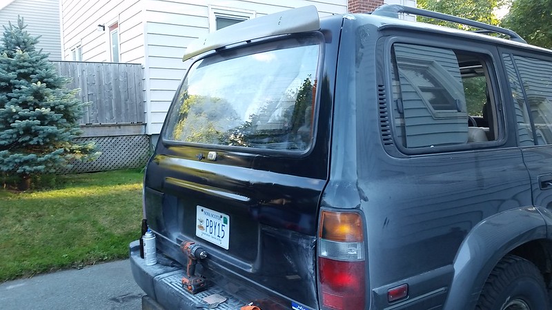

Here is some pictures of the truck, I put the lights on the thing the other day, aside the Hella's it is bone stock

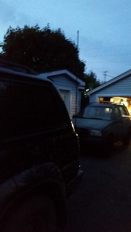

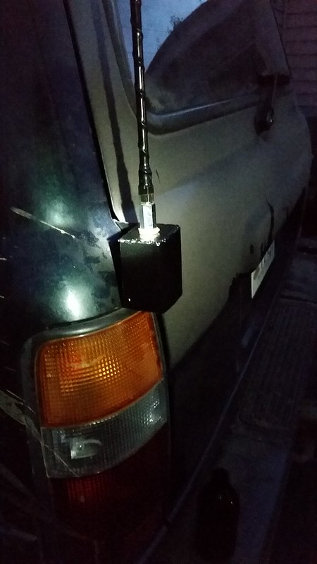

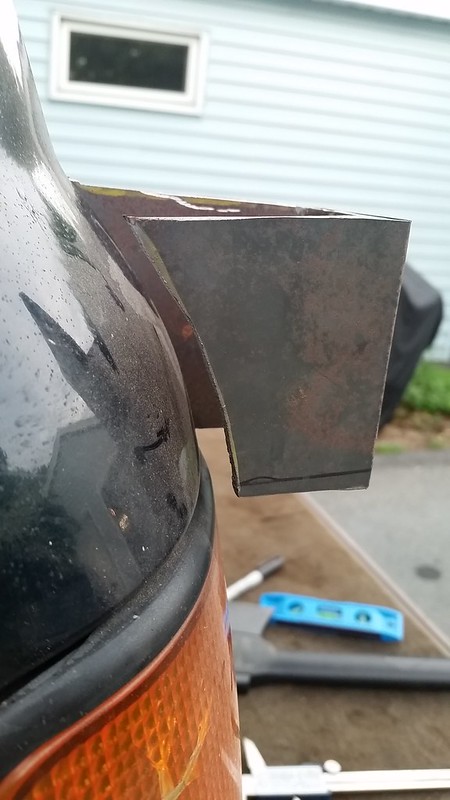

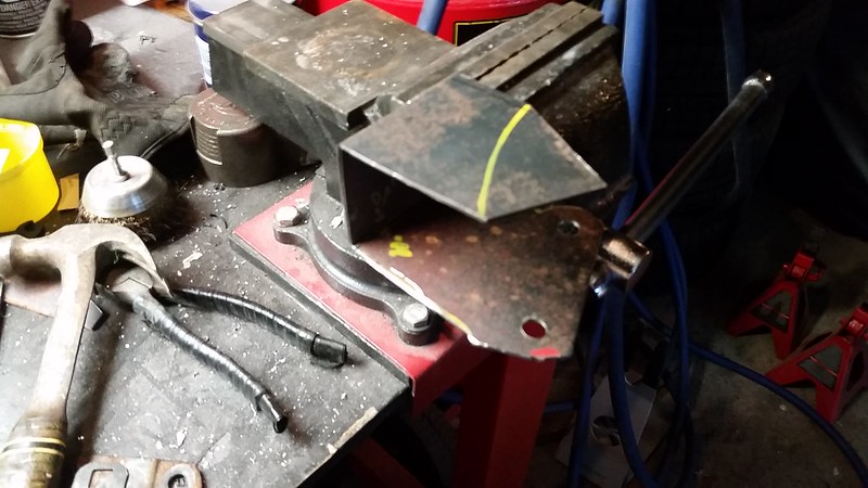

I fabed up a CB antenna mount today after the second trail run i did in the truck :)
20160905_185917 by Andrew Turner, on Flickr
20160905_190547 by Andrew Turner, on Flickr
I decided to cut out the curve for fear of the sharp part hitting the body when the antenna bends around as it does.

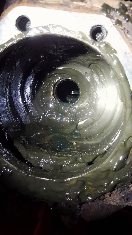

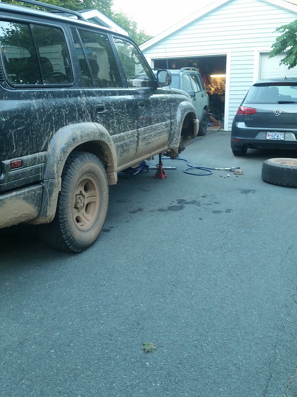

This week I repacked my front bearings with grease, and reset the preload. I also added some grease to the birfields through the access port. In this process I have decided that I will be doing a knuckle rebuild at the very least. Potentially also new birfs.

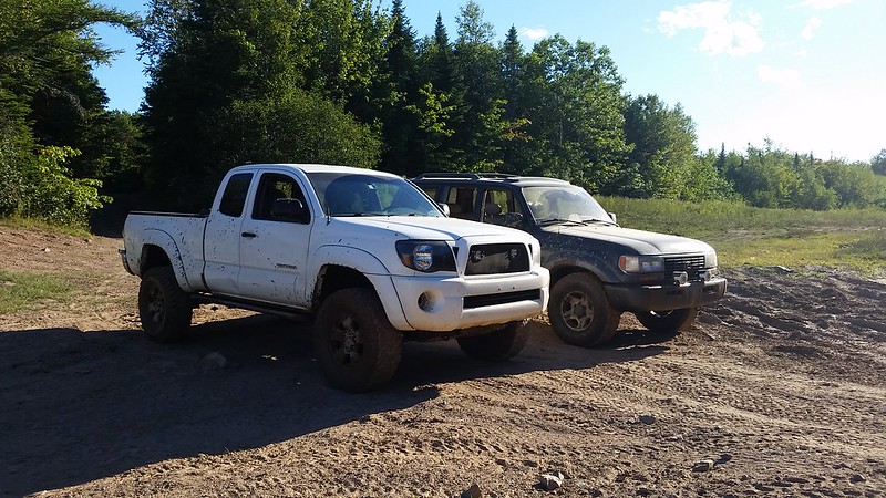

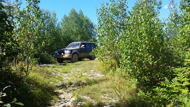

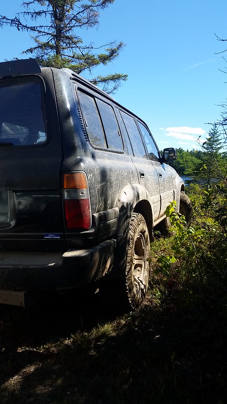

I also went on a trip with my best friend today to scope out some deer hunting spots for our 4 day camping trip comming up in November.

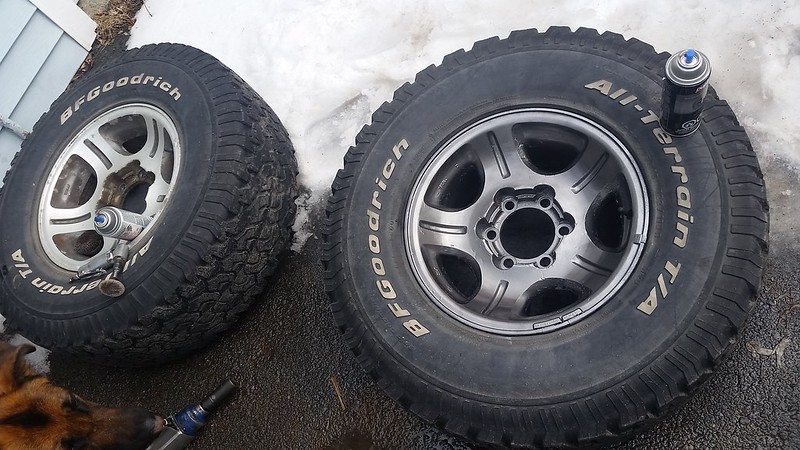

Installed new brake calipers a few weeks ago - 2 were siezed

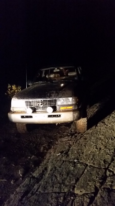

Also, this was an exciting adventure... A friend in a local offroad club got a new Rubicon after his previous Wrangler burnt to the ground while parked. I decided to go with the small group for his first trail run in the new Jeep. I had just installed new brakes as previously mentioned and had not driven the truck much in the last month. All was going well, Pearl, my German Sheppard was enjoying her first run in the truck, then when going through a slightly off camber section, I hear a noise - and my truck is getting sporadic power. I get out to make sure nothing is leaking, all seems fine. I go to move again, and it just sounds like someone trying to drive a manual transmission with no knowledge of how to do so. My thought initially was birfield joint, but at this point I'm about 4 kms back into the woods and it is about 9:00 at night.
20161020_195533 by Andrew Turner, on Flickr
Here she sits. Immobilized with only Jeeps to save my sorry ass. Time to swallow the pride and get some help from the fellow offroaders (there was many a joke to be had, but we all support eachother no mater what we drive! Its like being a brother - always have to give the other guys crap).

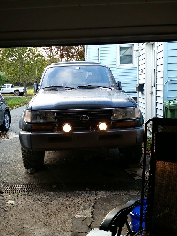

I also decided to finally wire in these lights! They were also on my old tracker and I never wired them - It will be nice to have as we move into a season where I drive to work - and home from work in the dark!

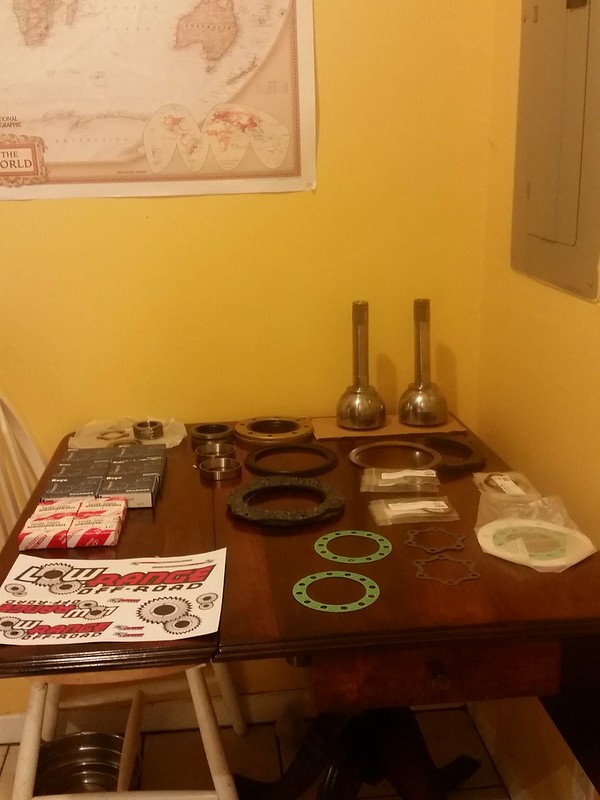

i put in new birfields and rebuilt the knuckles a few weekends ago (surprisingly easy job I thought) no progress pics because, as anyone who has ever done this knows it is a incredibly messy job! Did get a pic of my part spread though! :) I used Longfield Chromoly birfs in the stock shafts. Should be plenty for my needs.

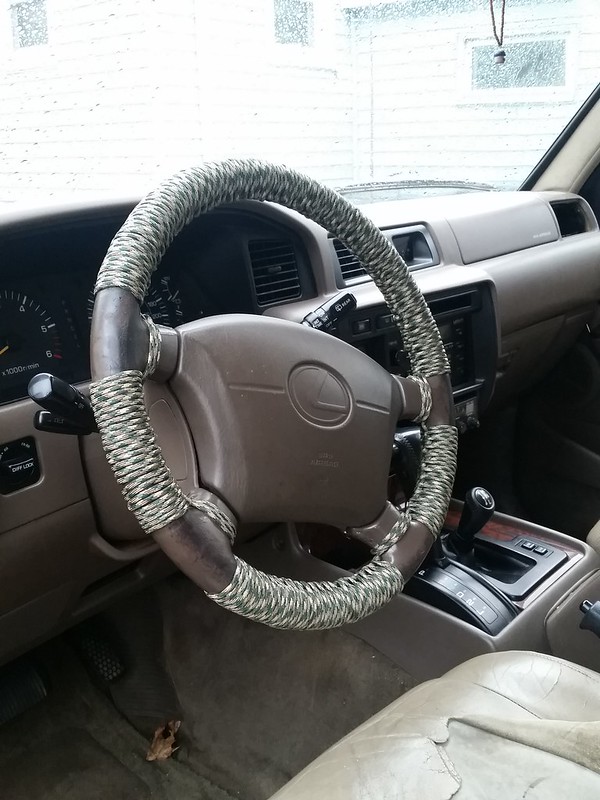

also did a paracord wrap on my steering wheel to cover up the tattered old leather. turned out well i think considering it is my first time working with paracord.
IMG_20161127_104849 by Andrew Turner, on Flickr
