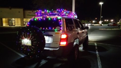

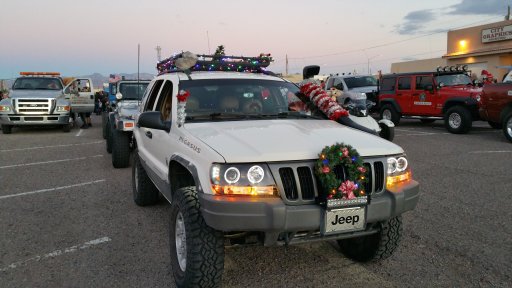

20161202_173458.jpg Friday I helped Represent the Bullhead 4 Wheelers in Bullhead City's Boom Box Parade. We had probably 5 vehicles out to represent B4W. It was also the last run for the dinky cigarette lighter inverter. The new one arrived late, so I was rather limited as to what I could do with lights.
