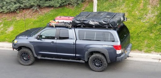

Here are some pics of my Tundra overland built since I started approximately on year ago
20190203_070749.jpeg20190219_190716.jpeg20181119_121149.jpeg20180227_064215.jpeg20180812_201043.jpeg20180526_134051.jpeg
Reactions: Desert Runner
This is awesome to see! I just joined and to see your transformation over the year is really cool! This looks like a great community and I’m glad I stumbled upon this forum! Nice Rig!
Thank you very much. If you have a chance, go to one of the monthly OB meet-ups in your area that's where you can really get some amazing ideas for your rig. Here are some of my future upgrades:
  1. Expo One dual swing out rear bumper (en route). 14 weeks and still waiting. Finally got it; it only took six months. DONE
  2. Solar panel on top of the cab (have it waiting for the rear bumper; so, I can move all my recovery gear from top of the cap.) DONE
  3. Lights, lights, and lights (got the lights but need to save for the Switch-Pros). DONE
  4. Replace my little Odyssey PC 1750 battery for the Odyssey PC 1800 FT series, but have to save up for a bigger alternator (270 Amp) to recharg it and the solar solar panel to maintain while the engine is off. Done (didn't need the bigger alternator; the solar panel did the job just fine but had to get the 40 amp MPPT and worth every pennies), DONE
  5. Onboard water tank for cooking and showering (placement in where the spare tire was, underneath). DONE
  6. Upgrade my King Coil spring to 750 lbs and Deaver Custom Leaf Spring to stiff it up a little. DONE (Feb 2020)
  7. Cook Partner Stove 22" . DONE (Jun 2020)
  8. Budbuilt full stainless under armor. Still saving my pennies for it. DONE (June 2020)
  9. ARB twin compressor to replace my Powertank. Love the Powertank but I have a 20 pounder that takes up so much space in my Decked drawer. DONE (Aug 2020)
  10. Relocated the differential breathers. DONE
  11. Regear to 5.29 and Eaton eLockers. DONE (Mar 2021)
  12. Snorkel installed. DONE (May 2021)
  13. Auto start installed: DONE (May 2021)
  14. Conduct more runs to new places and complete the South Utah Traverse
Was able to install the Switch-Pros and lights on roof (underneath roofrack), front bummper, rear under RTT, and A Pillars this weekend. Here are some pics.20190323_142341.jpeg20190322_180020.jpeg20190322_180114.jpeg20190324_100445.jpeg
