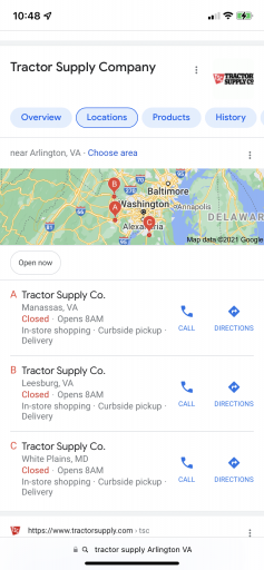

So I slept on this and I think the come-along might make a ton of sense. People kept recommending one and it seems like it can get you out of a bunch of sticky spots without a ton of work. I live in the city so there's no Tractor Supply near me, and the ones on amazon do not look promising! Lots of reviews about failures after a few uses.
It looks like you have three Tractor Supplies near Arlington… TS also has free shipping as well.
