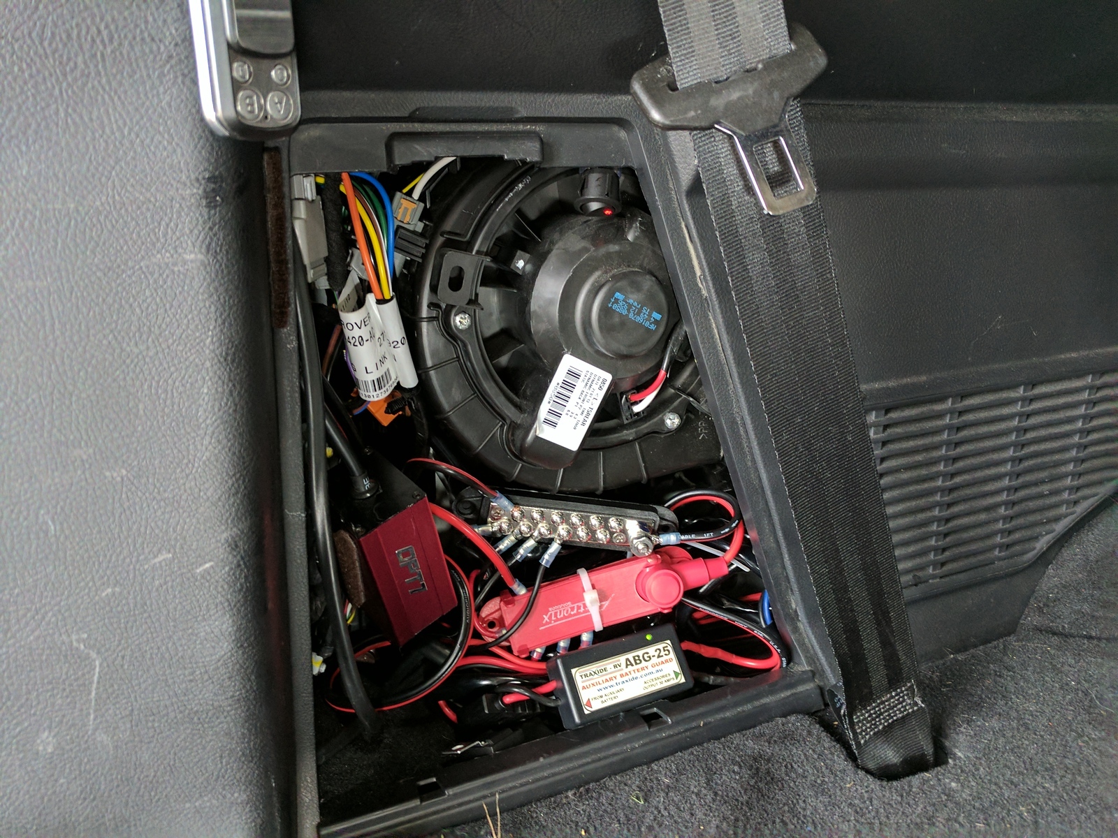

I was just out in the garage tweaking my setup. Moving some things around. I have a LOT of crap fitted into a small space. The factory 'aux' battery tray is used by the abs controller and a computer module and a few things. So I moved them around, made brackets, etc to make room for another aux battery and all the gadgets.
I need to figure out a smart way to run solar cables up my windshield A-pillars.
Both my battery trays have factory covers that seal them up pretty well, this is with the covers off.
Here is my factory start battery, upgraded to a larger size agm (fits with no modifications).
Next is my aux battery and all the toys to make it work. I love the Traxide system because:
  1. It ties both batteries together as long as the start battery is over 50% state of charge.
  2. thus, when the vehicle is running, alternator charges both batteries always.
  3. It allows me to use half the capacity of the starter battery along with the aux, so I drain my aux battery less (better for it)
  4. Its automatic, no switches, no forgetting and draining a battery.
  5. It supports reverse charging. When my solar charges the aux battery, if the start battery is linked, its charging it also!
  6. No dc-to-dc charger involved here, no clunky solenoids. Digital!
I also have another small traxide isolator in the rear cargo area that protects the aux battery from over discharge. The ABG-25. I also have an OPT7 wireless remote controller for my camp lights and the little distribution blocks for comms, fridge, air compressor, 50psi shower pump. etc. Also ran extra sockets and rewired factory sockets to be always on and use the aux battery.

I agree with the others, having a dual battery is extra work and expense. You have to maintain two batteries health. AGM require a bit more care to keep them healthy in my experience (mostly because of 'intelligent' land rover alternators). So having shore power charging etc is recommended.
Nice set up. Must see if I can find a UK equivalent of the Traxide, or see if they will ship at a reasonable cost to the UK. Think I'll be heading down the road of the Victron Bluesolar with bluetooth.
I bought mine direct from Australia. I just ran my solar cables up inside the a-pillar for solar. I don't have the cables hidden once they pop out of the a-pillar, they are just stuck to the black roof rail trim with some super strong 3m tape. Not sure if that will work long term.
