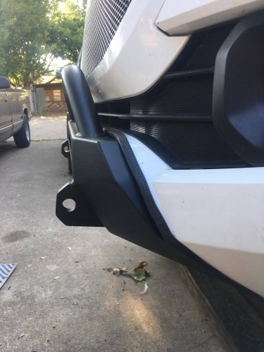

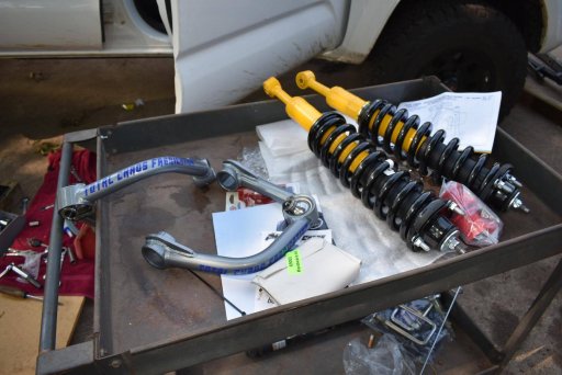

Okay little update.
Have ordered everything i think i meed at this time. I wanted to avoid a lift if possible.. well it wasnt ahah..
So things on order.
Emu heavy load 2" suspension complete kit
Total chaos bed stiffeners
Tradesman topper
SSO slimline hybrid bumper
Smitty built 10,000 lb synthetic winch
And a new grill for cool points.
For now it is just the waiting game. When the build starts pictures will follow.

I have the SSO bumper and love it!
I have the smittybilt and love it!
I have the total chaos stiffeners and love them!
