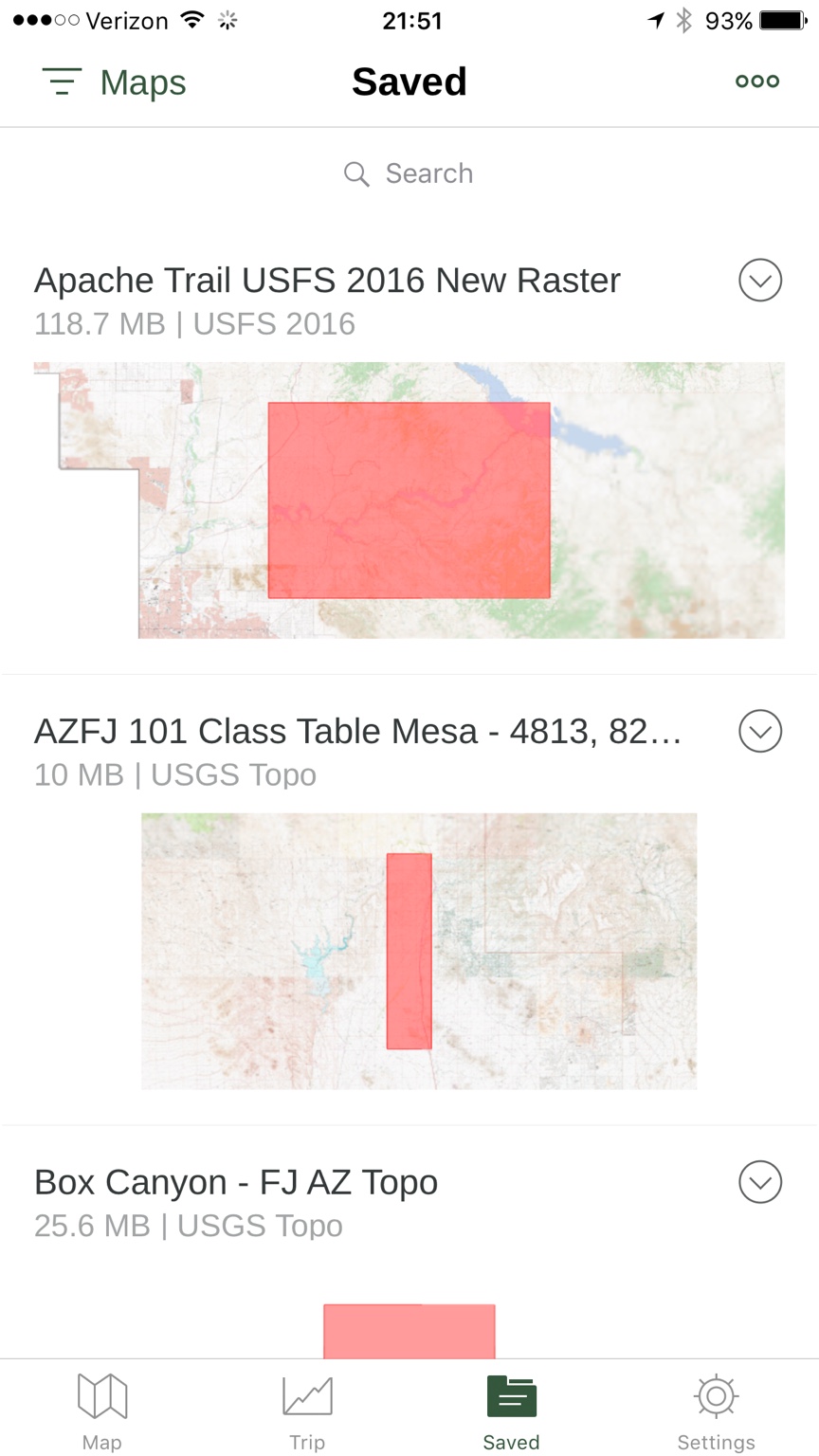

Be gentle with me - new guy with Gaia. Is there a way to load a large region into gaia - i.e. a couple of states at a time? And then to update those maps as necessary? im new to it, but it seems very tedious to load in small chuncks and keep track of what youve loaded in and how the regions fit together. in my limited experience, it limits you to a number of tiles - which is probably ok for hiking since you know your range pretty well - by not as useful for overland if you are doing a long trip. Am i missing something? Would appreciate any help.
In general, all versions, you can download an entire state of you want. It depends on how much storage space you have, the layers selected (if you are a pro user), and zoom level. When save any map you get to name it what you want and that will be stored in your settings for future use. A screenshot from my iPhone is below. Since you question is pretty generic the help files which Gaia provides online can also give you guidance.
https://help.gaiagps.com/hc/en-us/articles/115003525127-Download-Maps-for-Offline-Use

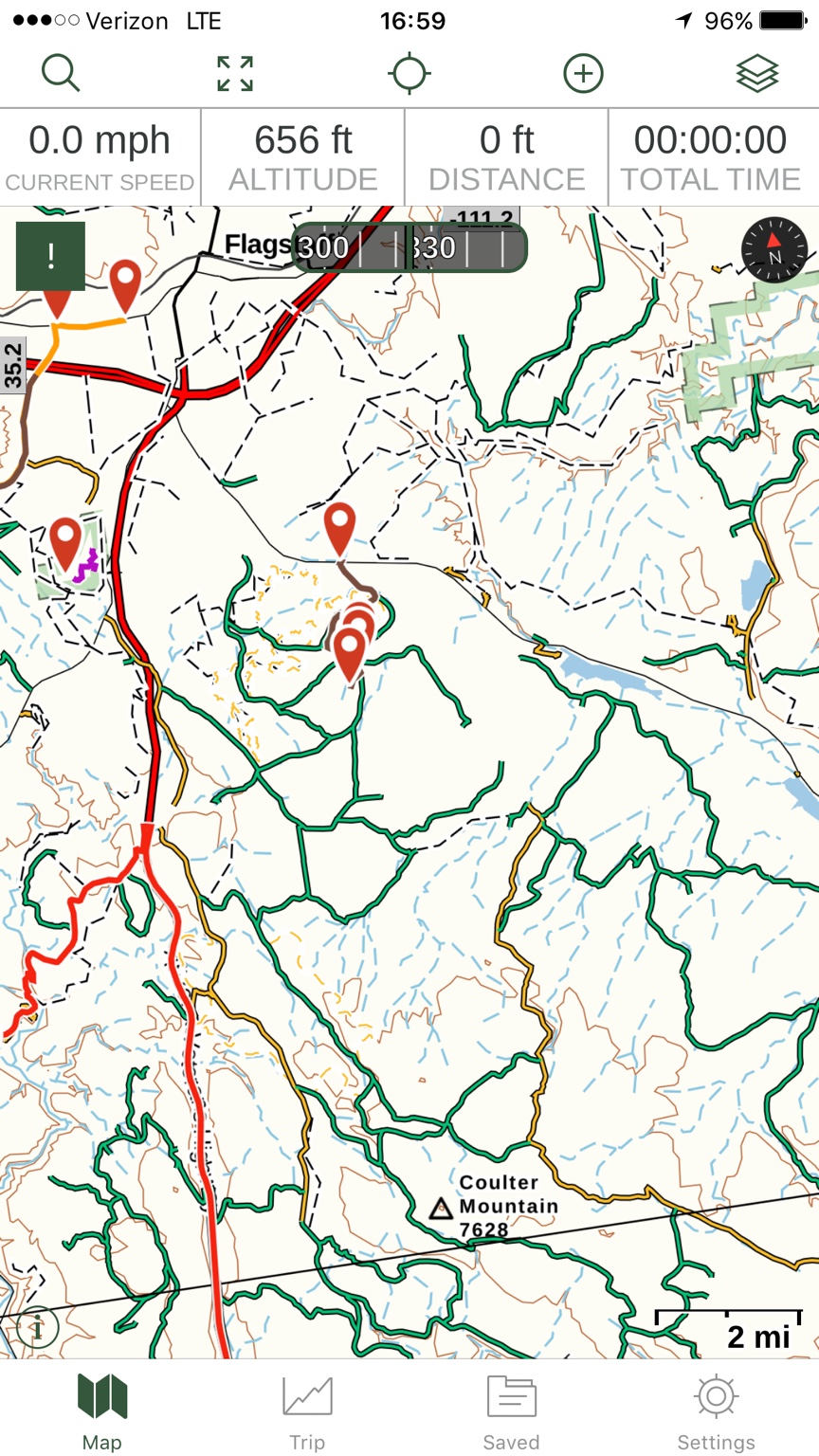

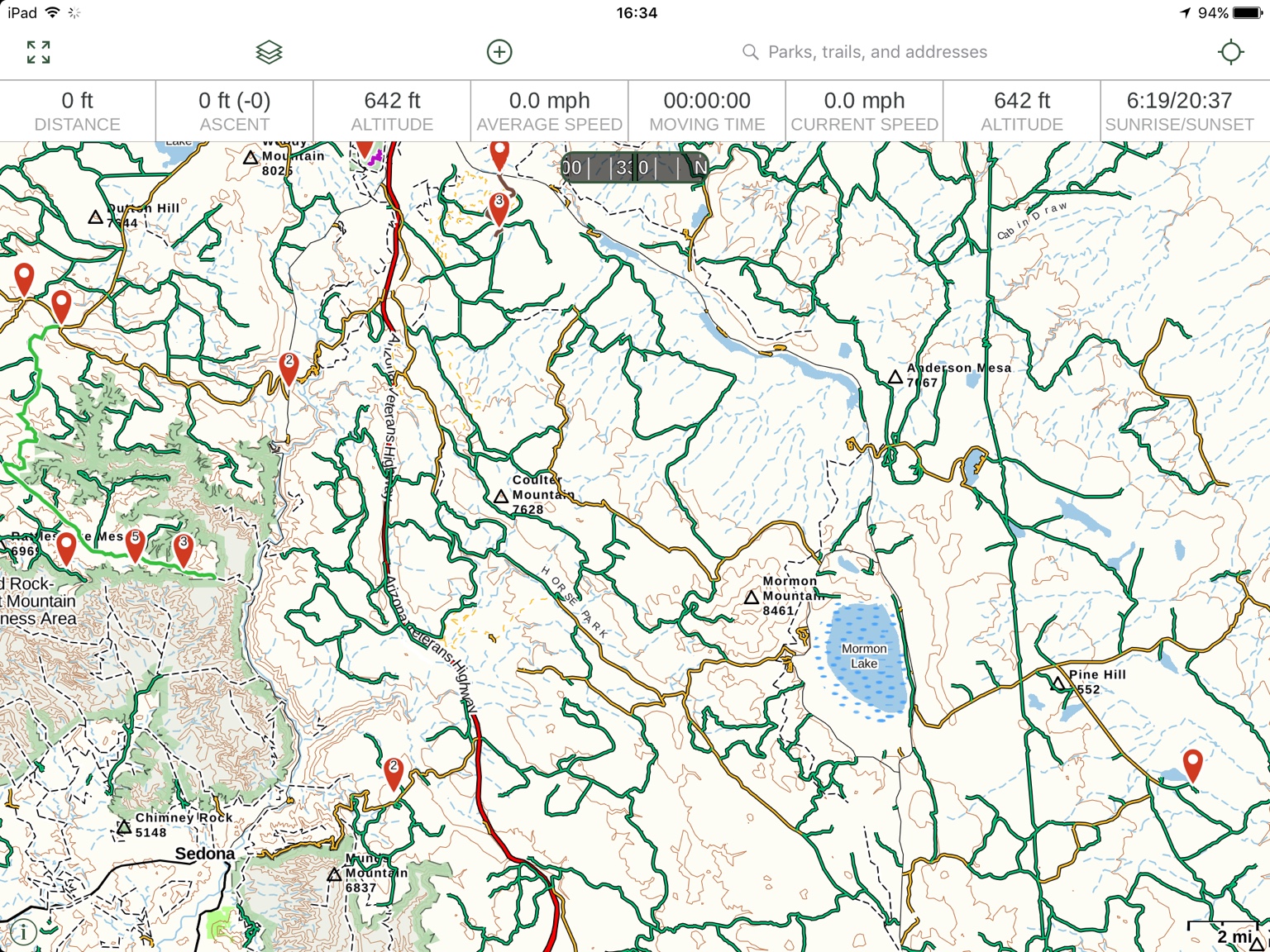

The MVUM map layer has been added to GAIA GPS!!!!! Latest version just released. You must have a pro subscription. More later. I have to read up on the details.
The layer is interactive. You can tap on the road and the app will provide details about access. I am hoping Gaia will put out a blog post to give further explanation.
From the Gaia Team - "Yes, it will work on Android/web, and Gaia GPS Classic if you have GaiaPro.
It's only interactive in the new iOS app though - you can't tap the overlay for more info on the other parts of the platform."
