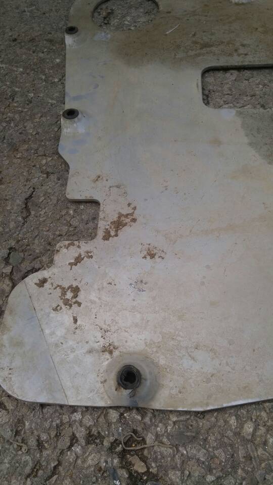

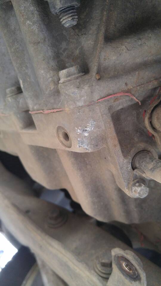

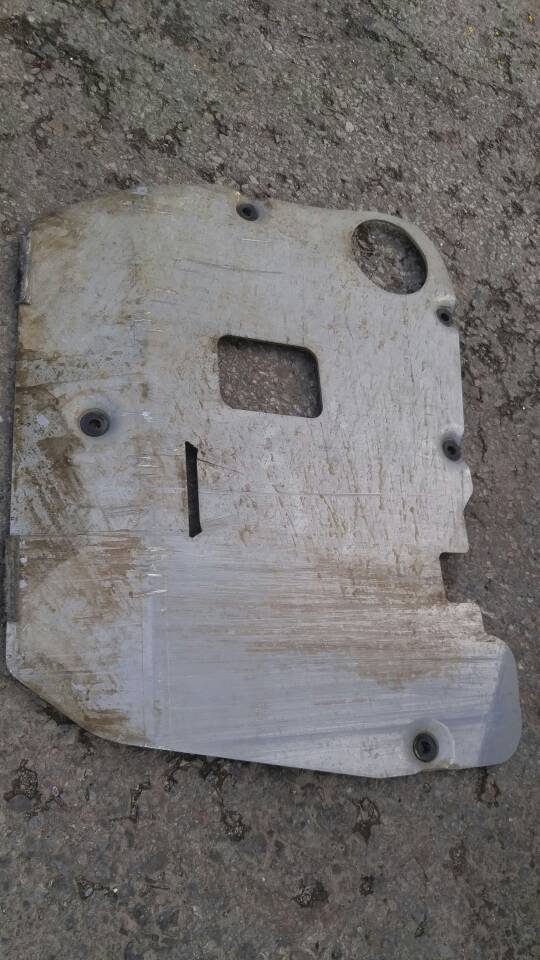

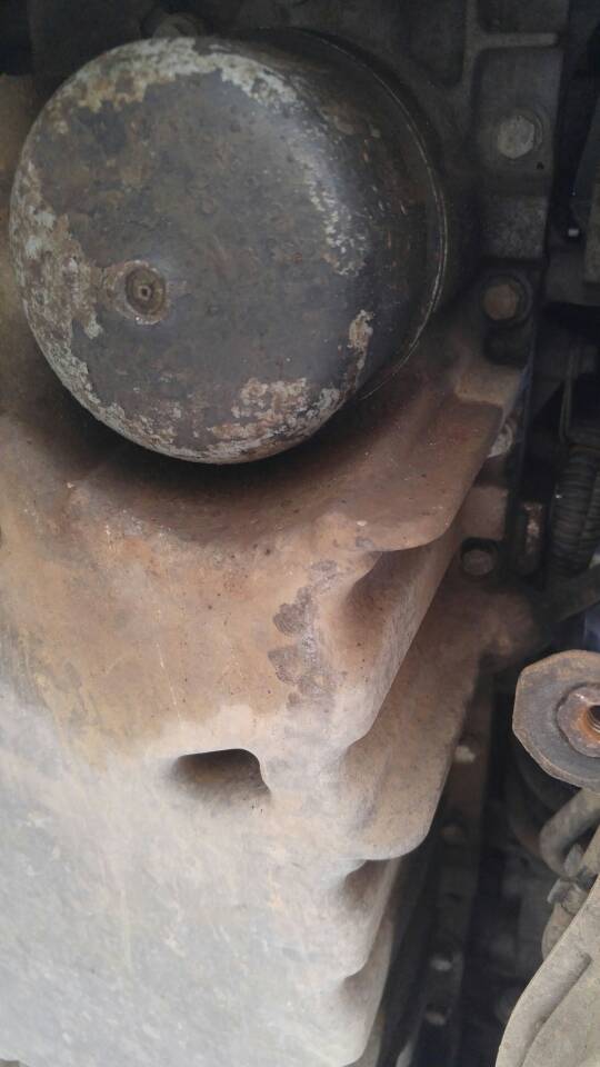

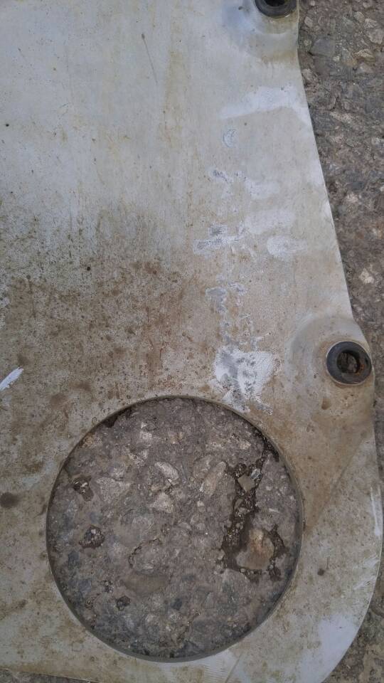

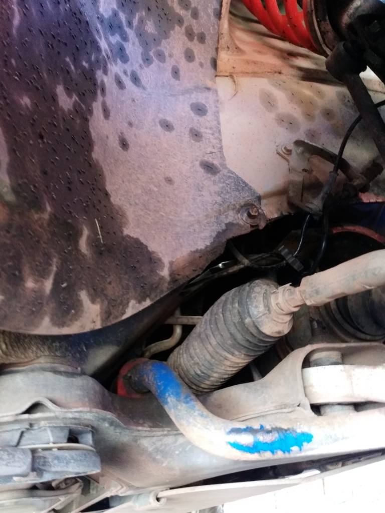

Got under the XC today to check out a few things. Had a rattle that was coming from a loose brake line, retrieved a 13mm I lost months ago, and noticed a bit of oil collecting on the skid plate that looks like it's the turbo oil drain leaking...again [emoji1], just going to ignore that for now. Also noticed that the engine and transmission has been making some contact with the skid plate.
There's no contact when it's on the ground, must be from hard use such as puddle jumping. Just bent down the tabs a bit and reinstalled the plate.

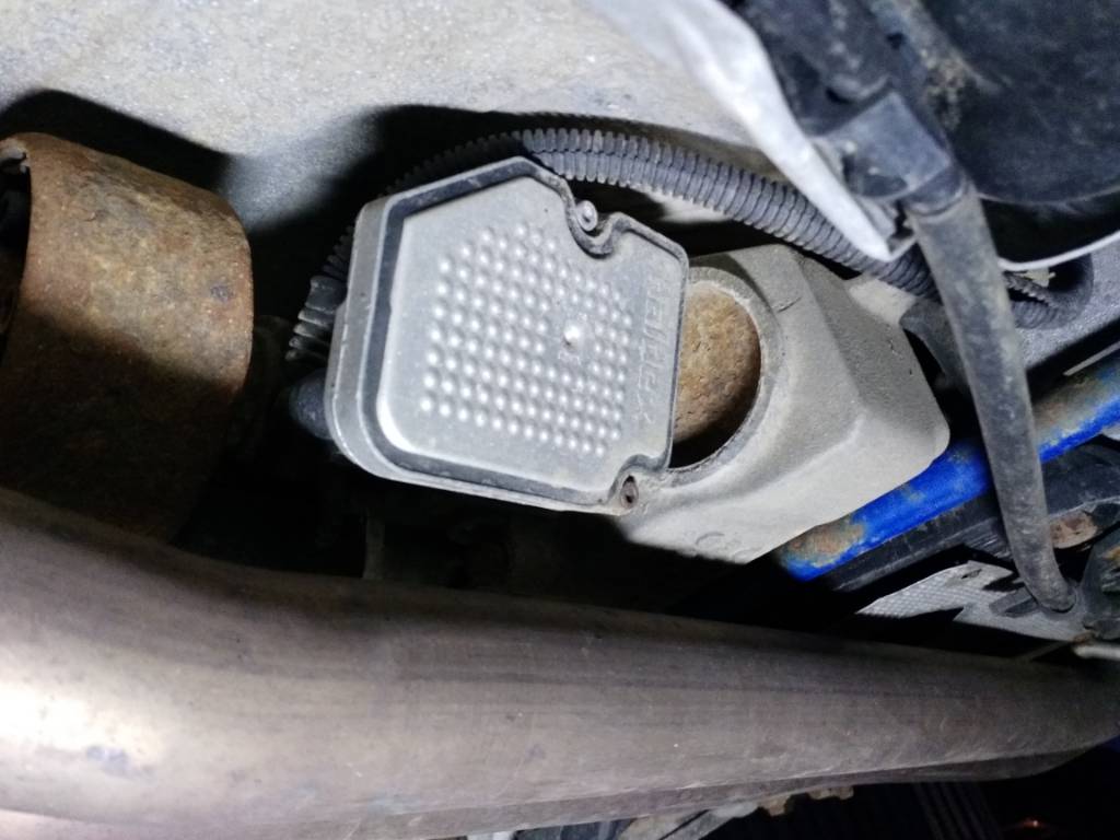

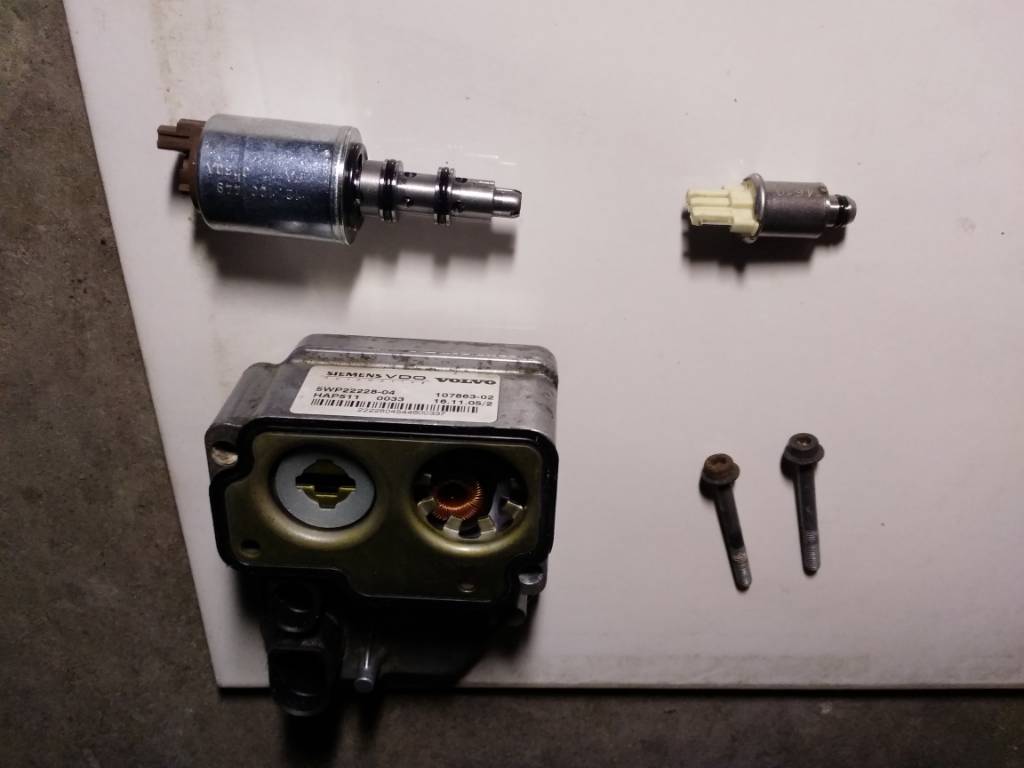

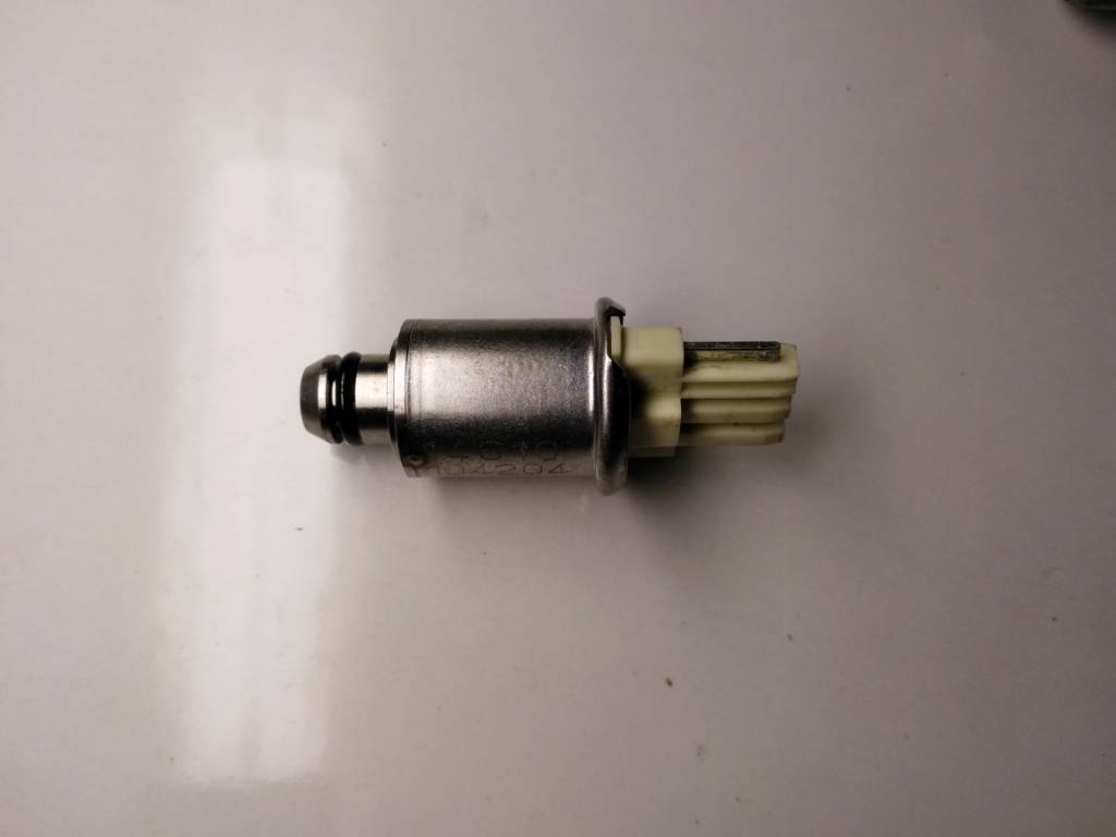

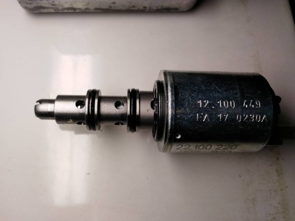

Small, but worthwhile upgrade to the AWD. Volvo uses a Haldex Coupling that is electronically controlled by a DEM (Differential Electronic Module). There are quite a few versions of the coupling, but for the 2003 to 2005 Haldex Generation 2 is installed in the XC70. Haldex Generation 3 labeled 'instant traction' from Volvo came out on other models, primarily the XC90. I won't go much further into it but I'll provide a link below on how this upgrade works.
I purchased and installed a DEM, sensor, and valve from a 08 XC90 V8 to install on my 05 XC70 with the Gen 2 haldex to gain instant traction and the XC90 V8 AWD torque split of the Gen 3 Haldex.
https://r.tapatalk.com/shareLink?url=http://forums.swedespeed.com/showthread.php?t=558890&share_tid=558890&share_fid=17438&share_type=t
XC90 DEM Module and components
The swap is super easy, if you're quick enough you will lose minimal oil and will not need the top it up.
While at Long Point I got the test it out on some sand and I have to say that I'm quite happy with its function. The vehicle does feel more like an all-wheel-drive and less like a front-wheel drive. It feels more predictable and the rear end wants to come out [emoji16]. Some slow-mo videos posted below.

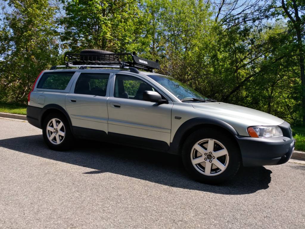

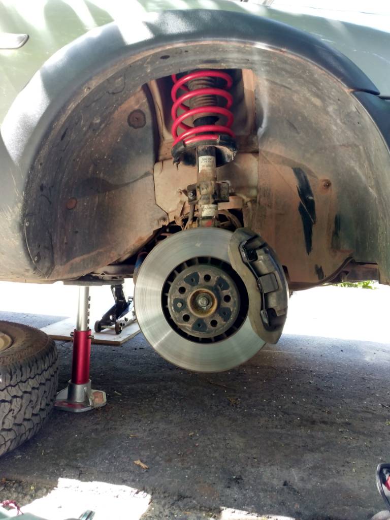

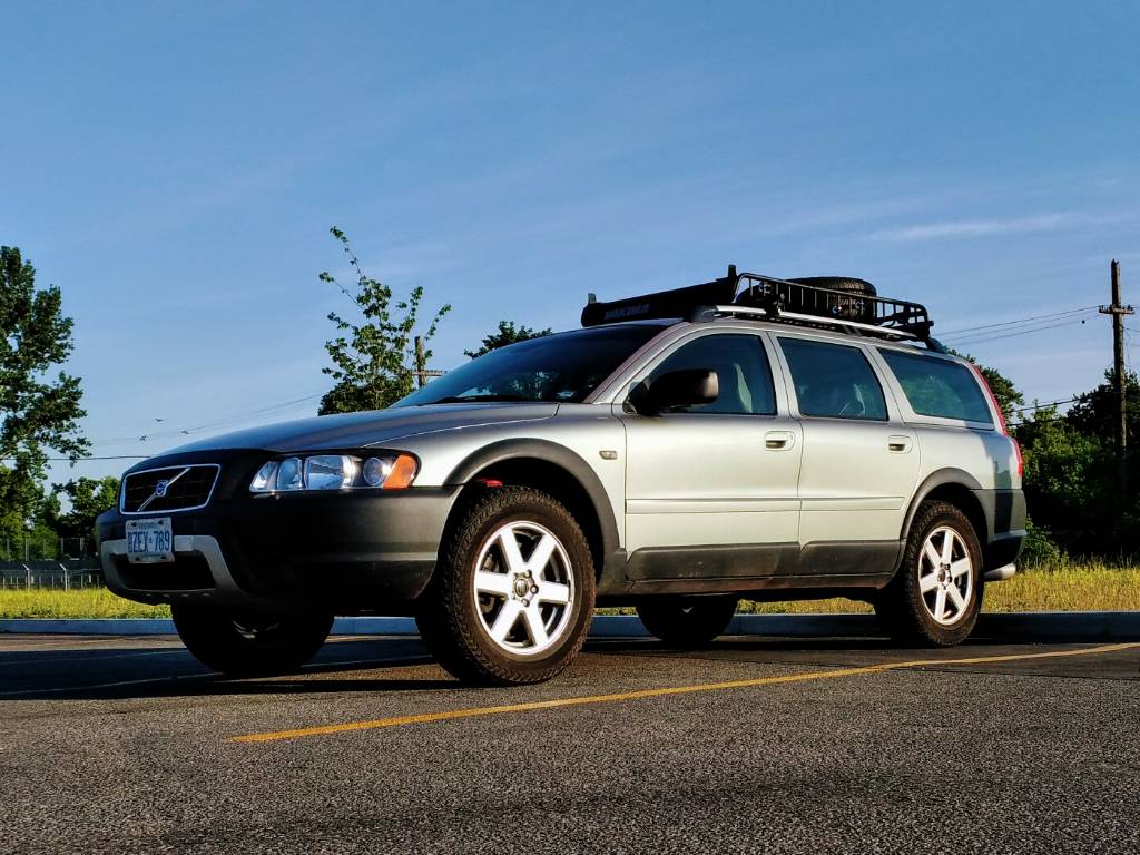

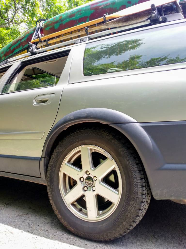

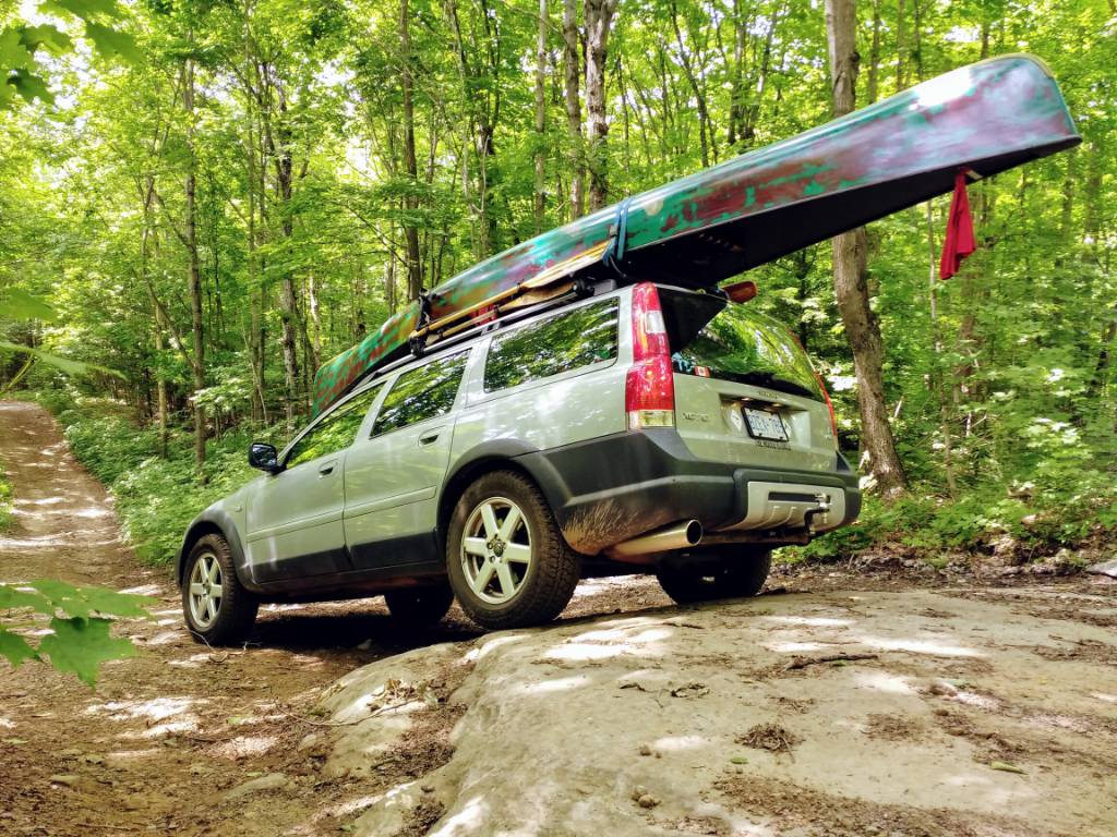

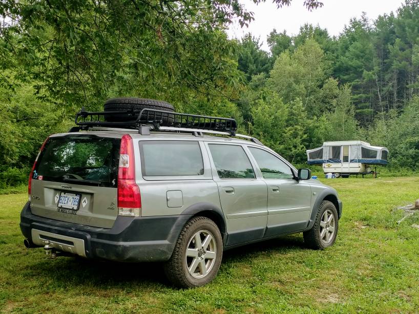

Had some time today to install the XC70 Lift Springs, the install went quite smoothly without any surprises. Took me 5h including a lunch break along with my 4yo helping fetch parts and 'inspecting' the install [emoji23]. Quite happy with everything so far. Only drove it up to 40mph and it feels ok, definitely more roll but nothing too crazy. Was worried about the rear camber being neutral or positive, but even with the lift there's still a slight negative camber which I'm happy with. There's a bit more rubbing up front now when turning full lock, will look into that more later.
...of course the first adventure was to the grocery store [emoji23]. It's only a Volvo. [emoji8]
I expect it to settle a bit over the next few days/weeks. Not running out to get an alignment right away as it feels ok. The springs are also quite a bit stiffer which should help when loading down, had a fun time compressing then. The original springs are 14.5mm, the lift springs are 15mm. Not a large difference.
Sent from my ZTE B2017G using Tapatalk
Reactions: dolli310
Antherzoll
816
Canada
Alright, so took it on it's first real trip today, Canoe, Kayak, BBQ, 3 adults, 2 kids, dog, and gear. Gotta say I'm quite happy with the lift springs. Sure there is a bit more body roll when unloaded, but they handle being loaded down much better. With the roof loads and pack the vehicle doesn't squat as much, actually feel better on road, and will handle drop offs and bumps with less rebound. Although I've been on the fence for years as I felt the stock suspension was enough, so far I'm very happy to have these on my XC. It actually makes the vehicle look more stock as the XC90 wheels and tires no longer stuff the wheel wells.... Maybe time for bigger tires? [emoji23]

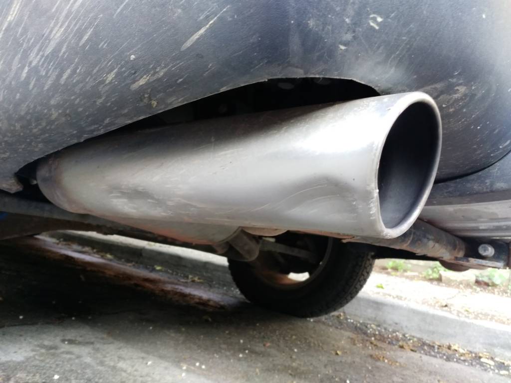

Weekend adventures in the Haliburton Highlands...

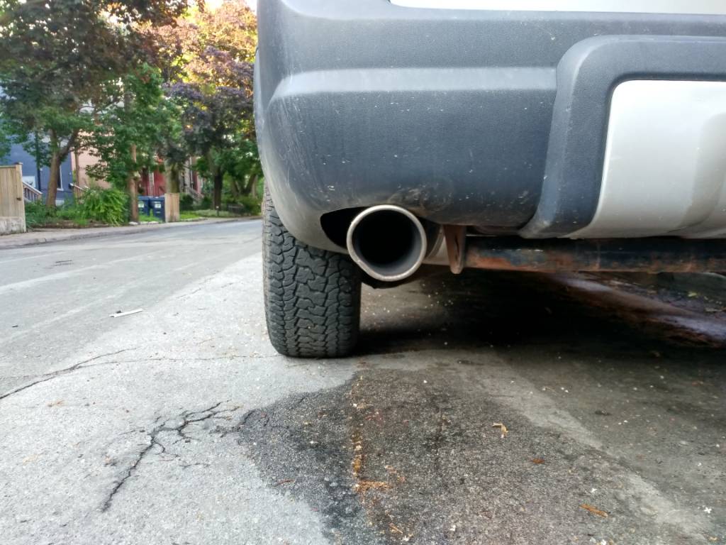

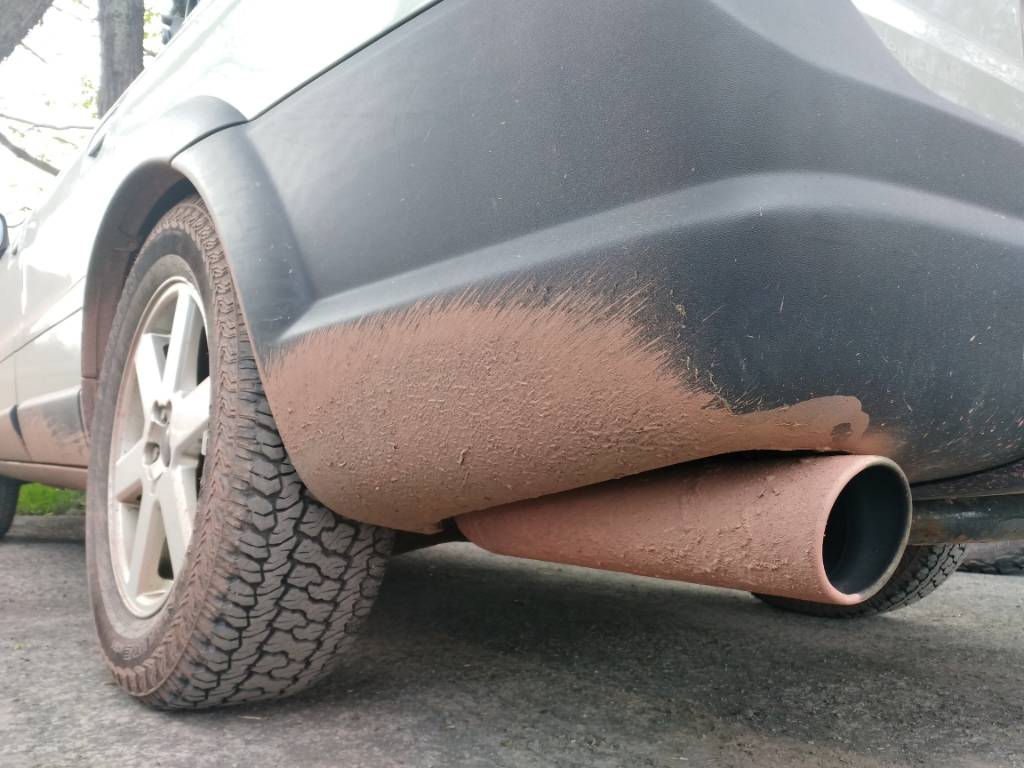

Bent and banged up the the exhaust pipe on a river crossing [emoji22]
Not too bothered by it. Will get a pipe expander to get it back to round.

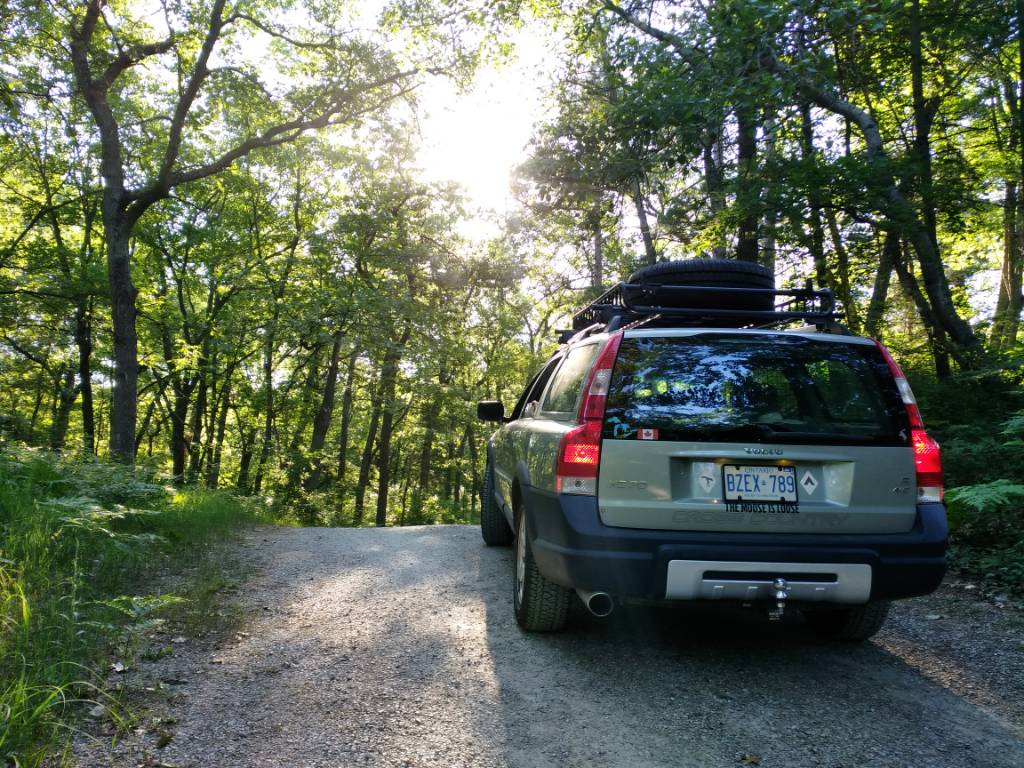

Tire rubbing on the sway bar at full lock. Passenger's side CV is throwing some grease, but the joint feels ok... I have a spare Volvo axle I may swap in.

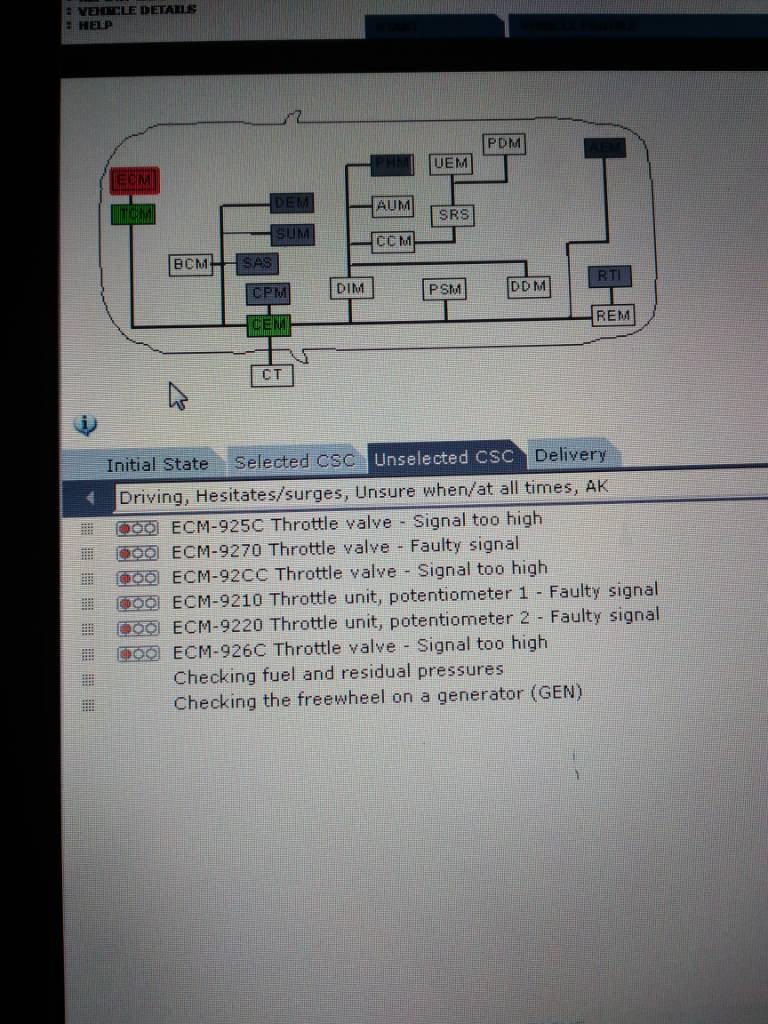

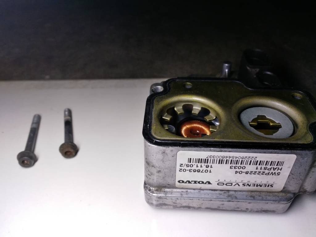

So from here we headed home, again another 10h30m travel day turned into quite the adventure when at hour 14 the XC broke down in Toronto.
So the throttle body caused the engine to just die. I had a spare at home which I swapped out today and all is well. Opened up the and there's water and corrosion on the contact. Thankfully this happens close to home and not in the bush, but I suppose that the unit could have been cleaned and dried to get it working again in a pinch.
