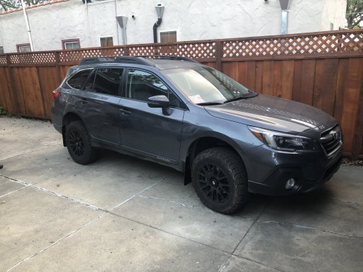

Question for you Terry (and the rest of the Outback owners out there):
I have a 2018 3.6R with a 2' AFD lift, RalliTek springs, Motegi wheels and KO2 tires. I am not at all happy with the way it handles bumps at speed. The car is wallowy and seems to react to rough roads with huge overcompensation. Not sure what to try next to solve the issue. Change out the struts? Swap the springs to stiffer King springs?
My GF doesn't like to drive the car now witch is very disappointing after the money I've already dropped into it.
Any suggestions? View attachment 118826

This overcompression, do you have a load in the car or is it empty? Even the ralli trek springs are sprung heavier than stock. That might lead to the harsh (hard) compression. Add some weight and see. Heavier duty struts might help to smooth it out. Mine is very stiff when unloaded but with the RTT and camping gear makes it ride great.

Sounds like your shocks can't handle the load and/or are worn out. Generally speaking you want the softest spring possible to achieve the lift you want then have the shock/strut tuned to control movement. So going to a heavier spring may not be the best solution.
Second this. I've had both setups. Unloaded it drives like a truck. Loaded up it feels like a caddy.
This is what I would have said @ca_rage. Stock struts are fine and higher spring rate Kings are definitely not the answer since you're not carrying enough weight to work the springs now.
Another contributing factor is how old are the springs? The unsettled feeling is undoubtedly from the rear since the weight of the engine up front is sufficient to maintain a near stock ride with Rallitek springs. The rear is a different story so unless you've loaded the car up and really worked them they're most likely not even settled in yet. Remove the rear sway bar, load it up heavy, and take it off road.

Thanks for all the feedback everyone.
The car has less than 10k miles on it and the springs even less.
Maybe I just need a break in period.
I'll throw a couple hundred pounds in the back and see what that does.
I’ll tell you what it’s going to do... its going to ride like a dream haha. The whole point of springs is to carry the weight of the vehicle. The higher spring rate of your RalliTEK springs is intended to support additional weight every single day. They will absolutely ’soften’ a little as they settle in but you will still want to carry additional weight daily to retain a stockish ride. This is all part of the reason why I try to dissuade people from installing springs until they know they need them.
If you want to help them settle in and soften the ride at the same time take the 10 minutes to remove the rear sway bar. The increased spring rate should make it basically impossible to tell it’s gone in the corners. Not to mention the front sway bar is doing the great majority of the work on this understeering long roof anyway.
I also anecdotally confirm what @Wawa Skittletits said about running swaybar-less in the rear. The spring rate is plenty stiff enough for it to not be noticable. You can test it out by just unbolting the endlinks and temporarily zip tie the sway bar in place.
Also, the king springs were noticably stiffer than the rallitek, so your ride won't really improve.

Ok I'm confused. He said his car is wallowing and feels like it's overcompensating. That implies the suspension is very soft and bouncing in an uncontrolled manner when he hits bumps. Overly stiff springs with not enough load on them don't do that, they just make the ride harsh.
Verbiage aside, this is a common issue on Subaru’s with aftermarket springs installed. Without enough weight the rear isn’t compressing so it essentially hops around over bumps.
Makes sense. Our trucks do the same thing without a load in the bed. 50lb Sand bags really help. :)
