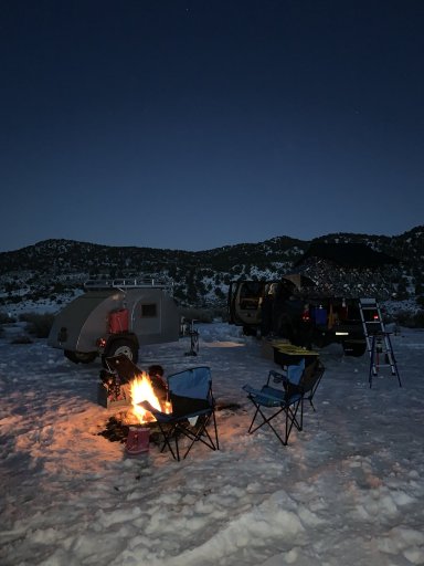

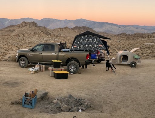

I had the pleasure to take a couple of trips by myself, and then met a beautiful woman who is intelligent, interesting, and interested (which I find equally important), and who also happens to love the outdoors. She had never been on a motorcycle before we met, but that didn't last very long (our second date was a motorcycle ride out to the coast to watch the sun set). A couple months later and we took a weekend long trip from the San Francisco Bay Area, out to Tahoe, up to the Mt. Lassen area, back out to the west side of the state, and (almost) made it back home without any issues (a flat tire a few hours from home found us on the side of the highway waiting for a ride from family.)

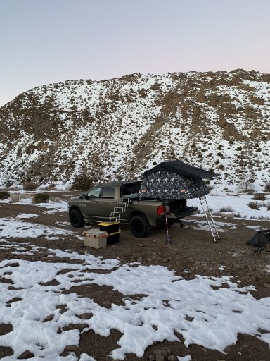

Fast forward a little while and we find ourselves living together and adopting a dog from a couple very good friends who were moving and couldn't take the dog with them (there was never any question where the dog would go if they weren't able to keep him, and it had been discussed long before the situation ever arose.) Well, it's a bit harder to add a 95lb black lab to an already full adventure motorcycle, so it was decided we should get a roof top tent for her Subaru, and I could build a rack for my Ram 2500 that could also carry it.
We took a couple of trips with the tent on my truck and it worked out great (so great we have never used the tent on the Subaru.) A few months later and what happens? We get another dog. Extended motorcycle trips are pretty much out of the questions now (but we can still get away for a good long ride now and then), and with the addition of the 2nd dog, a 45lb husky, we find the truck is packed to the gills with everything we want/need even for a long weekend. We were able to do a 2 week road trip up the eastern side of CA, OR, and WA, over into MT, down through ID, UT and NV (just clipped the corner AZ too), and back over to the family ranch outside of Bakersfield, CA. On this trip, we were cramped, to say the least, and even the dogs were having to share the back seat with supplies/personal items.
(This is a challenge photo - Find the deployed RTT)
