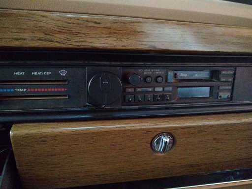

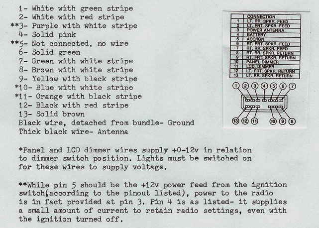

I've been working hard on getting the audio setup up to par so I can enjoy driving the Wagoneer more. The previous owner had originally replaced the 5 1/4" round speakers up front with 4x6 speakers -- my guess because he had them sitting around. I replaced those speakers with RetroSound R-525N speakers from Crutchfield. I also replaced the back speakers. When I put the Wagoneer in as my car, they sent free harness adapters, which worked great in the back, but the original harness had been taken out in the front.
I also added an FM modulator to behind the radio so I could keep the original head unit to keep an original look. It works well, but I'm waiting on some splice wire terminals to arrive for me to rewire it in a nice way -- I'll get some pictures when I do that. I've installed a 3.5mm audio jack under the dash, and I'm using a basic Bluetooth kit for wireless calling/audio, but you can unplug it and plug in any 3.5mm audio jack to play audio.
For my phone, I've tried two different sticky suction cup mounted holders that keep falling off the dash, no matter what I do. So, I'm looking to go back to my trusted RAM mount system. I'm planning to find a mount I can put on the dash face and bolt into the dash frame somehow so It's really solid. I have some measuring to do.
For power, I've ordered a flush USB charger to sit in the ashtray. I wanted flush, so when I unplugged stuff, I could close the ash tray. I want to find a flush USB cord for changing my phone at least, and I'm hardwiring the bluetooth into power, so it doesn't take up my precious slots.
Testing the audio, it sounds awesome, and I can't wait to take it out on the road for some testing, after all this shelter-in-place is lifted.

I've made some more (minor) changes to the bluetooth setup! First: I hardwired a USB power adapter into the Radio's power to run the bluetooth to get rid of the wiring in the front, and free up the other USB port for my passengers. But, of course, I wired the FM Modulator and Bluetooth power to run off of the BATTERY wire on the radio, and not the ACC/IGN (Ignition) wire, so the Wagoneer died. I was planning to put an onboard battery charger in this thing at some point, and this makes me want to get one sooner.
I changed the wiring around so the bluetooth and modulator run off the ignition wire, tested working now, and the battery shouldn't die as quick anymore.

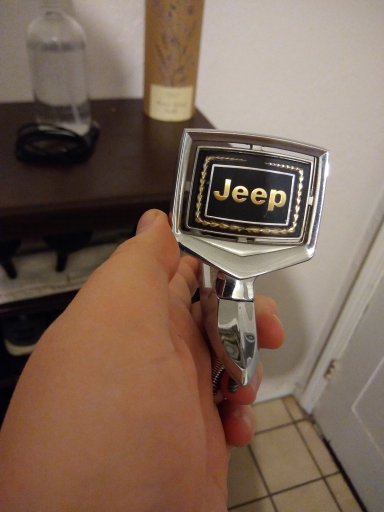

Update! I've gotten a new job, and have one week between jobs that I'm terming Wagoneer Week. I've got a load of work to complete during that week including:
- Install sound deadening insulation in the cargo area.
- Install new switch in the tailgate for the key switch to open the tailgate window.
- Complete tint removal, and final window cleanup.
- Reshape or replace chromed metal strips that go on the floor and tailgate.
- Try to diagnose long crank times when cold starting after the truck has been sitting for a while.
- Confirm my current suction cup phone mount will work on the glove box door in the heat, and over time, or else get a new RAM mount and mounting location.
- Repair or replace the Jeep Hood Emblem

Alrighty then! I've slowed down on working on the truck a bit, as I've waited for more stuff to arrive. I've ordered: cab lights, LEDs, and ABS backing panels for the carpet in the cargo area.
I've completed the install of the tailgate restoration kit, new channels and gaskets all around, but it seems I've tweaked the tailgate a bit, and the passenger side is sticking hard. Very difficult to open now, and I need to figure out why that is.
I've also got a gold leaf hood emblem. Not sure which models of Grand Wagoneer it is supposed to come on, but it'll look nice, and got some gasket material to get a nice seal between the emblem and the hood, even though there was no gasket originally.
