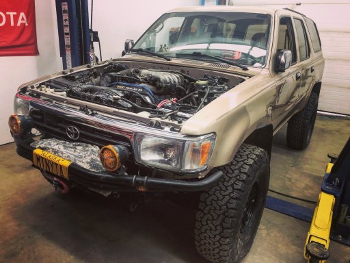

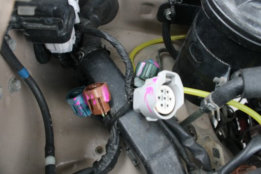

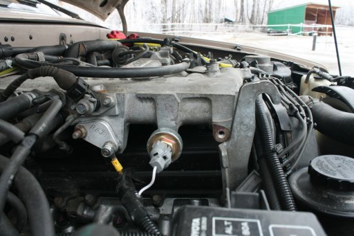

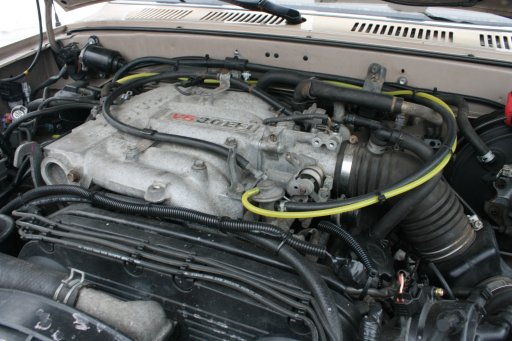

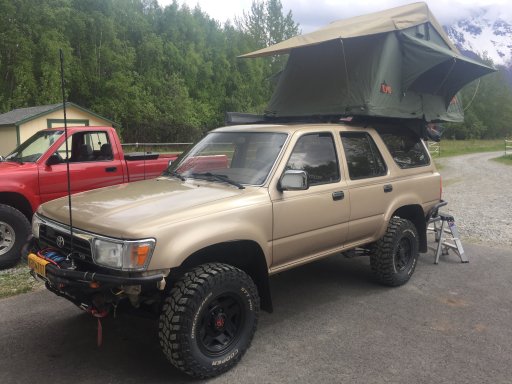

Finally got around to getting some engine bay pictures, you can see how much room the egr and cruise delete netted me on the passenger side of the block, easier to change plugs there than the other side! Also seen is the knock sensor bypass, tapped into the intake manifold and grounded on the lce block off plate.

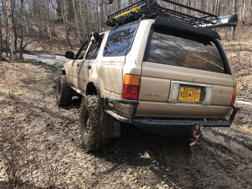

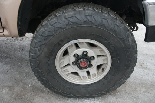

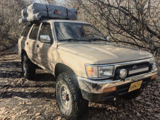

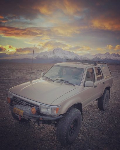

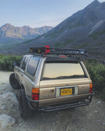

Went back to my sr5 rims to match all the chrome on the truck (not a fan), and I have to say I love the way that the 33's look on these rims vs. the steel offset. It solved a minor rub under compression issue I was having, as well as stiffened up the ride a touch as well. Plus I was able to use my OEM hub-caps, which is one of my favorite parts of the truck following the OEM layout.

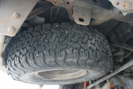

Also pulled the trigger on a fifth 33x10.5 spare on matching rim, just for peace of mind. I know I had talked about moving down to 31's, but after getting everything tuned in and netting a conservative 17 mpg mixed driving I think I can deal with the loss of power. They are great tires for us up here in Alaska, and should put up with the mild wheeling I do when aired down as well as great long distance performance for road trips.

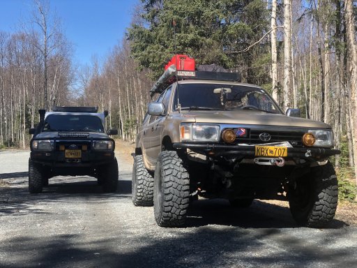

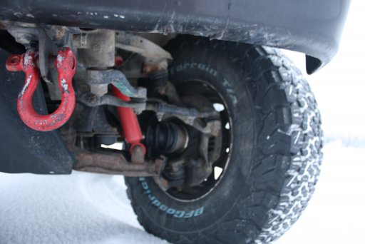

I do have an issue with the rear shocks, I mounted the new mounts too high up on the axle, and even with the 1.5 coil spacer, there are a few frost heaves that I bottom out the shocks on my daily commute. I am considering getting into a set of OME 901 HD coils (2+ lift) to give me some more rise and resistance against the shocks bottoming out.
Does anyone have any experience running these coils? How about with a spacer? What shocks are you running?
Another option would be sourcing some shorter shocks, but I like the idea of having some more beef out back to handle summer gear for camping and offroading.
Thanks in advance.

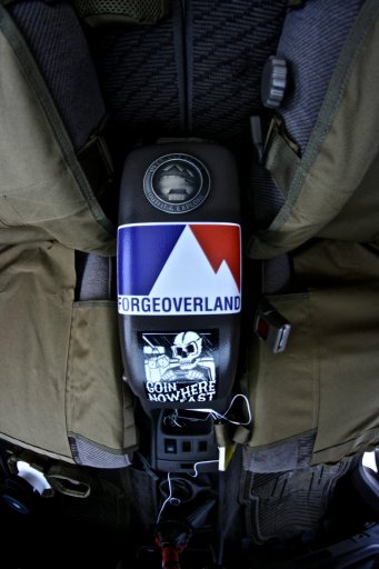

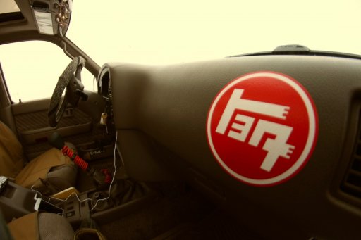

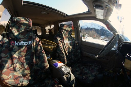

Also a few interior shots.
The 4wd shift had to be trimmed to work with the marlin short shift. The kit was initially for a 151f I had that got sold with the prior truck, but I decided to keep the kit for the 150 on the runner. Had to modify the transfer case shifter to keep from interference from the gear shift, as well as use the stock shift bushing which was in decent shape. With the marlin bushing, I couldn't get the case piece to push down and turn to lock the shifter into place.

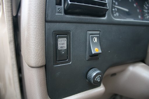

Also a shot of the OEM Toyota fog switch in place in the dash punchout, almost a perfect fit, with just a minute edge not falling into place, hardly noticeable.
