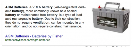

Yes, if an AGM battery, it does not need venting like an older styled with vent caps. Here is just one source about that:
