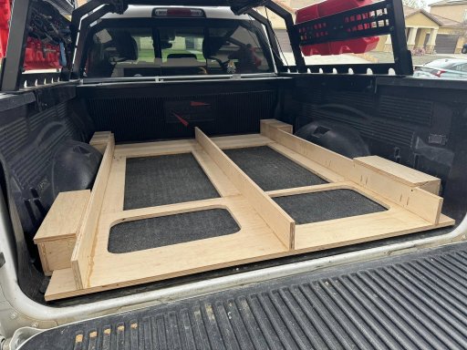

So I decided to just go the direction of wood. The 8020 is nice but the cost-to-weight ratio is really not that much to justify the amount of money for it IMO.
Here are some progress photos.
Used Burch 3/4 Inch Ply.
Ordered 60" and 36" vevor drawer slides:
Still need to order the Sink:
Going with Recessed Pulls:
Contemplating using bed carpet for the sides of the cabinet instead of the matt black stain/protectant. In case things move around and hit it.
