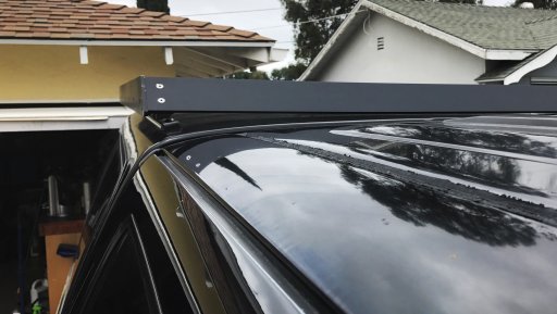

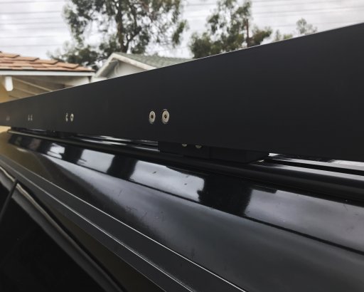

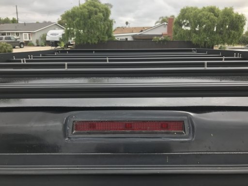

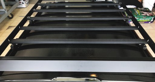

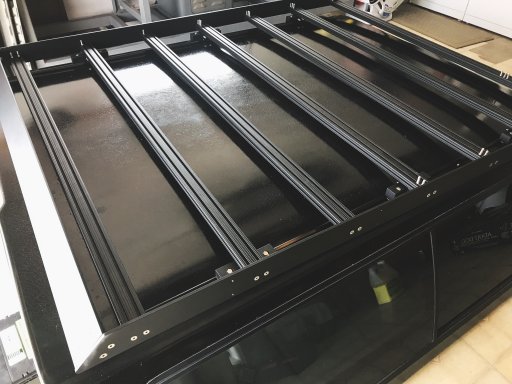

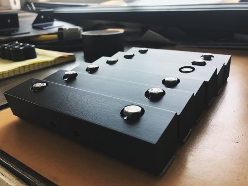

Thanks for the kind words. Here are some quick photos of the roof rack all bolted up. Ill have some better ones soon with it on the truck and some more close up pics.
The rack is made out of all 6061 and the 80/20 extrusion. It weighs just under 50 lbs without the hardware. So add a few pounds maybe for all the stainless. It sits about 3/4 of an inch above the shell so it had a super low profile which I'm trying to keep since the truck is 7 ft tall.

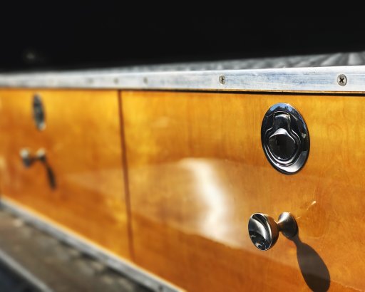

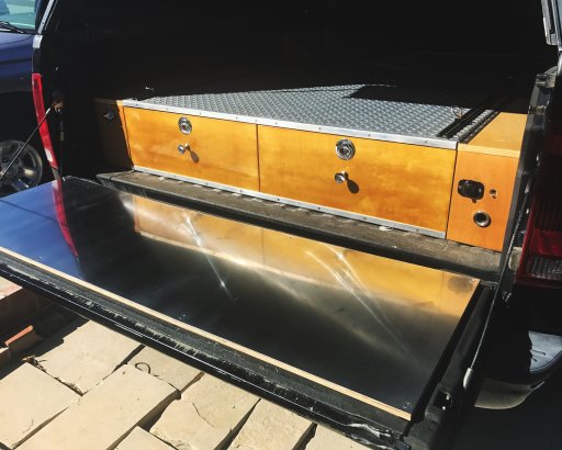

The old latches for the drawers were breaking on me so I switched over to some Southco latches which are amazing.IMG_3182.jpg IMG_3173.jpg
Also added a piece of 1/2 inch plywood and some 18 gauge stainless to the tailgate to use as a cook surface.

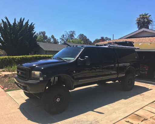

Finished product.

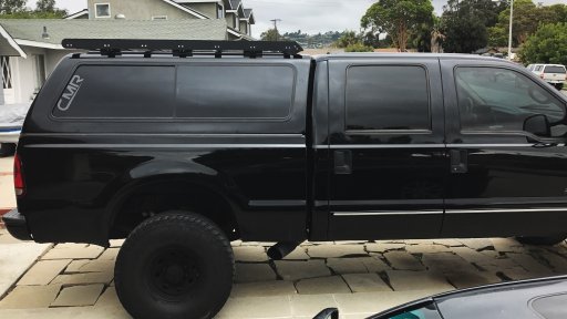

Added a 8ft ARB awning to the side of the rack and 2 Husky boxes from home depot on top, $50 - $60 depending on when you buy them. These worked out really well. The boxes do have a rubber seal on them so they are weatherproof, we went through some hard rain in them and no water leaked in. Affordable compared to other alternatives.

What are you currently running for tire size? Is the picture above 35s or 37s?
We have used the husky boxes for a long time and they have held up great! Perfect for keeping everything organized and makes for a quick get out of town for camping.
Teh_Viking
2,616
Ventura Ca
Roosendahl
2805
They are a 36.5 x 13.50, I think you were running the same tire at one point the falken wildpeak, when I got them I needed something that would get some decent tire wear. what I didn't know is that at about %50 tread they would look like slick, I see why they released a new version.
Right now they measure about 35 inches worn down and mounted on the truck. I dont plan on changing gears because its nice to cruise on freeway at 70 and still get great mileage. Im hoping to change rims to a 17 from a 16 and get either the 35X12.50 or 37x13.50 Toyo MT
