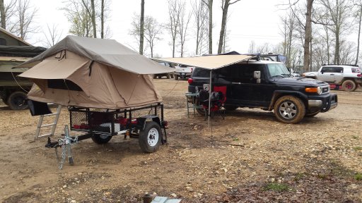

I did an axle over, put 13" tires and rims, front wheel jack, 2 rear leveler jacks, and bearing buddies. It's been on 2 road trips so far...about 1800 miles total. It tows like a dream (75mph highway easy) and with my FJ, I don't really see any loss in gas mileage. I can load a cooler, 3 Rubbermaid Action Packers, camp chairs, and a 20lb. propane bottle. Best part is I only have about $750 total in the thing. I do plan to order a new longer front tongue about 1 1/2 to 2' longer, just to make it easier to back up and tow in rough stuff.

That's a perfect setup and I like it. Looks like a small project is in the works. Is that the Lowe's trailer? If not, make and model? Thanks!

It is the Lowes trailer. Be aware they put them on sale about every 2 to 3 months...saves about $50.
