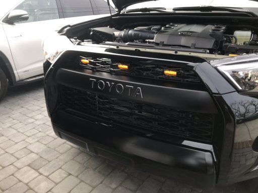

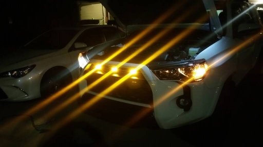

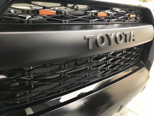

Very nice!!!! Yea, they look great with the black. Mine showed up today, can't wait to stick them in. How long did it take you? (Thx for the pics)
Maybe 20 minutes. Super easy. It took more time cleaning up all the fasteners.
It won’t take you long.

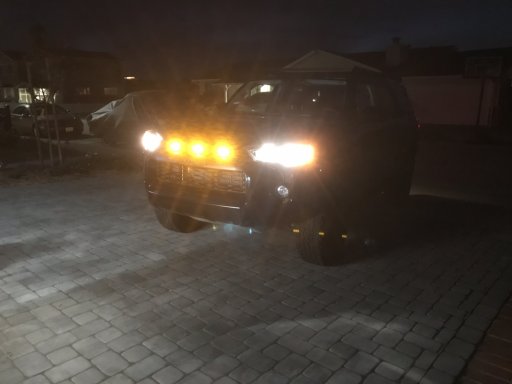

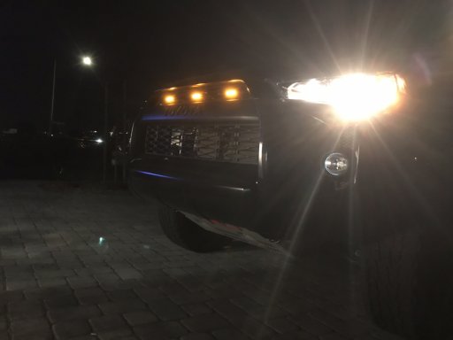

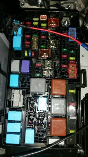

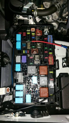

Ok, big problem here. I hooked up the lights and I'm having issues. If I have it plugged in either my left headlight does not work or the ambers don't work. Plus, my f'ing check engine light is now on permanently. Any ideas???? I'm so hot right now I can't think straight.20190224_193701.jpeg20190224_193715.jpeg20190224_193735.jpeg

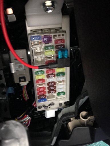

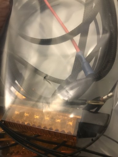

Are you using the fuse location in the engine bay?
Yes, engine bay fuse box. I did get my engine light to go out after disconnecting the battery (thank God). Left headlight still will noylt come on when Yota lights are plugged in.
Jeepinit
2,271
San Mateo, CA, USA
Rob
Bright
16060
Use the one on the driver side in the vehicle. Need. More pics?? Or I’ll send you my number in a private message
