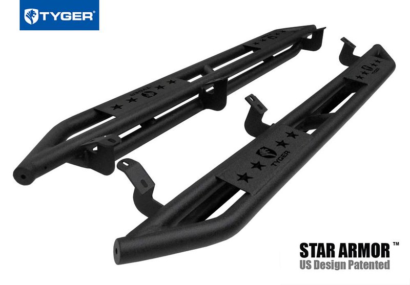

I placed an order for some running boards. Not a huge fan of them in the past. I've not ventured down the path of the true rock rails as this is my daily driver, and I just don't see banging my truck over giant rocks or bolder fields. Don't get me wrong, the truck sees it's share of backcountry travel, I've just set a limit as to what "abuse" I'm willing to subject it to. That being said I had a recent discussion with a family member who added a set of beefy running boards and within a week he struck a rock while doing some basic off road driving. The running boards saved the side of his truck from certain damage with no sign of denting or issues to the running boards. And add to that, we seem to have been venturing out with passengers of various ages who see getting into the truck a "challenge" to say the least.
I'm well aware of the advantages of getting something that bolts directly to the frame, and there are some great options out there, but for my application I think this is the best option - for now.
I've seen the Tyger Auto ones in person, read a variety of reviews, and I've watched various Youtube videos of them being installed. Everyone seemed to rave about them. I've had them in my Amazon cart about 10 times, but never seemed to do the order. At about $280, I finally figured they were worth taking the chance.
F96539 by cobblecrazy, on Flickr
The only other ones I have considered is the N-Fab RKR rails with removable steps, but I liked the larger "step" area of the Tyger Auto ones. I saw one installation video where the RKR had an additional fixed flair out/step just in front of the wheel well (they call it a bed step), but I couldn't find it as an option on some of the places where you could order the system.
