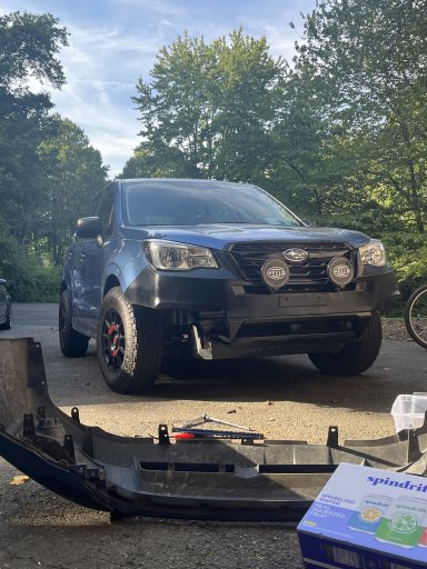

Not exactly. That was 6 years ago and I haven't had the Forester for 2 years now. Roughly though, the unistrut was around 24" long (I think it was 1-5/8" strut). And the arms that supported the lights were probably 8"-10" long.

How's it going @Slippery Chuck ? Finally committing to trimming the bumper, I noticed that you swapped your washer fluid reservoir for a bottle and removed the air resonator on the other side. just curious what was done with both of those things --> how did you do the swap and what did you do with the air resonator.

I love the look of round lights over LED bars. I mounted a pair of Hella 500's to the bumper with a piece of Unistrut and then cantilevered some plates through the grill. Here's a CAD model of the assembly:
View attachment 69249 View attachment 69250

Another problem I was beginning to have was scraping the front bumper. To Increase the approach angle I bought a cheap bumper cover (to spare my stock painted bumper) and chopped it up prerunner style.
View attachment 69253 View attachment 69254
View attachment 69255 View attachment 69256
Psuss! For the resonator, I bought a cheap plastic electrical box cover from a hardware store and glued it on with liquid nail. For the nalgene, I think it was an adjustable hose clamp tight around the bottle with a pipe hanger/strap up to the battery tie down rod. The strap was about 1" wide with holes drilled thru it at roughly 2" spacing. It came as a rolled up spool.
I'm seeing all kinds of stuff all over forums about taking off the resonator hurting engine torque? did notice anything?
Also for the washer bottle: I'm more curious how you made that reservoir work. I think I have 2 of those pumps on mine. Did you just drill a hole in the bottom and attach that pump and that was all it took?
I can't say I noticed any power changes after capping off the resonator. I had my pump on the side of the bottle. Bottom would probably work too. The second pump is for your rear window but I decided not to bother using it. I bet you could get both on there or use two bottles if there's room under the hood.
I drilled a hole in the bottle slightly smaller then the pump grommet then enlarged it with a Dremel sanding cone until the grommet fit inside snugly.
