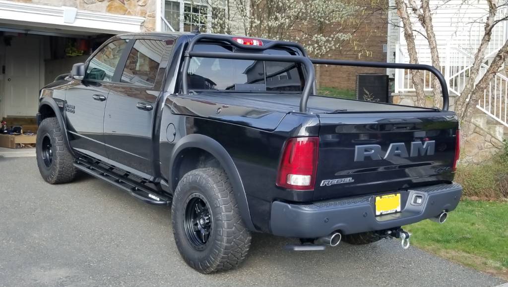

Dethloff Mfg Expedition Rack - Dethloff was kind enough to revise their existing Rambox-compatible rack design to fit short bed Rams. I've been working with him to get all the required dimensions, angles and specs for quite a while, and at long last the rack arrived a couple days ago. (A few days too late for the AOAA trip, but oh well). It bolts into existing holes hidden underneath the bed rail end caps - except it's recommended to drill one hole on each side at the front corners...the HDs have holes here already, but 1500s don't.
Once mounted, the rack is rock solid. And the curved bars are a nice match with the flowing lines of the truck...I really like the looks of it. It comes with two straight cross-bars (not mounted in the pic) that can be positioned anywhere along the length of the rack with roll bar-style clamps. There are optional riser bars for use when carrying long items that would stick out over the cab. Thule and Yakima rack accessories will all easily mount to the 2" cross bars.

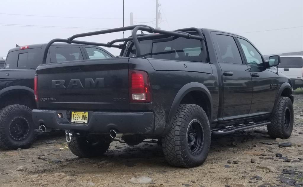

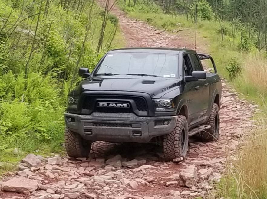

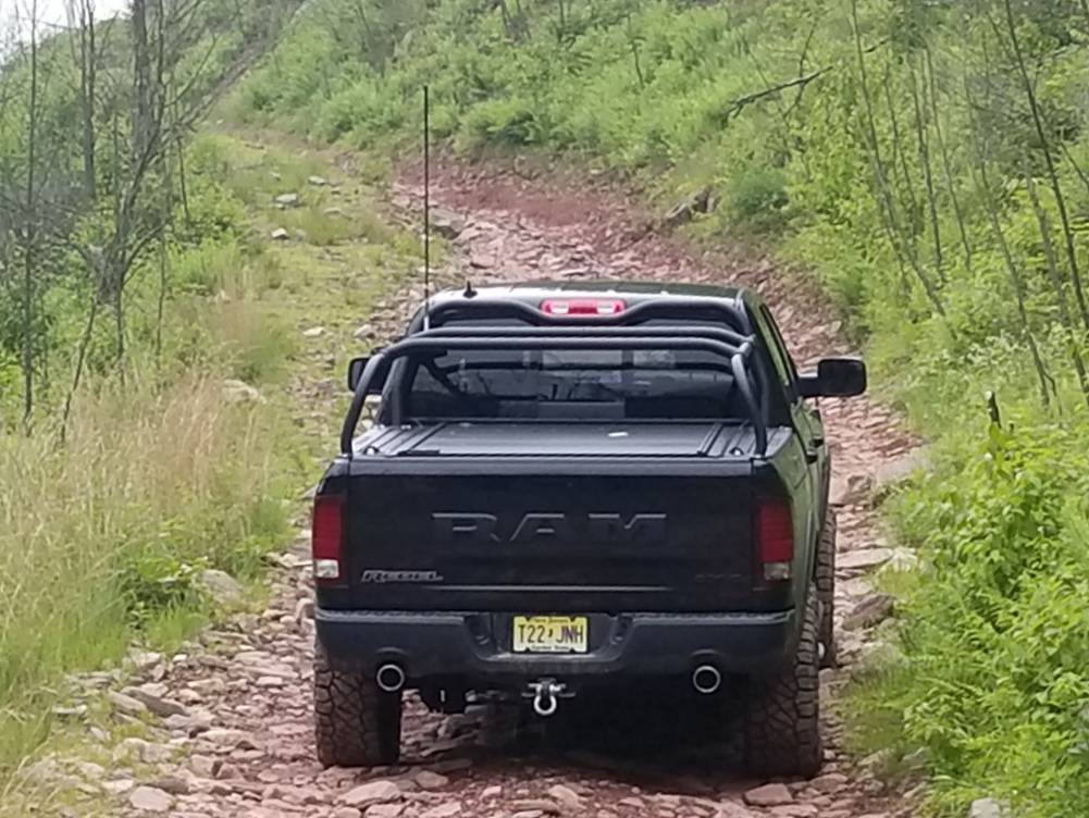

Here are a few pics from Rausch Creek this summer that show the rack with the cross bars. I didn't get any good video on this trip like at AOAA in the Spring, but once again, I was really impressed at what the truck could tackle. For a full size, it's quite nimble at slithering through the trees and around tight switchbacks, and the LSD in lieu of a rear locker doesn't hold it back in the slightest. If I weren't averse to continuing to get pin striping, I wouldn't hesitate to attempt all manner of tight trails.

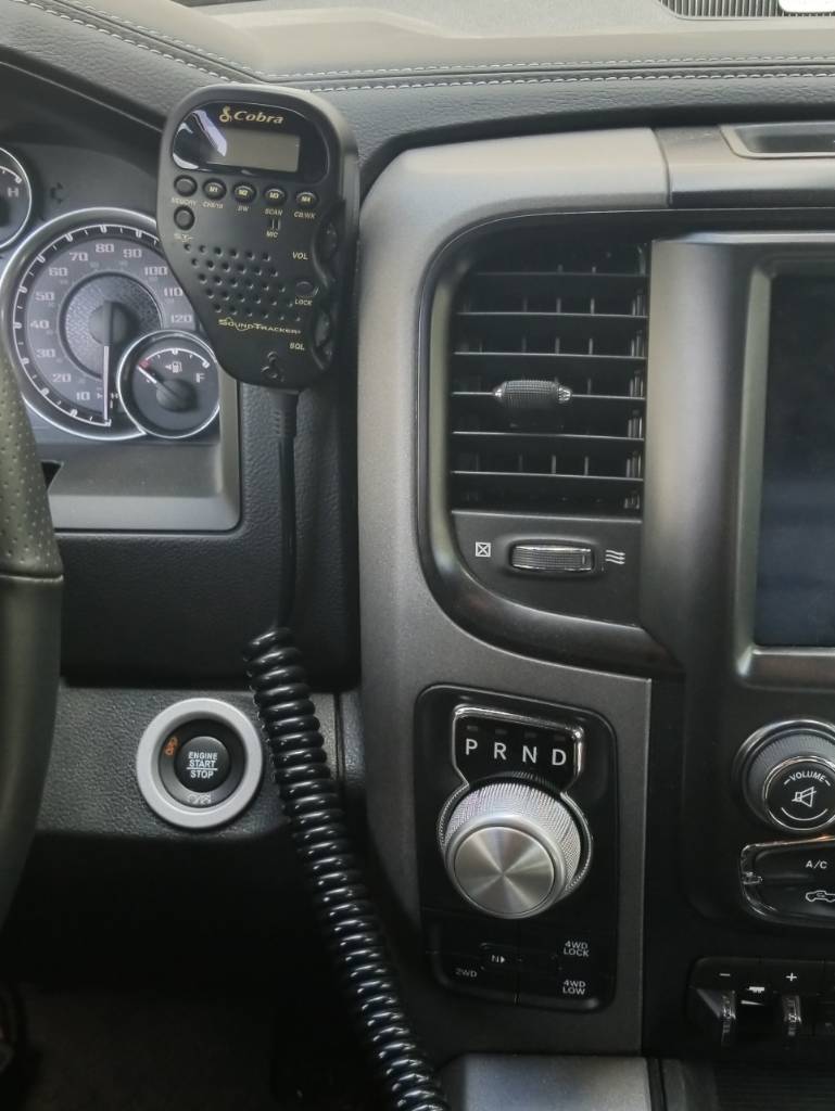

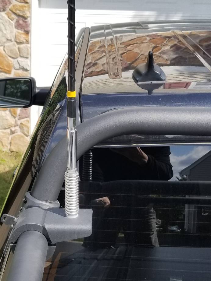

Once I got the rack installed, I set up a Cobra 75 CB in the cab, and a 4' Firestik non-ground plane antenna connected to the rack via a quick-release spring mount. The Cobra 75 has a tiny box that easily tucks up behind the dash, and all the controls are on the mic, which sits on a hanger that slips right between a gap in the dash panels. I primarily use the CB to communicate while on the trails or caravanning with other vehicles, but it's also entertaining to listen in on truckers while rolling down the highway... (plus I've just always felt like a pickup should have one : )

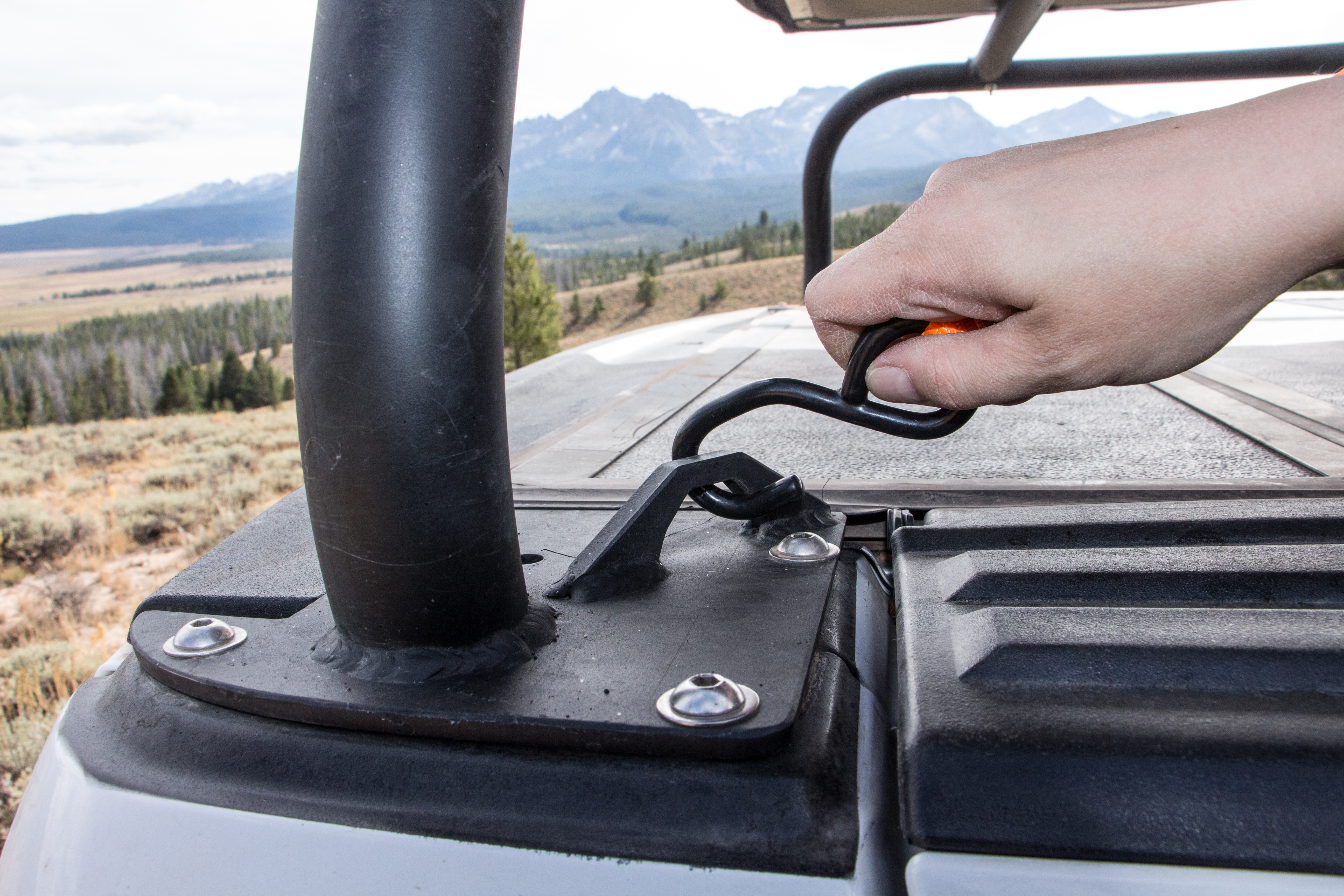

Really nice bed rack, I wouldn’t mind seeing some pics of how it is attached to the bed???? If and when you get some time.
Thanks - it's made by Dethloff Mfg. It bolts directly to existing holes in top of the bed rails and bulkhead; the design concept is to accommodate opening/closing the Rambox compartments (nearly all other designs are not compatible with Ramboxes).
Here's a couple of pics of the mounting feet from Dethloff's website...
