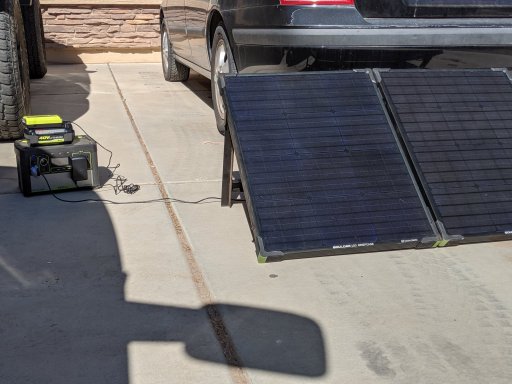

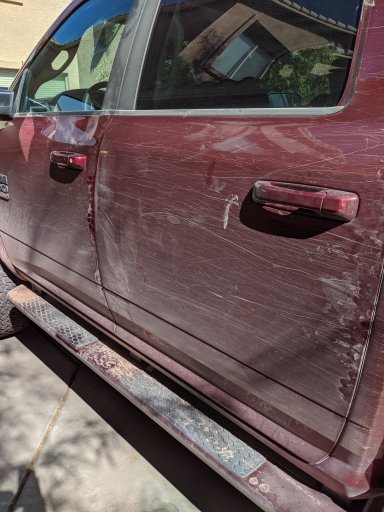

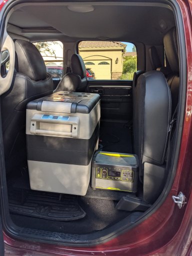

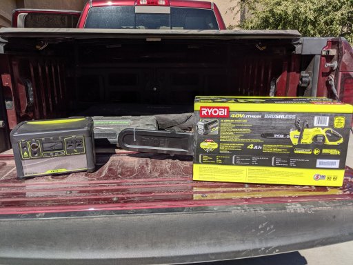

Ok, so I had to get a few things that I did not plan on buying. I was on some trails yesterday and they were overgrown and scratched the hell out of my truck, so to prevent this I picked up a ryobi electric chain saw. I also ordered some AEV splash guards because some how rocks chipped the crap out of my driver side window. A couple months ago I was looking at buying a yeti cooler but ended up getting a 55 quart Alpicool freezer on amazon for 280 bucks. After getting the cooler I realized I needed something to run it at night so I got a yeti 400 and the 100 watt solar panels.

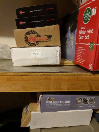

4.30 gears will go in later next week along with the AEV diff cover.

Ouch. Heavy correcting cream and an orbital are needed now.

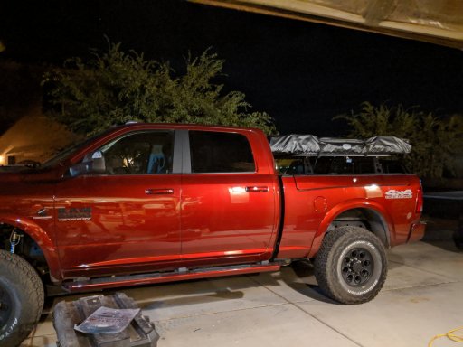

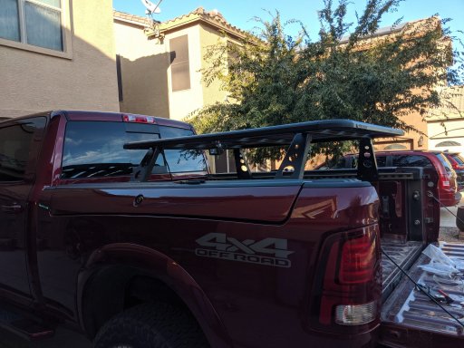

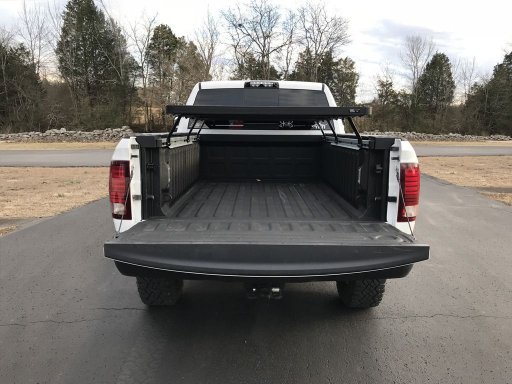

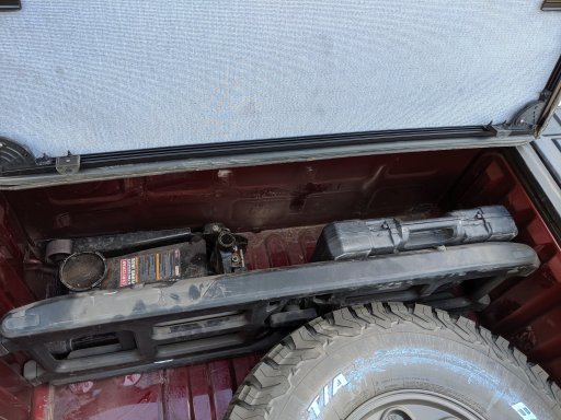

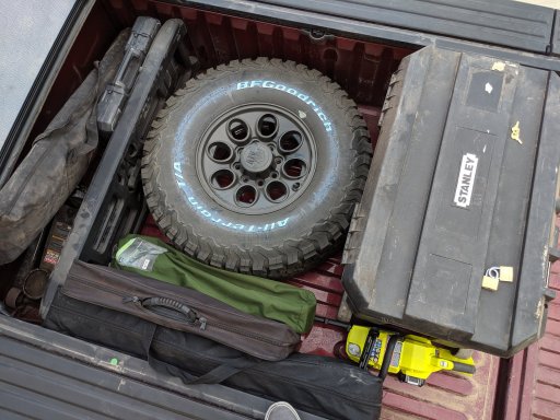

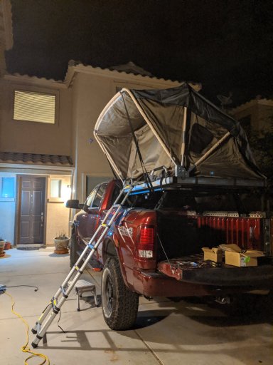

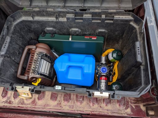

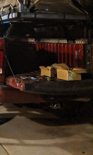

I have been busy the last few days getting the truck ready for a camping trip this weekend. But it's mostly done now. Gears and diff covers will get put in later due to this trip. The dealership let me down and ordered the wrong bedside rails, so I went to home depot and got some C-channel so I can get this truck done in time. I got the Rhino rack on and the tent all set up and it fits SO GOOD! The biggest problem I have with this truck is that very little is out there for trucks with the Ram box option. I needed something that would not only fit but would allow the ram boxes to still open. What I found was a Rhino Rack tower and platform setup from rackoutfiters.com. The kit is actually for a Toyota Tacoma because of the Platform size but you can get the towers with any platform you desire. Under the Rack is a set of KC scene lights that I will wire up in the morning, and the Rigid D2s will also go in tomorrow. AEV splash guards should show up tomorrow and that will basically wrap up this build for now. I did get some new gear and test I fit everything in the bed. 5 gallon Fuel can and a box of DEF will go up next to the jack behind the ram gate (if you run out of DEF you are limited to 5 MPH until you fill it up).

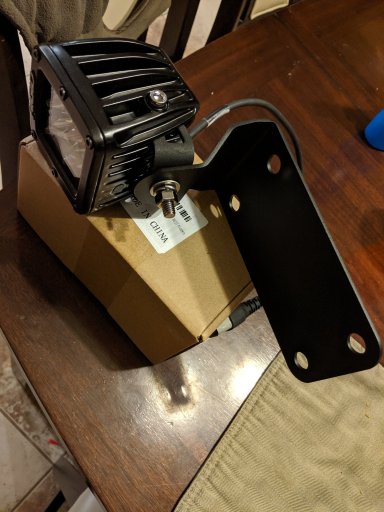

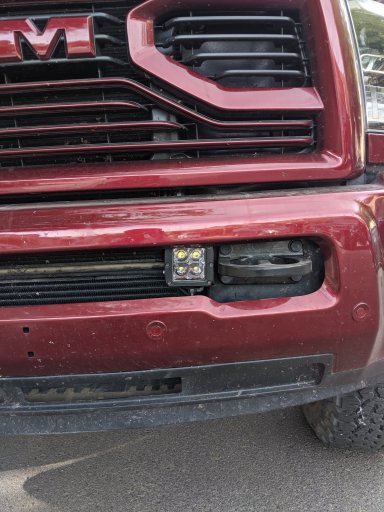

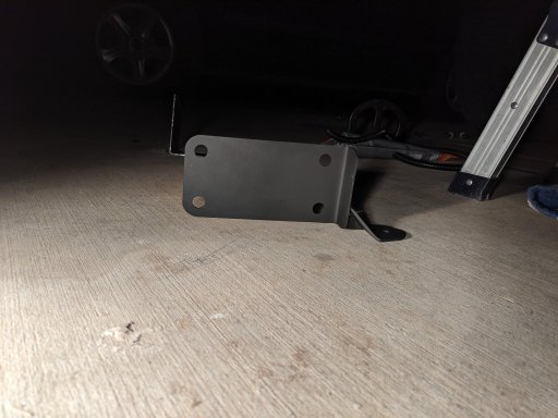

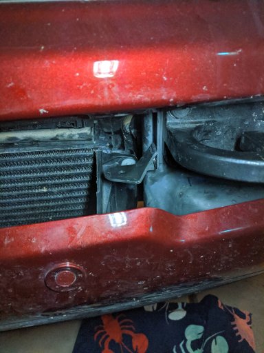

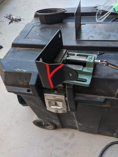

I got around to finally putting in the rigid lights. I really wanted to mount them in the front bumper but couldn't find anyone that makes brackets for anything other than a light bar that would block all the air to the intercooler. I found some brackets on amazon that I thought might work for only 27 bucks. They didn't work so I did some very quick and basically minor cuts and welding to make it work. I cut the bracket along the vertical line in the picture shown below, put it flush on the floor and welded it together. Then I cut the tab at an angle to allow access to the hardware on the side of the D2 light and allowed the light to rotate more for adjustability. I also added a small triangle brace on the bottom. As far as wiring goes it was super easy thanks to the factory AUX switches. I just ran the ground to the battery and the power wire to the number 2 AUX switch.

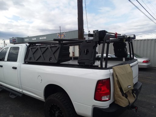

So what I used was the rhino rack 10 inch bed towers and a rhino rack pioneer platform. Front runner sells basically the same setup now. Since the dealer ordered the wrong rails for my truck I went to home depot and got some uni-strut cut them to size and bolted them to the bed. The uni strut is the same thing as the factory rails but steel and not as pretty. The uni-strut cost me 40 bucks, the factory Mopar rails are just over 400. The four towers are not connected to each other in anyway until you get the platform on top and bolt the platform to the individual towers.
Front Runner rack: Dodge Ram w/ RamBox (2009-Current) Slimline II 6'4" Bed Rack Kit - by Front Runner
The picture shows the Front Runner rack with factory Mopar (non tonneau cover) rails.

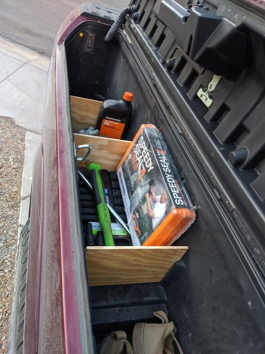

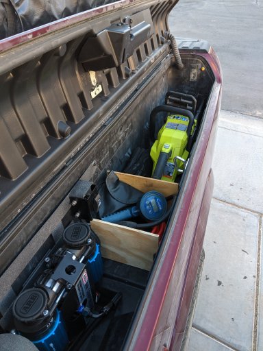

I found some extra wood so I made some dividers for the Ram boxes. The Ram boxes are infinitely more useful when you put dividers in them. I also added a pic of the truck in its bone stock form just over 30 days ago when I picked it up. I got it with 200 miles, now it has 4200, I drive the crap out of it haha.
