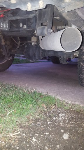

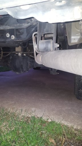

I just cut the exhaust off before the shackle. It was starting to heat up the bushing but I plan to have a turn down tip added but in winter it's not hot enough to do any harm so I've put it off. My buddy has the same shackles with a turn down pipe and it works great. You get increased clearance behind the rear tire too.I had seen in another post you were talking about having lift shacles on your canyon. I have 2-3" lift shackles on my colorado duramax and have noticed the exhaust tip rubbing the shackle and heating up the rubber bushing on the leaf spring. Do you have this issue? Or are your shackles short enough to clear?
Im about to swap to blocks and build traction bars for mine to eleminate axle hop was going to do the traction bars anyway since i still had hop with shackles.

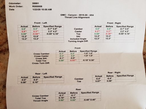

Nice! I'm surprised you were able to move the front wheel much, but agree it's almost always easier to make room up front than fight the hard-stop in the back of the wheel well (firewall, door, etc.).I finally got an alignment! It's been 3+ months since I installed the aftermarket UCAs but I've been working on getting my front suspension set where I want it so no sense in wasting money on an alignment until that was done.
Looking at the before numbers the UCAs added quite a bit of caster and toe but I was still having trouble rubbing the rear of the wheel well after adding the 1.00" wheel spacers. The tech at Less Schwab was great and he let me go into the work area to discuss my desired outcome. We ended up pushing the wheel as far forward as possible. It's easier to make room in the front of the well than the rear.
During my alignment last summer before the UCAs we set caster at 2.9 and 3.1.
Me too considering my UCAs are not adjustable.Nice! I'm surprised you were able to move the front wheel much, but agree it's almost always easier to make room up front than fight the hard-stop in the back of the wheel well (firewall, door, etc.).
