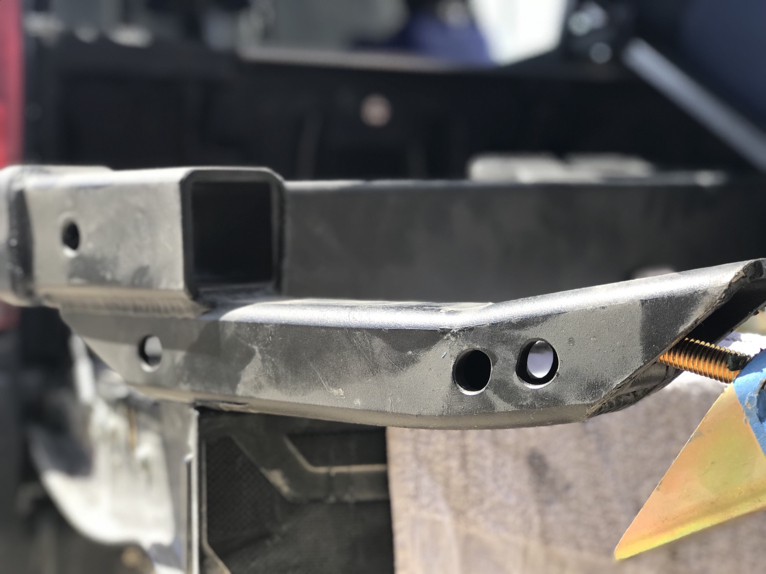

Well, I can report after exactly one trip out, the 2” insert bent after one good bump and left the rear tire mounted on it bending!!!
I had my Turtleback attached to it, and it bent about 20 degrees.
I was forced to put my spare on the roof, disassembled the swing arm unit and stow it in the shell for the rest of the trip. To be continued after speaking with Wilco Offroad
Any update from
Any update from Wilco on the tire carrier issue?
I met with Paul from Wilco and we talked about the failure point. It was actually the second drilled hole (which actually is the standard securing lock ) hole which caused the failure. They’re building me a new one as we speak calling it “research & development “
