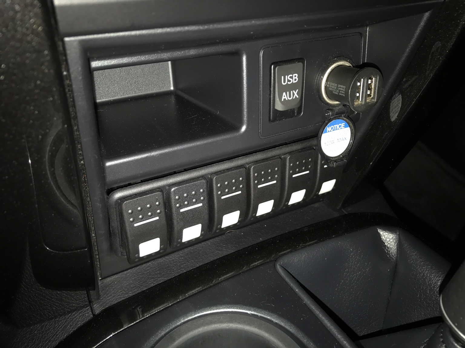

3M has lots of different tapes. Not sure what you used. Looking at the rolls on the hook in the garage, I've used 38582 and 03609 in various applications. Both are super strong, have no problems with vibration, and weather the elements well. These are usually available at better autoparts stores (I usually get it at my local NAPA) one is for attaching automotive moldings and I don't remember the recommended application for the other. Either should hold the switch in place for years to come.
I'd like to see pics of the interior install when you get the time.

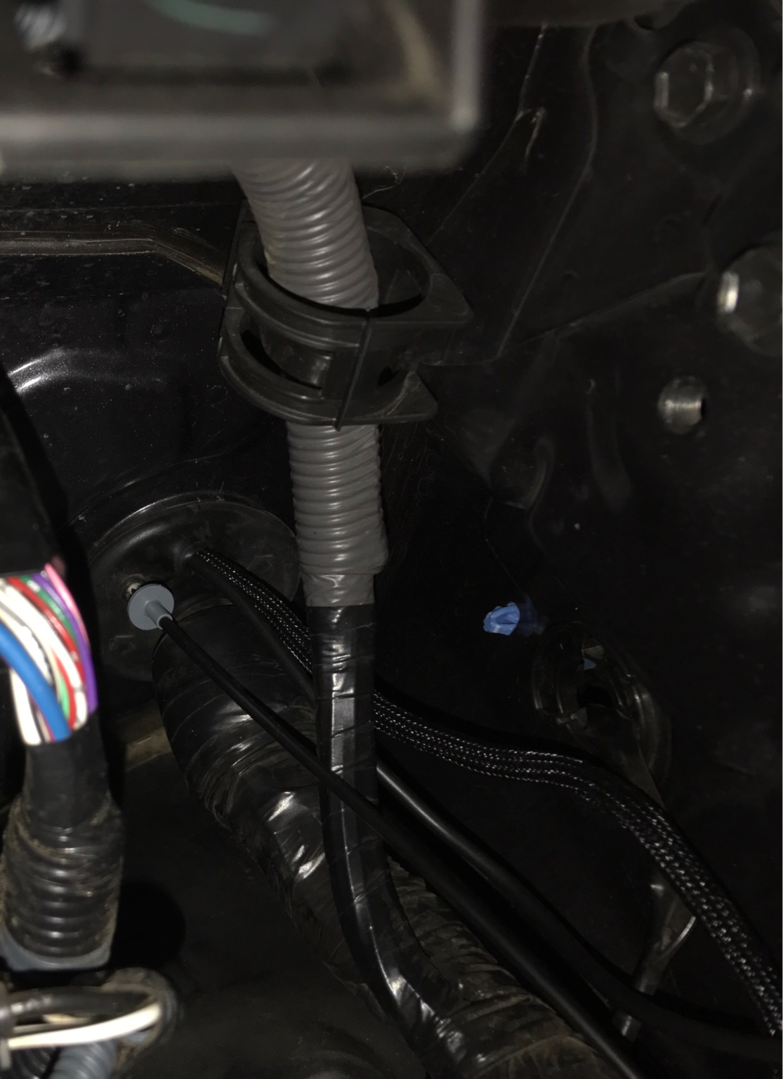

Thanks for the pics. I know that grommet well have a similar one on my Tacoma that I needed to punch through to wire in my trailer brake controller.
I'd agree. The gap is not that bad in the pic and from a normal angle probably not even noticeable. You might be able to sand or file the existing bezel edges down to fit better. If that does not work you can always pick up the other bezel you linked to.

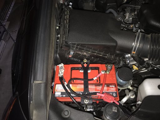

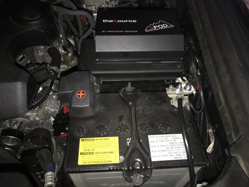

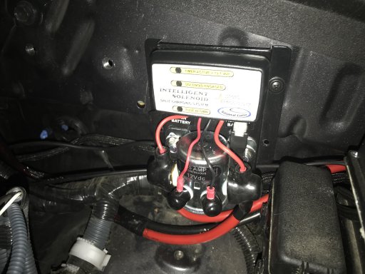

View attachment 46894 View attachment 46895 View attachment 46896 View attachment 46897 Finished the dual battery install.. Very satisfied with the National Luna kit + Shrockworks dual battery kit both from a quality perspective and ease of installation. Not sure I’ll leave the battery controller where it is but for now it’s staying in the center console (there’s an audible alarm so I can here it sound it something isn’t right).
