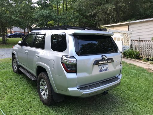

Installed the H.I.D. Kit Pros leds for the interior. Went with pure white as no one needs the dingy yellow or the blueish hue of the brighter lights. I installed them during the day and couldn’t tell the difference until I had to drive at night. It makes seeing much better.

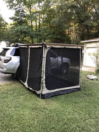

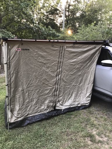

Now I have to get darker tent so people can’t see inside!

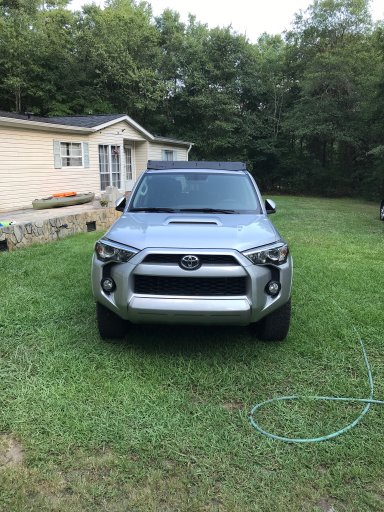

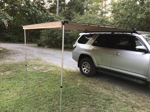

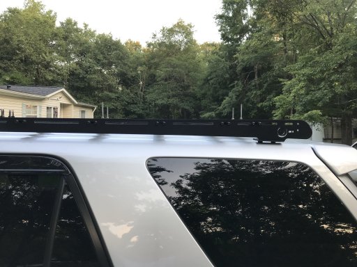

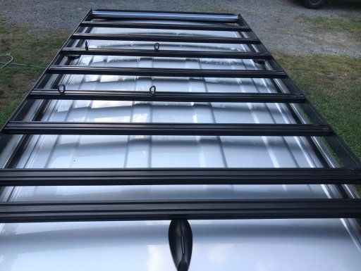

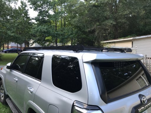

Overall the install was easy. Had to buy a 1/4 20 tap for the crossbars as some were not that clean of a cut. There was no 3m sticky tape for the no drill kit. Looks great though.

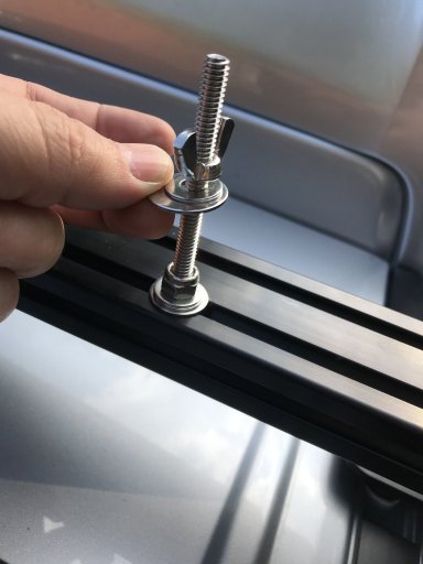

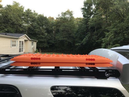

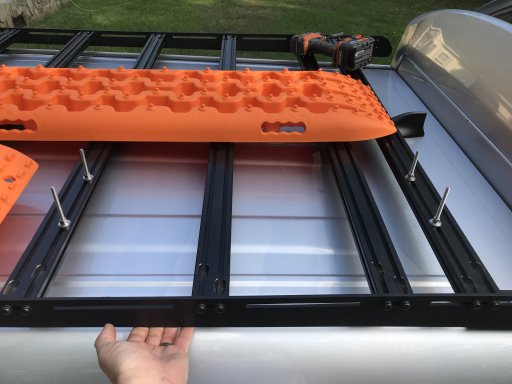

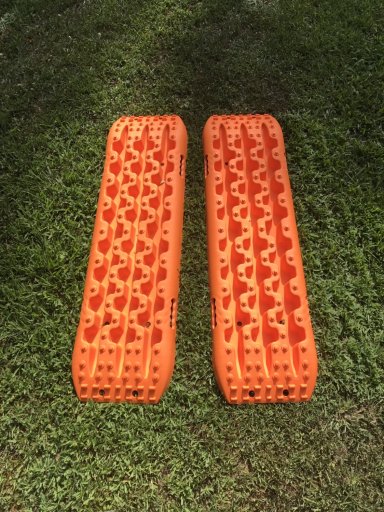

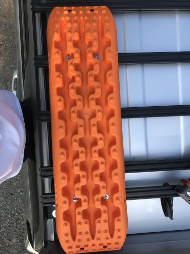

Mounting for the X-Bull Recovery Boards
Hardware (All from Lowe's):
Time: 30 minutes if you are winging it!
2 - Hillman 1/4-in x 2-1/2-in SS Carriage Bolt – 311188
2 - Hillman 1/4-in x 3-in SS Carriage Bolt – 311189
2 - Hillman 5/16-in SS Flat Washer – 114189
4 - Hillman 3/8-in SS Flat Washer – 114193
4 - Hillman 1/4-in SS Nylon Insert Lock Nut – 114172
12 - Hillman 1/4-in SS Flat Washer – 311726
2 - Hillman 2-Count 1/4-in Stainless Steel Standard (SAE) Forged Wing Nuts – 136135
