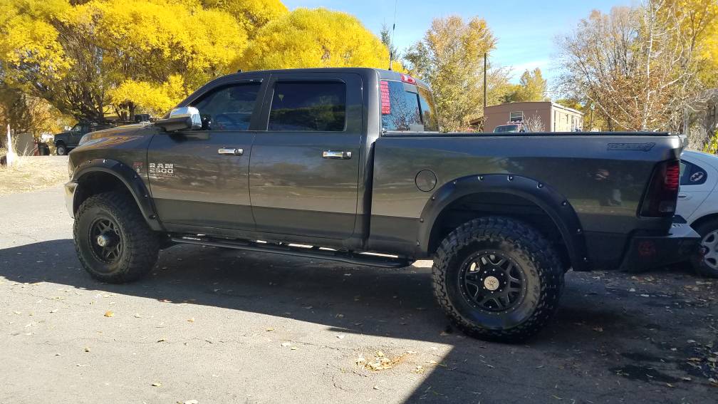

do you have any pics of your beast on level ground?
Pretty amazing build by the way!!
Here is the truck sitting on pavement. Thanks for the compliment. I need to sit down and update my thread as the truck has gone through quite a few changes here in the last few months.
