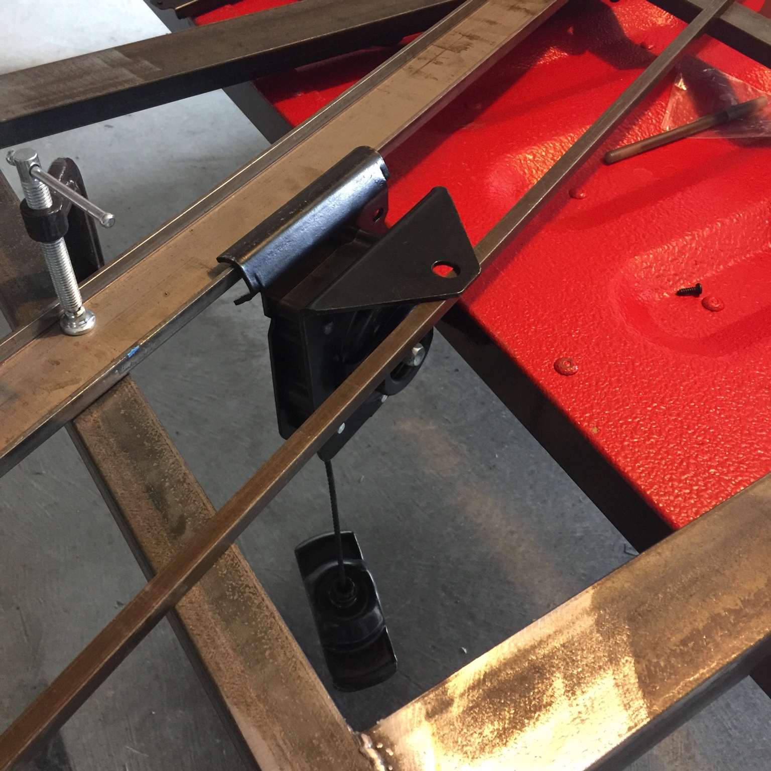

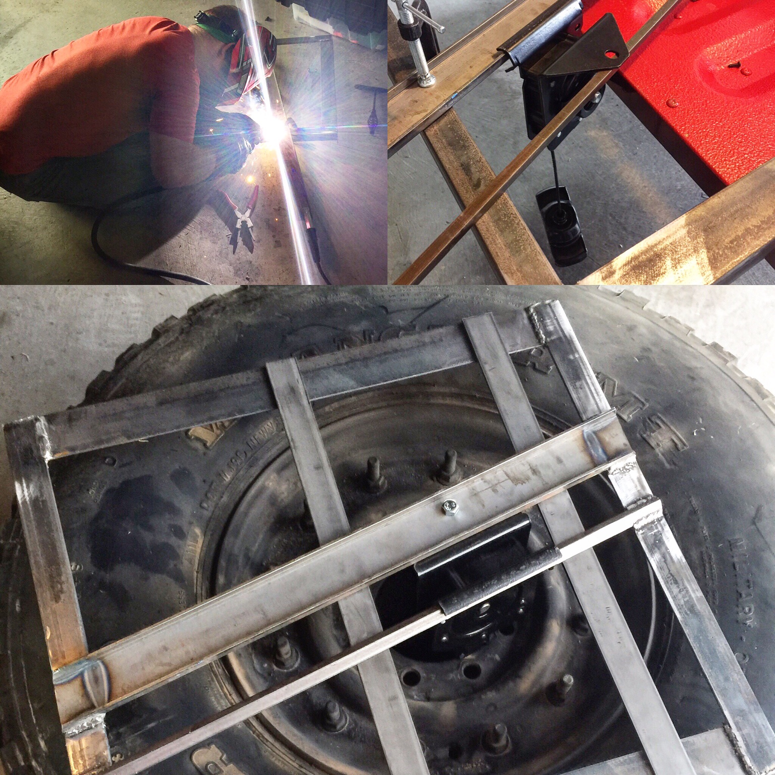

Started my first foray into metal fabrication, as I attempt to create a winch equipped spare tire mount for the M1101 trailer. Pray for me, because my practice welds are atrocious!

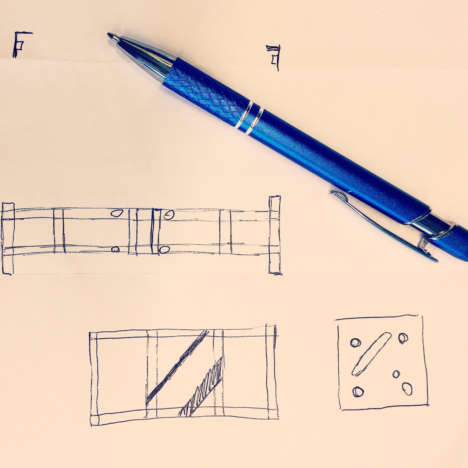

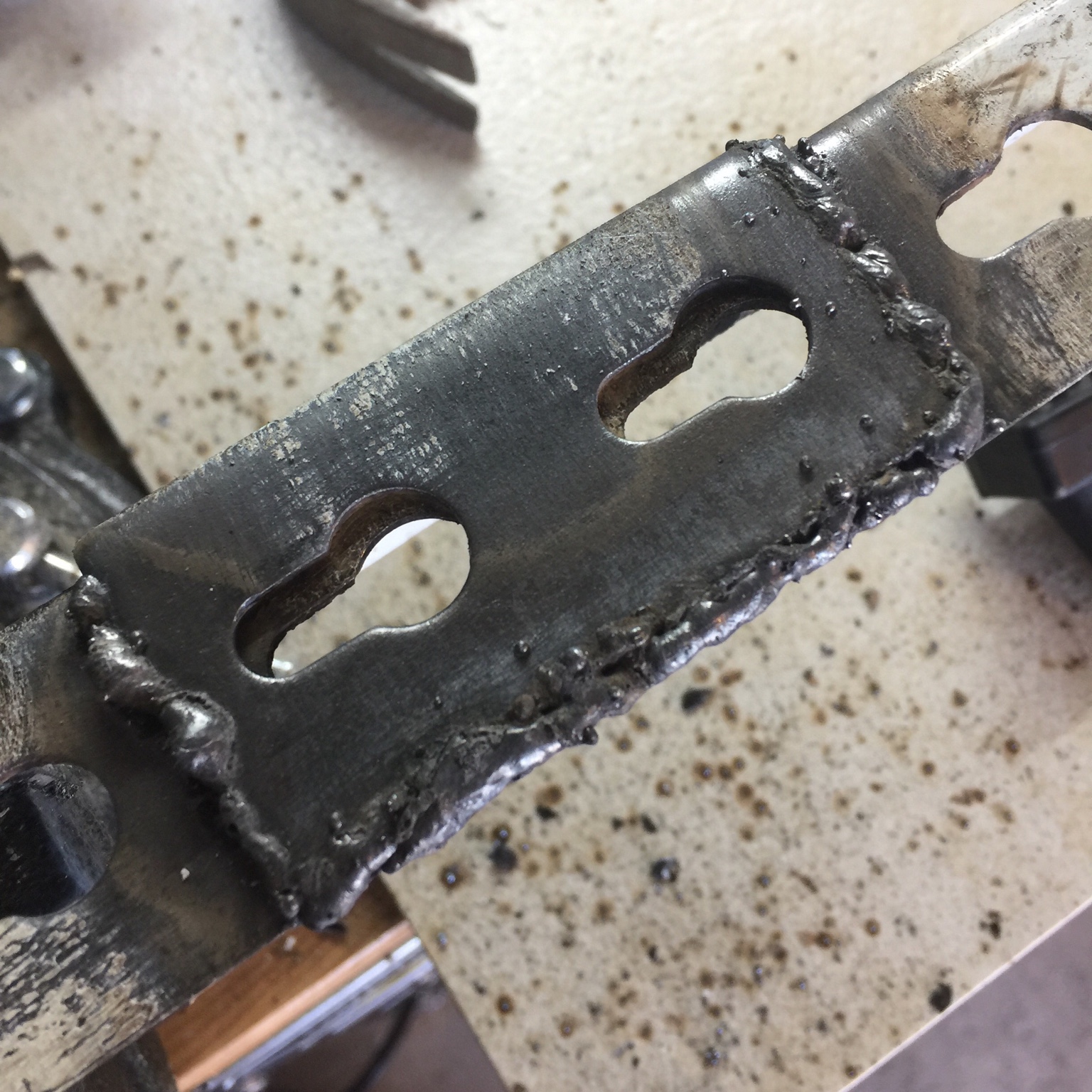

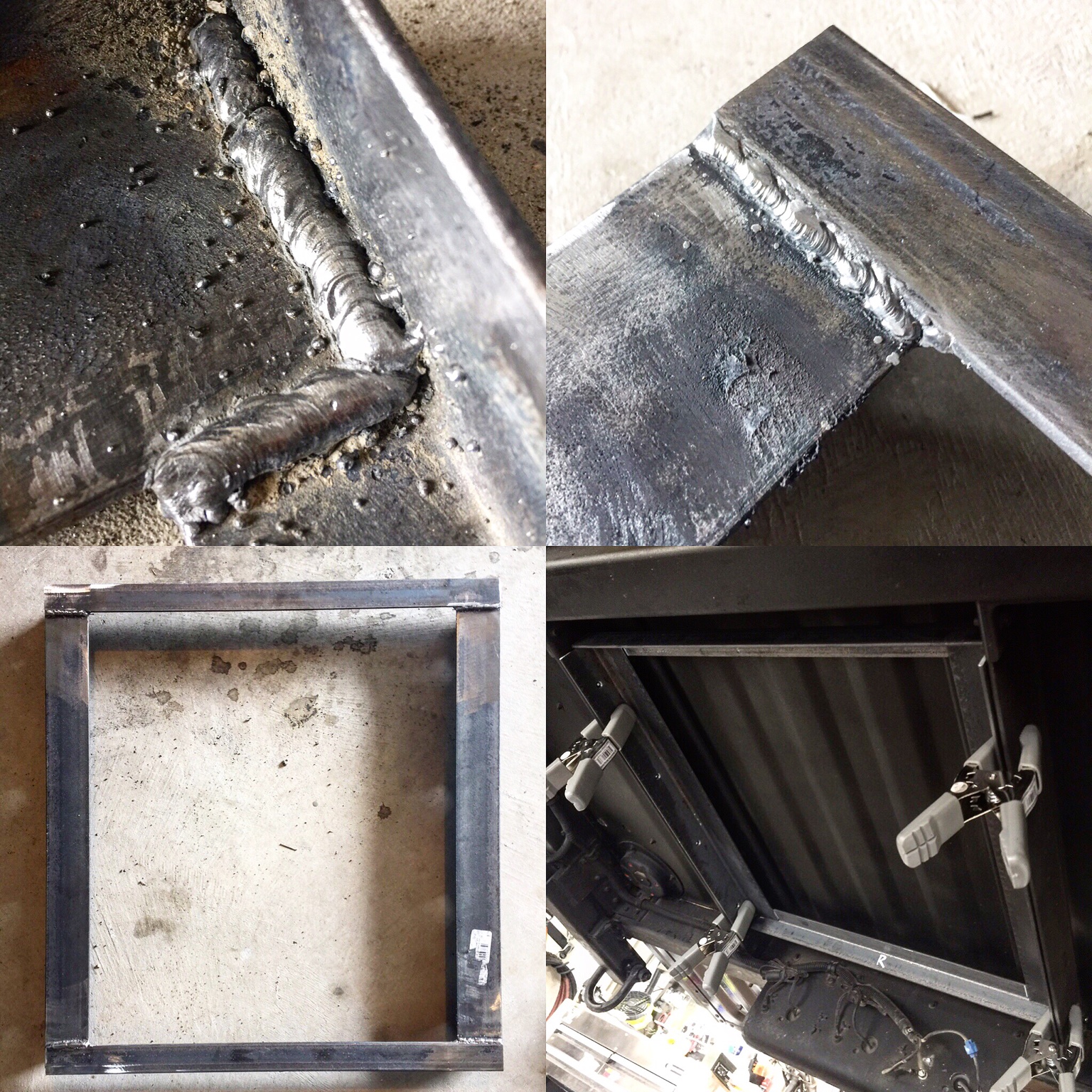

Made a little progress on the spare tire lift. The welds aren't pretty but they should hold.
I'm finding the measurements and angles to be much more difficult than the welding.

That makes perfect sense. I just thought I would go with something simple since I won't use it often. For this application I've been careful to keep the weight bearing portions overlapping other steel, so that my welds aren't holding any weight. Just not ready to put that much trust in myself lol

When you are running non shielded flux core it is often better to treat it like a 6010 or 6011 welding rod. You should step your weld some refer to it as whip and pause. There are some good videos on YouTube showing the stepping technique. It really improves your penetration in the weld bed and helps prevent undercutting. Works really well for open root welds to keep from generating to large of a "key hole" in your weld bed.

Establish a puddle that breaks down both pieces of metal being welded. Then whip out of that puddle along the weld seam. Then come back into your weld puddle. If that makes more sense.
Sounds like you may have your wire speed setting a little high. If you can feel the wire pushing back against the material it is to high. Flux core should sound about like water boiling off in a hot skillet when running right. Just like hard wire with shield gas should sound something like a tattoo gun running or bacon frying.

I was definitely feeling it pushing back, so I just started moving a little faster. I'll turn it down a bit next time [emoji23]
