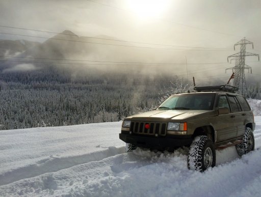

Great looking grand Cherokee btw , makes me miss my zj. 3” of lift with some 33x10.50s that thing rode like a dream off-road and was a blast on gravel roads . The rubicon express super flex kit really delivered on the ride quality and flex. But at the time I needed something that could tow better so it had to go . 036F0AD1-47FD-4C83-B9AE-55E653F72954.jpeg

Very nice ZJ, too bad it had to go. I haven't towed with my WJ yet, but it has the tow package and 265/325 HP/TQ. I think the tow rating was 6,500lbs, but personally I wouldn't push it that high. I have a 24' enclosed that weighs 3k lbs empty I'm curious to hitch up for fun, but I think the overall length and sway would be the issue, vs. the weight. On the other hand, I have a 10x6.5 utility trailer that will fit our 2 seat RZR and I'd guess would be around 2k which should be perfect.

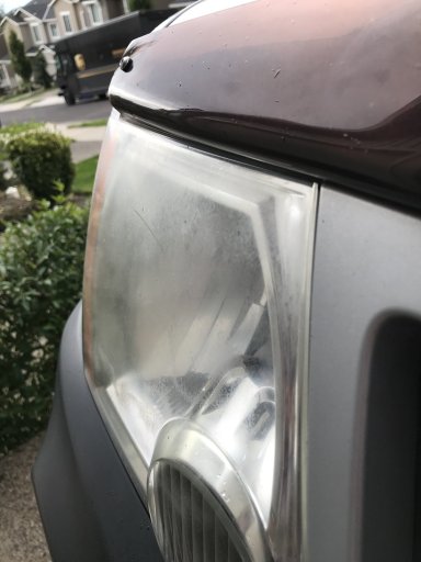

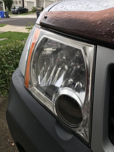

Just did it two times real quick , I need to find the little buffer pad that hooks to my drill so I can get it crystal clear but it will work for now 55B5CA04-B76D-488C-8B25-976BBFB2E303.jpeg

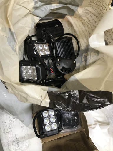

One good thing about getting rid of a long term project vehicle (trying to find some good in it ) is you sometimes find parts that can be used elsewhere . I had bought these LEDs for rock lights for the Jeep I was building but I guess now they will go on the Xterra , not sure where yet but at least I have them . A1E3D26F-9F4C-49DA-B66E-91BE6B5B2EC3.jpeg

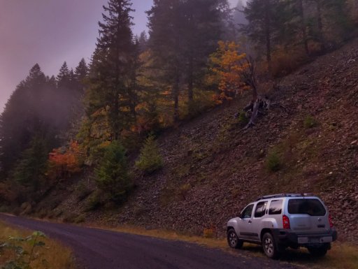

The fiancé got off early today so we used the couple extra hours to go for a little 150 mile drive around the back way up to mount hood just to give the Xterra a shakedown run . Still absolutely in love with this thing , I probably should replace the shocks and struts soon as the suspension seems to bottom out over bigger bumps . 24D4135C-A4DA-441A-83EA-1D8FDC20DCEB.jpegEAEDA997-6027-4D20-86F1-43BB0308AAF3.jpegA858E05F-83A5-4A77-8DE7-1EC668D96D29.jpegE40A2F4B-EF1E-41ED-AA5B-2FB534006D0D.jpeg
