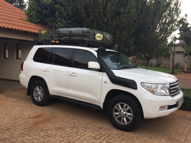

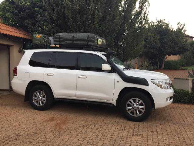

Snorkel, roof rack, drawers, kitchen, fridge slider and dual battery system done!I have 200 amps available, should be able to run fridge and lights for almost 4 days!Getting on nicely now!Next RRT and Eazy Awn!Then the big stuff, bumpers, suspension, winch ext!

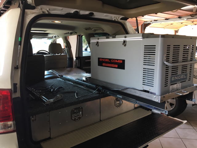

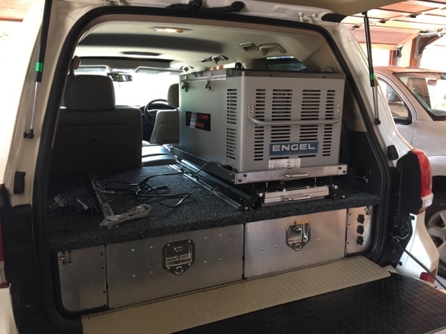

Drawers covered.Today i fitted fridge sliders, designed to fit kitchen table fitted with cutting board and 2 plate gas stove underneath!Fridge rack designed to take a 60L combi fridge/freezer but can go bigger if needed!Reason for the engel you can remove the lid, cause the lid can only open 30 cm when drawer is extracted to outside, still ample i think!Comments or your thoughts will be appreciated!Next to come roof rack ext!
Love watching this build. So nice!

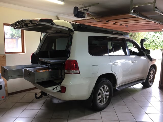

How did you build the drawers? I've been looking at all the photos you posted but can't get a good view of what you did for the drawers. Are the just 1 piece bent and the corners held together with bolts through an L piece of aluminum?
Is it really only 1.5 mm thick aluminum for the drawers. That's much thinner then I would have thought.

Thank very much.Yes I used 19mm x 1.5mm aluminum tubing, with all the relevant corners, L shape, 3 way and a few 4 way's.Actually very simple if you get all your measurement correct!Build a right and the a left hand drawer separately and joined them in the car, otherwise can't get the complete unit in!The wood piece on top also two pieces linked with few hinges to get it inside!Fitting the sliders was easy but tricky to mount to the tubing.Then had the drawers bent out of 1.6 mm aluminum sheeting and fitted between sliders.If you have any more questions please ask!

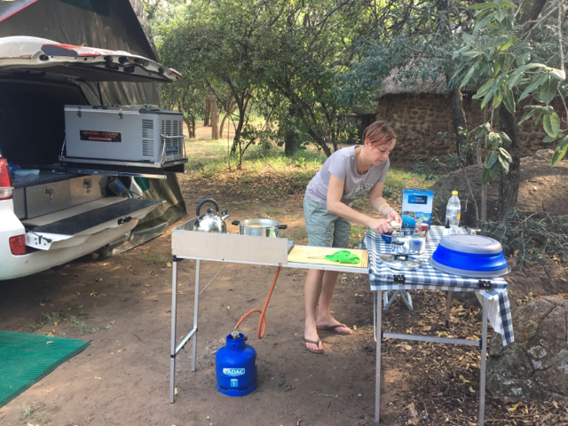

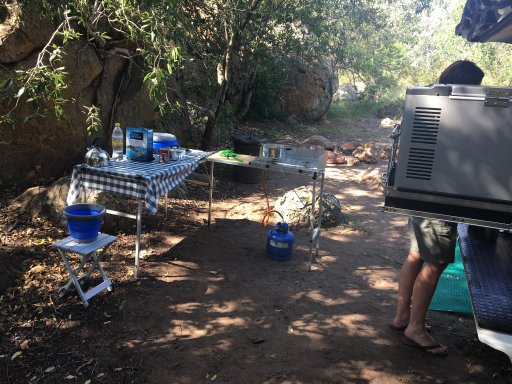

View attachment 16133 View attachment 16132 View attachment 16129 View attachment 16130 View attachment 16129 Now that the drawers are covered I could finish and fit fridge sliders.Designed to take a 60L Engel combi, but can go bigger if needed, for now it's ample I think!Reason for the Engel is that the lid is removable for better access if the fridge is in the car although the lid can open about 30cm when sliders are extractThe kitchen unit slides underneath the fridge and consists of a 2 plate HP gas stove, cutting board and wind screen!This kitchen unit mounts on the rear flap form an L shape workspace are!Anny thoughts and comments will be appreciated.
