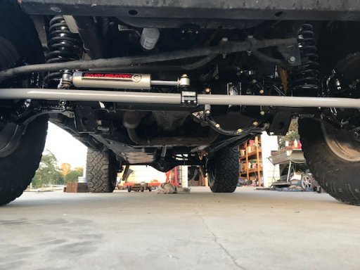

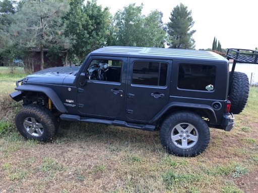

I picked this up about a year ago with a 2" Old Man Emu lift on it which did pretty well. However i knew for what i planned to do with it, i would require more travel and a little more lift.
Over time i will have added the following:

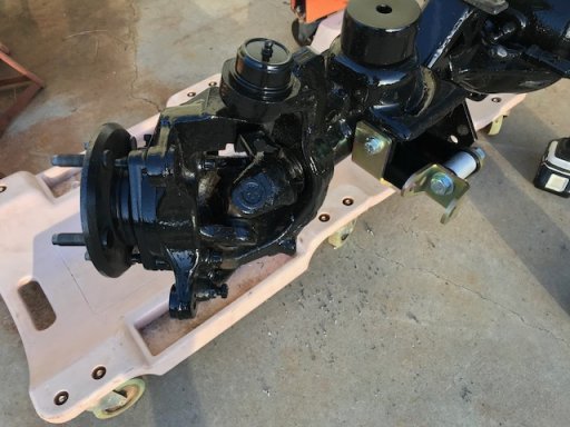

Rubicon Front axle
5.38 gears
Eaton e-locker
Barnes Diff cover
Barnes Axle tube sleeves
Barnes knuckle gussets
Artec Truss
Artec lower control arm brackets
Synergy Ball joints
Synergy Tie Rod
ACOS adjustable bump stops/spring buckets (adjustable from 1"-5" of lift)
2.5" OME springs (Also have 2.5" MetalCloak considering down the road)
MetalCloak Swaybar disconnects
MetalCloak Outboarded Lower shock mounts

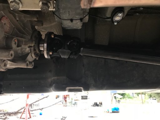

1310 ADCO CV front drive shaft

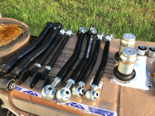

Old Man Emu lower control arms
RockKrawler upper control arms
RockKrawler track bar braket

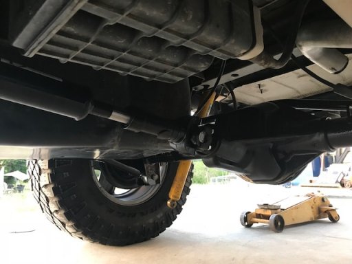

Rubicon Rear Axle
5.38 gears
Eaton e-locker
Barnes diff cover
MetalCloak Shock mounts
ACOS adjustable bump stopns/spring buckets (adjustable from 1"-5" of lift)
custom fabricated lower control arms brackets and skid plates
RockKrawler upper and lower control arms
RockKrawler adjustable track bar
RockKrawler trackbar relocate bracket
2" OME springs (Also have 2.5" MetalCloak considering down the road)
1350 Adams CV rear drive shaft

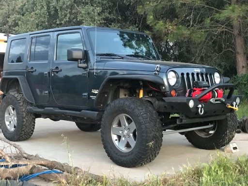

Exterior/Interior
Havoc Offroad Front bumper with 12k Quadratrec winch with synthetic line
Havoc Offroad Rear bumper with swingout tire carrier
TrailGear Sliders
Blackmountain Steel flat fender kit
Waterwich A Piller switch pod (controls rock lights, front/rear lockers and auxiliary lights
8 LED rock lights
Cold Air intake
high clearance exhaust system
TrailDash gauge system and programmer
Underseat lockable storage

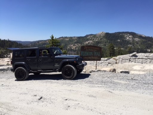

Currently running 35" Duratracs (however i set it up to accept 38" Patagonia MT's)
Has already seen the Rubicon 2 times, Strawberry and several snow runs to Uncle Toms Cabin in the Crystal Basin. Planning a Moab trip next Summer...
