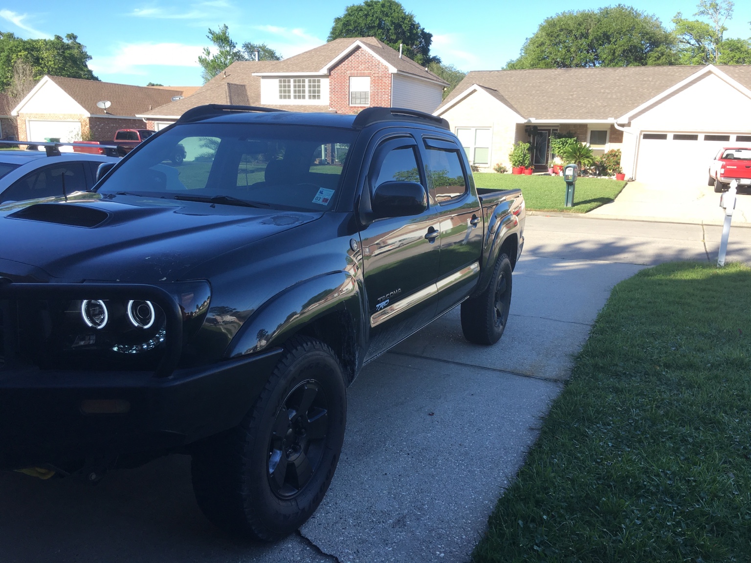

2006 Tacoma sport 4x4 work in progress. What does anyone suggest for the lift. I am thinking 3" should do the trick. Any suggestions on where to get a solid price on a lift? And any other after market parts?!

With that bumper i would go OME, 886's up front paired with nirto 9000's you'll need 3 deg spacers for the rear diff, CB Drop kit for the driveline and the ecgs bushing to eliminate vibes, other than that you'll love it. a very functional lift for overloading. Not overkill and not "too" taxing on the pocketbook.

OME is a quality kit that will last you for years.
If you wanted to step up a little and go to a coil over shock in the front instead of struts, Look at the ICON Vehicle Dynamics systems. They start with an adjustable/rebuildable coil over shock up front and 2.0" Aluminum smooth bodied shocks in the rear. From there you can add upper control arms, remote reservoirs for the shocks, and more that you have probably never thought of.
