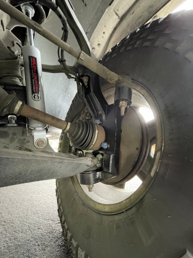

Well I’m trying to be optimistic but I am running into a small issue already . With the lift set at about 6” it is sitting hard on the jounce bushing . Now I’ve owned lifted torsion bars Chevys in the past and my normal formula for making it right nice would be to put on a 6 inch lift and run it about 5 1/4 inches left to keep the preload off the torsion bars but at that point it’s usually slightly above the Jounce bushing. Idk I’ll play with it later but man the ride is a lot worse now . F40DE658-7583-4771-84A7-010284D57CA1.jpeg

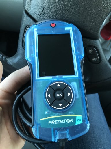

I used to have a predtor tuner before and it worked great, i want to get into HP tuners for my current rig. Also thats a big lift block in the rear, why not a deaver spring pack?

Well I’m trying to be optimistic but I am running into a small issue already . With the lift set at about 6” it is sitting hard on the jounce bushing . Now I’ve owned lifted torsion bars Chevys in the past and my normal formula for making it right nice would be to put on a 6 inch lift and run it about 5 1/4 inches left to keep the preload off the torsion bars but at that point it’s usually slightly above the Jounce bushing. Idk I’ll play with it later but man the ride is a lot worse now . View attachment 196395
With my cognito lift i used 1/4 inch spacers up front to clear uca with 35x12.5r17 factory wheels.. can’t comment on jounce stops as my kit relocates jounce stops to lower arm bracket.. normally you want them to just barely touch...

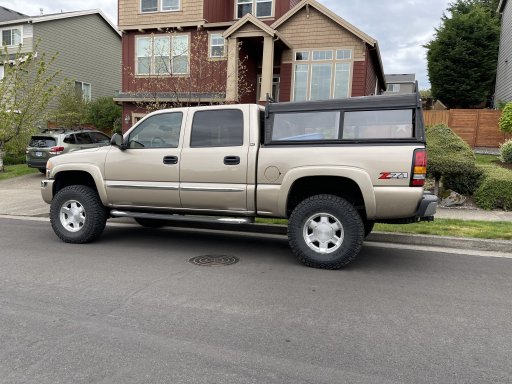

Got the ride better by lifting it more and trimming the bumpstops . It was basically resting on the bumpstops so when I trimmed them the truck lowered 3/4 of a inch . It’s taller than I wanted and I kinda wish I went 4” but still happy with the way it looks ...... might just need bigger tires 35249B73-9EB6-469A-9AF8-35AC35C88879.jpeg

Got the ride better by lifting it more and trimming the bumpstops . It was basically resting on the bumpstops so when I trimmed them the truck lowered 3/4 of a inch . It’s taller than I wanted and I kinda wish I went 4” but still happy with the way it looks ...... might just need bigger tires View attachment 196622
Nah, the tires look pretty good to me.
Tires look a good size. Lift looks respectable without over -doing it. The whole truck looks good.
Theres a difference between a workin', badass, ready-to-go truck, and a beautiful truck. I went a little on the beautiful truck side this time. But yours looks like it's down for whatever. A heavy load. Camping. Riding two-tracks. If the look translates to capability, you're good.

Truck looks good! Im not surprised that the ride isn't great though, those shocks aren't known for being good ;P
the rear is fantastic and the front is wayyyyybetter now that it’s not being fully supported by the jounce bumpers . Picking up a winch this weekend so after that’s all on and I get the suspension dialed in the hight I want coilovers will save the day for a much better ride . Also thinking of fabing up some mounts so I can install some air bumpstops down the road .
