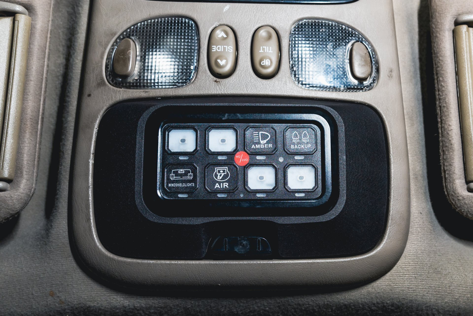

Thanks Jim - it’s been a long time coming to update it. Still needs a touch of refinement, but I’m very stoked on it. :DWOW! That switch holder set up looks great!

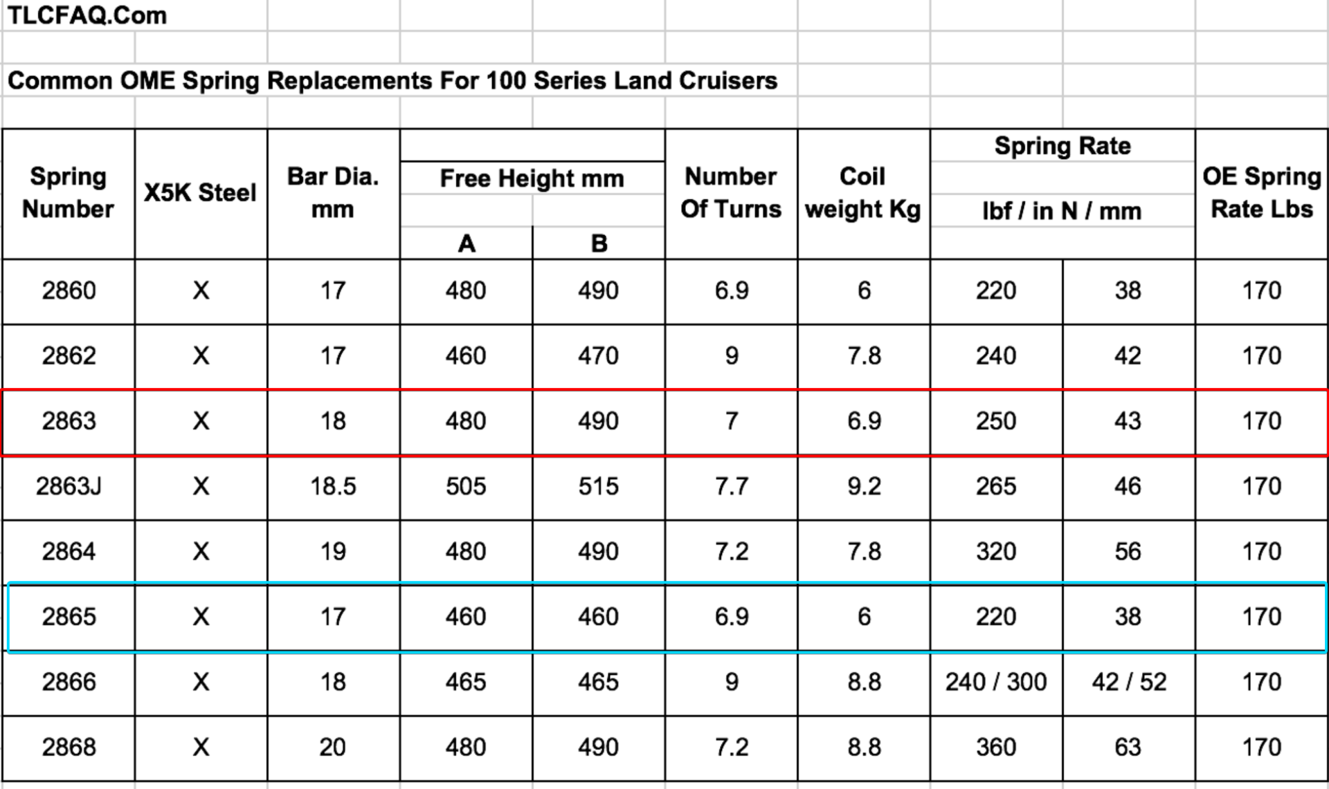

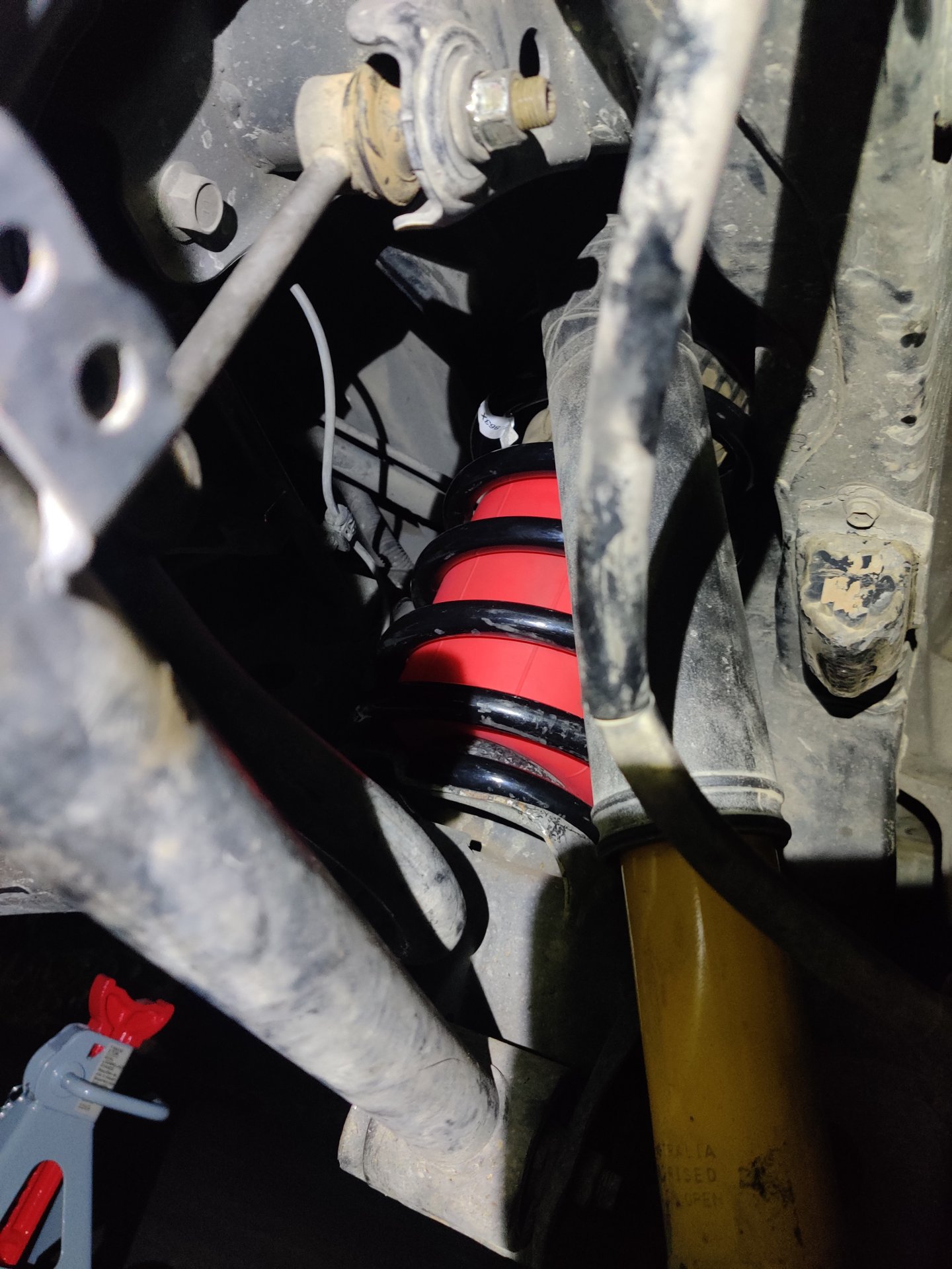

Rear suspension:
- 2863 with 60812 air bags at 50psi
- 60020L OME
