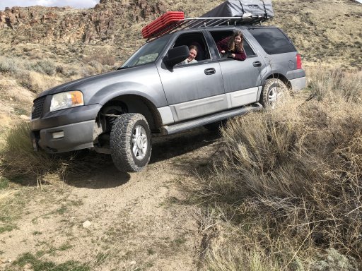

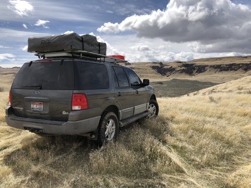

I have yet to scrape my running boards since adding the Truxxx lift/leveling kit... I wouldn't remove them again after trying that once. It makes it quite difficult for my wife and youngest child to get in. The running boards have actually become an integral part of the truck, helping us access the roof rack, etc... Also great for short ride-a-longs off road (little birding)...
I think it may have a couple more inches of clearance with them off, but the trade off is not worth it in my opinion, plus there are a lot of other things under there that will touch down before the running boards...
I wanted to purchase an aftermarket set, but all the ones I have found have a cheesy pinch welt mount, whereas the OEM Ford running boards have a 6 point mounting system, 3 points to the frame, and 3 points on the pinch welts. I've had two full size adults stand on the OEM Ford running boards with no problem... I put half my weight on a set of N-Fabs on a Dodge Ram and the whole thing tweaked and deflected... dumb... and I only weight 140lbs...

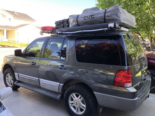

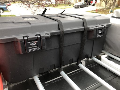

So... UPGRADES! I was tired of using my motorcycle straps, as good as they are, they are a pain to get on and off... wrong fit for the application.
Anyway, I started thinking about the whitewater rafting world, which we are also involved in, and found what I was looking for.
Loop straps. I bought the 15’ models so I could get them in black (rafting straps are color coded so you can easily tell a 6’ strap from a 12’ strap), then I cut them down to size.
The loop on each end allows them to remain captive, attached to the rack, even after I pull the cases off.
They were about $6 each at my local rafting shop.

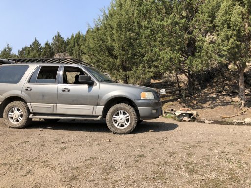

I’ve learned a lot over the past few months...
I’ve learned:
-This full size rig is awesome for great, light-medium off roading with the family.
-It is heavy, making muddy situations problematic.
-Despite the 3” lift and just under 31” tires, rocks in creeks still wreak havoc on the underside.
- There is no replacement for new friends with winches.

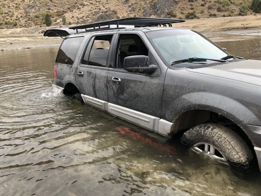

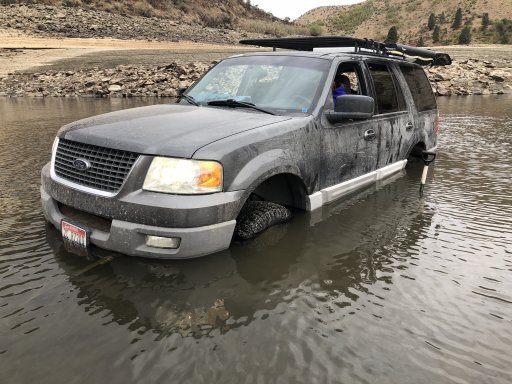

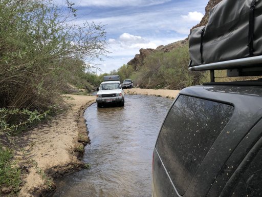

Since the last time, I’ve had the rack powdercoated, went on a crazy offroading trip with a good friend to Tiddie Springs, near Silver City, Idaho (where two old dirtbikers basically told me an Expedition had no business being there, to which I showed my taillights to crawling back out), then today got bogged down in a creek crossing with my family for six hours until a friendly Wrangler and F150 showed up with not one winch, but two winches to pull us out... we were so stuck that the first winch didn’t budge us...
Anyway... I’ve learned a few more things...
-To take a group vote before diving head first into things (namely mud pits and creeks).
-To pretend I’m a Subaru and stick to dirt roads, where we are safe.
-To walk (spot) any creek crossings or mud before sticking my heavy Expedition in them.
