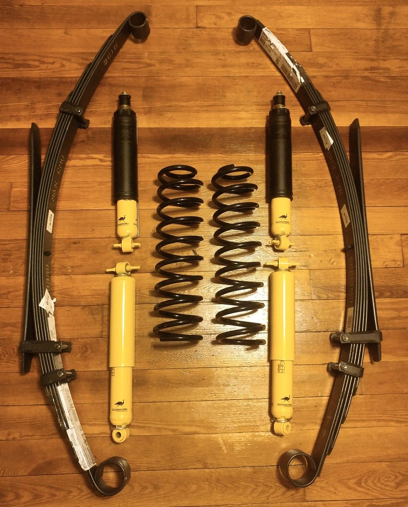

Having gone the cheap route with my TJ lift I didn't want to do that with the XJ, especially with the intentions of a road trip/overland vehicle. After a little research I went with a lift from Old Man Emu/JKS kit from Dirk at DPG, to keep this XJ is only getting a 2.5 inch lift, over 3 inches and you can get some issues with these vehicles.
OME Lift by Emerson Bowling, on Flickr

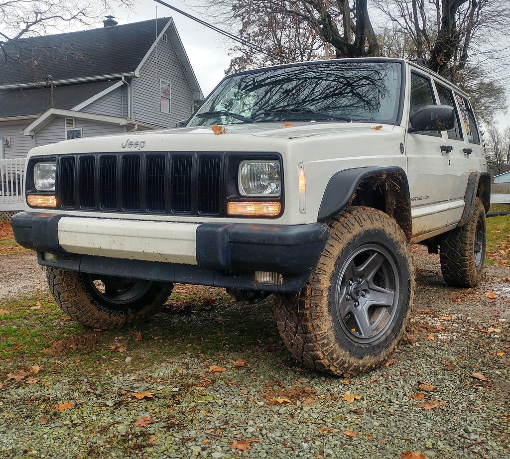

I knew I wanted goodyear duratracs, having run them before on my wrangler. But that created a problem. In a 15 inch wheel they only carried a 31x10.5r15. Not wanting to run a 10.5 I decided to go to a 16 inch wheel to open up more options. Which brought me to these mammoth wheels, cheap but good reviews. Went for it for $99/ea for a 16x8.
This allowed me to run my ideal size. 245/75r16

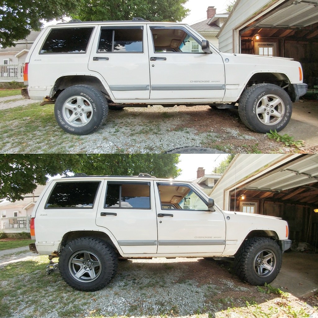

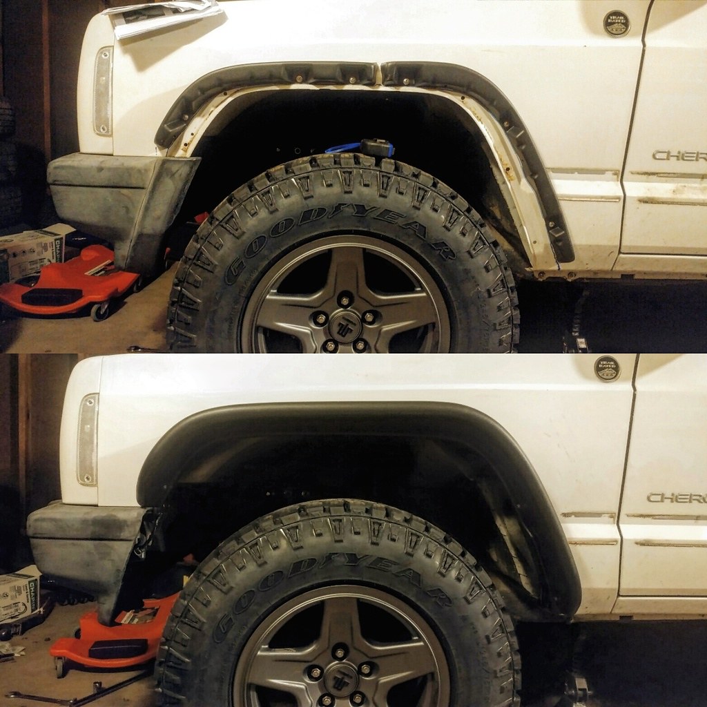

Here is a before and after shot. The jeep is lifted 2.5 in the front but no fender trimming yet. The rear is somewhat trimmed but no lift installed yet. I'm lazy haha
Before and after by Emerson Bowling, on Flickr

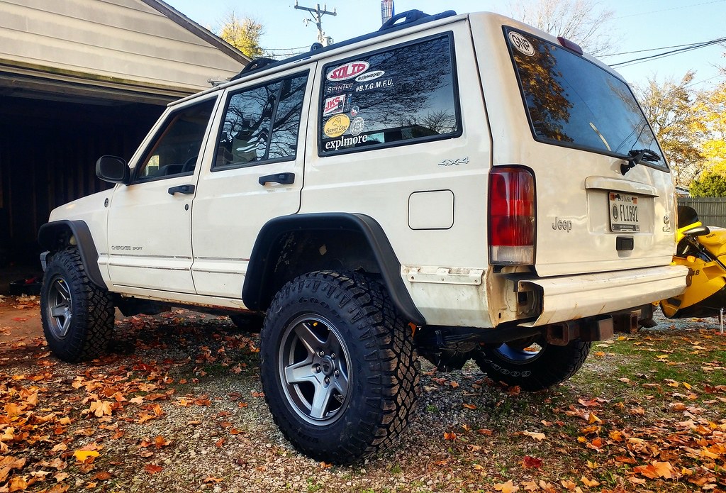

Terrible at updating this but its finally lifted and been driving it for about 2 weeks now. Love the OME lift, rides really smooth for a leaf spring rear.
The past few weeks has been just updating some little cosmetic things and cleaning up loose ends.
-Installed clear marker and running light lenses, a much better look IMHO. Also red tented the turn signal markers in the tail light. I cant stand the orange yellow color on a white vehicle lol its an eye sore
-Installed Hella E-Code headlights with a 80/100w bulb, have a upgraded headlight wiring harness waiting to be installed along with it.
-Reconditioned the bumper plastics with a heat gun, first time I've done this and it crazy how it brings the color right back
-Installed a Azzy Design Works transfer case linkage setup. This gets rid of the prone to disengaging stock linkage and replaces it with a simple one linkage setup with no body mount.
-New Kenwood stereo to replace my old aftermarket radio that was stuck on a Rush Limbaugh AM talk radio station.
-Installed SOLID front and rear differential covers and did a fluid change
Waiting to be installed is a pair of Hella 500ff driving lights. Those will be installed when my Dirtbound Offroad front bumper gets here. I went with their Mojave bumper, I like the design look of it and the fact that has a receiver up front. I've chosen to run a removable winch setup, when I do buy a winch, for the fact that its deadweight when not in use. Which will be 90% of the time for this XJ.
After the bumper goes on I think im going to start my interior cargo build of shelving and drawers.

Showing the extra space the tires get after the Bushwacker flares go in place
Fender Trim W/ Bushwackers by Emerson Bowling, on Flickr

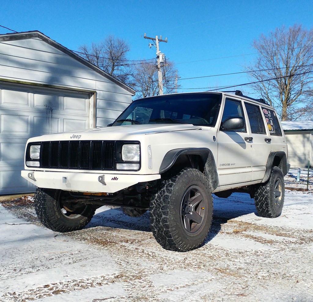

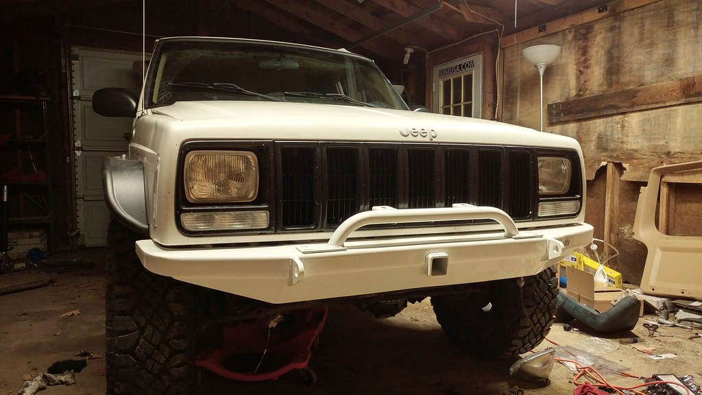

Got the bumper test fitted, love the white! Very happy with my choice to color match it. In the process of putting in the bracing plates for the bumper itself, I ran into issues with the steering box bolts and the spacer breaking. Should have known better with this jeep haha So now the jeep is stuck in the garage waiting for a JCR steering box spacer and an upgraded Dodge Durango steering box to go in.
Bumper Fixing by Emerson Bowling, on Flickr
Ended up installing my upgraded injectors and hood risers since I have downtime now. Hopefully the clean injectors will alleviate my fuel mileage issues (fingers crossed)

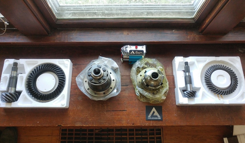

Coming in march - april time frame I am going to get the stuff for my regear. I have decided on running 4.10's. Also much to the dismay of my wallet, that i am going to run ARB lockers in the front and rear. May be overkill at this point in time for the use of the cherokee, but I don't want to have to open everything back up on the axle and go through it all again when they do become a necessity for the build.

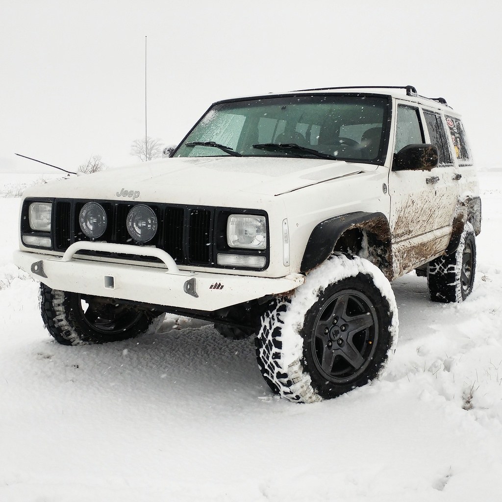

Spent yesterday installing my driving lights and hoop on the bumper. Happy with how it turned out and love the lights
Snow XJ by Emerson Bowling, on Flickr

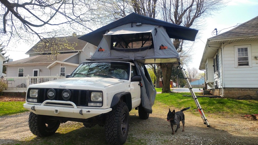

Actually just installed it for the first time
Tepui on the XJ by Emerson Bowling, on Flickr
Overall very happy with it. Deploys quick (even for our first time) and folds back up even quicker. Maybe one or two small things i could gripe about like one of our internal storage bags has a hole in it and then some material choices like velcro. I think it'll wear out pretty quick seeing wind and weather all the time. We cant wait to go out and use it!

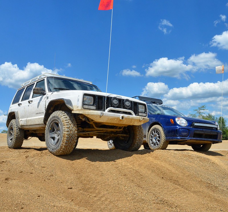

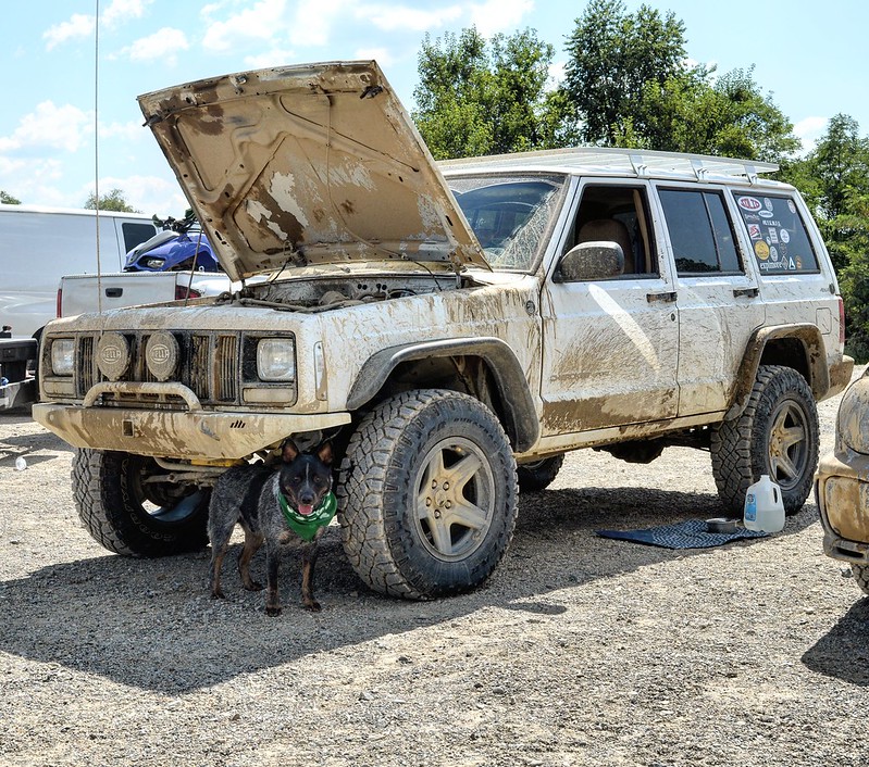

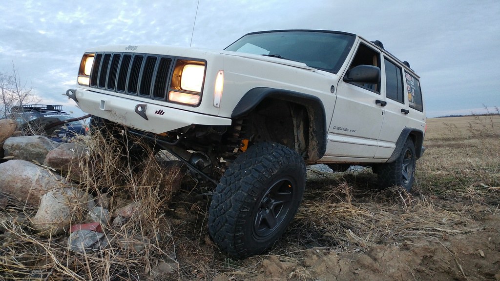

And the big one..... 5 Cooper STT pro tires in a 265/75r16. After thinking on it and thinking on it and hovering over the 'add to cart' button. Then thinking on it some more I decided I wanted slightly larger tires. Just over an inch taller and slightly less than an inch wider but more importantly much more aggressive.
What pushed me over the edge to buy the tires was the off roading trip I finally got around to taking. Don't get me wrong, the duratracs did great but boy did they load up fast in mud. Either way had a great time at the Badlands here in Attica, IN. The jeep surprised me with some of the obstacles it tackled, but between some tight trails and a not so tight driver, I managed to dent in the passenger side front fender (enough to catch the door stopping it from opening all the way), Slide the rear quarter panel into a dirt wall <--this one i didnt feel like I couldve avoided, and back into a tree and bust the driver taillight. All in all though it was a successful trip and feel like I pushed the jeep harder than we will on most of the trail we are going to incounter on the western trip
Dog was excited on the way to the badlands, don't think he like the rough trails to much though haha
Much excite by Emerson Bowling, on Flickr
My buddy came out with his subaru, small lift and good sized AT's. Surprised at how good it was.
Cherokee and friends by Emerson Bowling, on Flickr
Assessing the damages and airing up to head home
Aftermath by Emerson Bowling, on Flickr

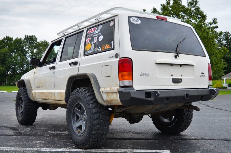

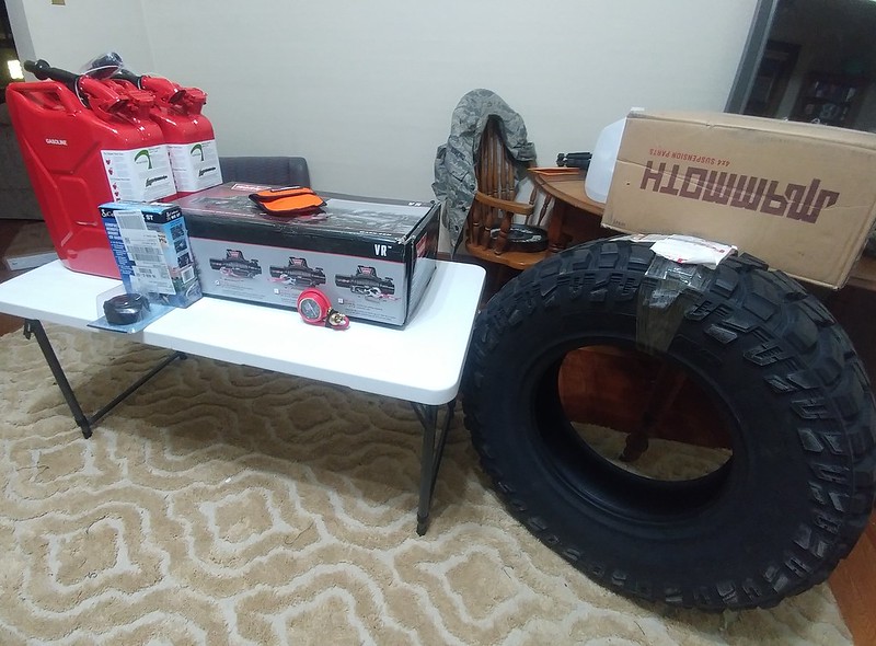

Amazon fairy dropped of a load of stuff yesterday! Surprised the floor of the porch didnt cave in lol
Amazon Fairy by Emerson Bowling, on Flickr
Everything came in early and with the new Coopers sitting on the porch of course the first thing I had to do was quickly get them installed before discount tire closed. So here are the 265/75r16 Pro's mounted with a 1.25" alloy USA spacer and a 2.5" OME lift.
Cooper STT pro&#x27;s fitted w/spacers by Emerson Bowling, on Flickr
Its a bit tight for my taste on wheel gap so we are going to try a extra spring pad up front and throw the extra leaf in the rear turning it into a 3" lift.

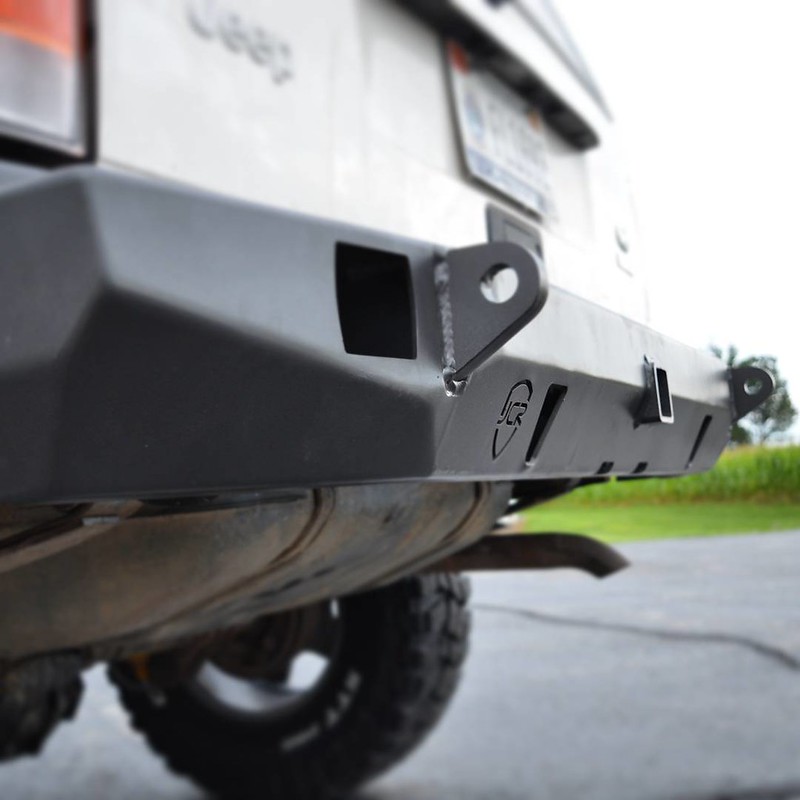

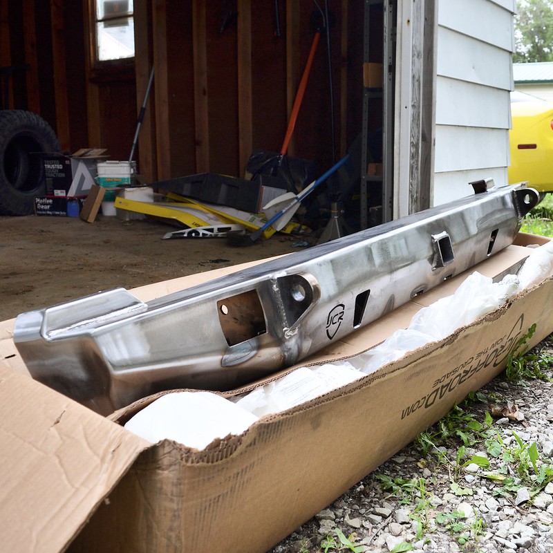

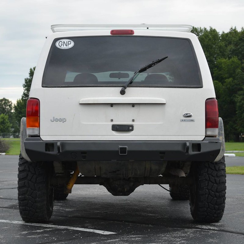

Today right after I got home my neighbor text me saying I had a huge box that was delivered to her house instead of mine, I slightly confused because all my Amazon stuff was already here. So I go over and to my surprise a huge box from JCR made it here already! In it was my rear vanguard bumper, Hawse fairlead, and bumper nut strips. Happy it got here so fast, allows me to get things installed periodically instead of all together which I was not excited about doing right before the trip lol
JCR vanguard rear bumper by Emerson Bowling, on Flickr
Extremely pleased with the bumper from JCR. The brackets and gussets look super stout and the build quality looks great! Plan is to prep and paint it tomorrow. While that's drying ill be removing the stock rear bumper to hopefully get the xj ready for an install on Saturday! This being a Midwestern jeep we'll we how that pans out
