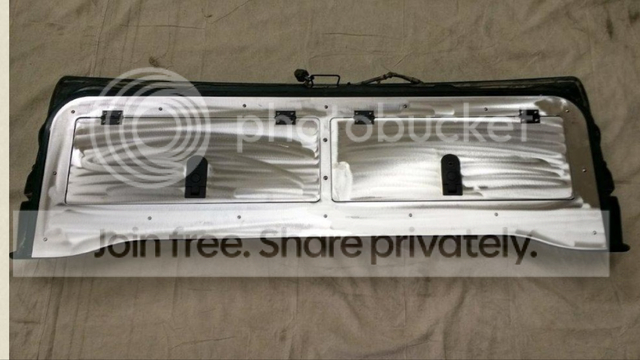

Check out this post from @donuteater (part of his build thread)
So now for some of the fun stuff. Like all my vehicles the first thing I did was tint all the windows and strip off the running boards.
A few other small things I have done so far are a LED full kit-dome and door lights and Trail Tailor Tailgate Storage lid
I will get some better pictures of the tailgate but I am very impressed with how the product came and was an ease to install.
Looks like they still make it. http://trail-tailor.com/store/p28/80_Series_Tailgate_Storage_Lid.html and some storage toys for the 60 series
http://trail-tailor.com/store/p27/60_Series_Tailgate_Storage_Lid.html
http://trail-tailor.com/store/p46/60_Series_Storage_and_Blank_Quarter_Panels.html
