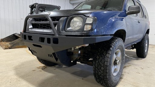

This is the first time doing a build for something like this. I've never just drove around looking for adventure in a 4x4 i've flown. I have family in colorado and love going out there. I always has a rental car and wanted to get further out into the hills. For months I looked for something I could buy for around 6k and wanted the 4runner but they are just to expensive and way to many miles for the asking price for me to jump into. I found a 2003 Nissan Xterra with 120k from out west for $3500. The guy said the transfer case was bad so I drove it around and found it to be the rear axle had been switched out. They took the 4.9 gears and put the 4.6 so in 4 the back would try and run the fronts over. Found an axle at a local yard and swapted the axle shafts and carrier leaving the housing in place. A bunch of little things needed replacement like rubber hoses and door switches. It runs good and drives well for an older truck but then again the entire front end was replaced including the idler arm, centrelink, ball joints, tie rods, front sway bar links and all the fluids I could find. I wanted to run a mild lift just to run some skinny 33's so I had to get a body lift which I never liked but was needed. I knew I was adding a bunch of weight so I added nisstech torsion bars(NOT FUN) and add a leaf. So with a mild 1.5 inch lift and 2 inch body lift there is room for the Toyo Open Country AT3 in 285/75R16. The back bumper I made from scratch(not doing again) and the front is from coastaloffroad and highly recommend. The kit was easy to weld up and looks good. At this point I'm waiting for some extra cash for the winch, RTT, fridge and making my own drawer system. I have a bunch of things to go over for a trip out west in boxes that need sorting. I just got in the HOTTAP V2 nomad and its great for dishes and showers. I have coleman cooktop, jetboil, pans and dishes 2 jerry cans, traction boards, 7 gallon fresh water container, small med kit (upgrade needed) the diesel heater just in case and 2 huskey water tight boxes full of stuff I need to sort. I've read for months on the basics and try not to get things I don't need. I plan on leaving around may so have a few months to iron things out I hope. I have a 65 watt solar panel and want to get s solar generator instead of the extra battery and inverter. I hope this little monster will last a while to explore the midwest and beyond and work my way up to the arctic ocean someday.
