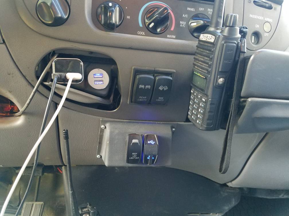

Thanks man! Yeah. These trucks seem to be lacking good real estate to mount switches! I also ended up installing a switch panel for a Jeep under my heater control switches as well

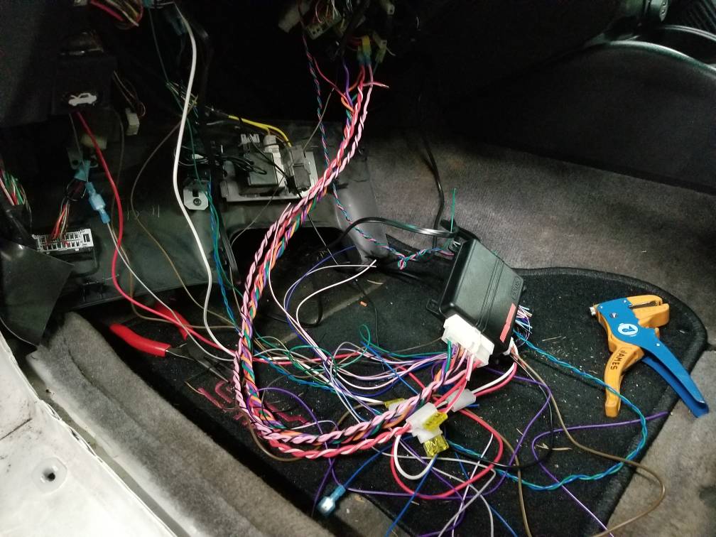

I hear ya! In fact I'm gonna need to rip into my wiring again here real soon. I have a few other light Ideas that I'm gonna play around with, and I also need to install my new remote start/alarm system. So, I'll be rerouting and cleaning up some of my previously installed wiring and making some improvements while I'm all up in there. I'm definitely no expert in vehicle lighting or installing aftermarket goodies. But my only advice is, use relays on the higher output Light Bars, and fogs. Otherwise you will burn up your switches eventually. When I run my wires, I keep them all wrapped together in poly lume and then electrical tape sections of the lume closed so that none of the wires have a chance to stick out and rub on anything sharp causing shorts. I also went with a separate fuse box that I mounted down below my dash, that is easily accessible in case something gets torn off my vehicle during my off-road shenanigans.
I also used RV plugs with polyurethane sealant for my roof mounted lights. I didn't want wires being torn out or through my roof if they get snagged on some tree limbs. Instead they just unplug. There are other options as well, but I felt it was the safest method.
I'll take some photos of my wiring when I crack back into it. Oh!! It's also a good idea to use a drill to twist all of your wire together. Least the stuff that's all going to the same general location makes for a much cleaner install. Car alarm guys use this method alot.
basically like this.
