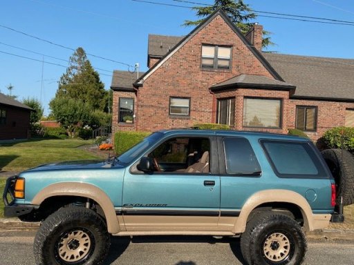

So here's the rig, as of today. . .
Here is the list of major modifications (listed front to rear, sort of):

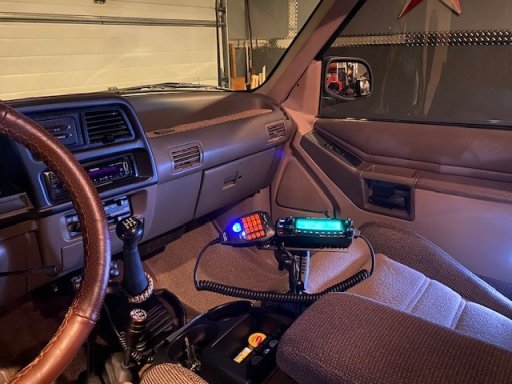

Some interior pics:
Visor shelf with switch panel / GPS . . .

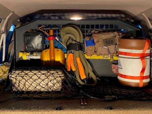

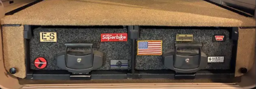

Rear cargo area:

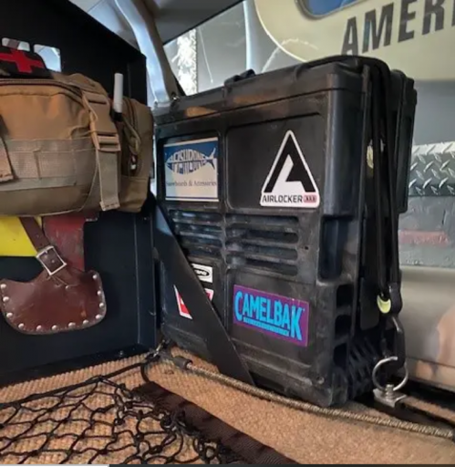

Outback Solutions (ARB) drawer system modded to fit the Explorer; headache rack keeps the gear in the back from impacting the driver in case of sudden stops, as well as a great lashing point for bulky items.
Old NATO plastic ammo case for fluid storage:

Secondary color swap. . .
Long story short - - I went with the gray secondary color based on a mis-read of the Monstaliner paint color chart . . . that was 5 years ago, and since the interior is beige/brown, made sense to shift to tan on the exterior. . .
Also upgraded wheel tire combo to mount my buddy's Bronco take-offs in 315/70 R17 tires so added an inch or so in height over the 33" tires previously on the rig.
