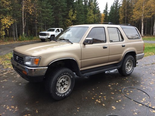

What was your experience like with your 3.0's? My T4R is getting a donor short block, decked heads, new rings, gaskets, bearings, water/oil pump - essentially a full refresh. Also wrapping the crossover exhaust with heat tape, new head studs, AC delete, ADD hub delete, Cruise delete etc. Anything major maintenance wise you would say watch out for? Planning tentatively on 33x10.5x15 Toyo Mt's on the SR5 rims, think I will have any issues turning them with the stock 4.56 gears?
I know all this stuff can be found on various forums, but it would be nice to get a fellow OB members perspective.

I never had an issue with the 3.0, I know they have a reputation but I personally had no issues. It had over 150k on it and I drove it home from AK to IN and then more than a few times to the UP (1100 mi round trip). You won't have a problem turning the larger tires, I don't remember much power loss when I put the 33's on the 3.0 4runner but gas mileage dropped considerably. If I remember, and I could be wrong here, but I think that 32's will fit that without a lift but going that wide, I'm sure you are planning some lift. The 22re really didn't have a problem with them either but top speed was about 60-65. I know the 3.0l have the bad rep. but I honestly didn't have any problems. It's kinda odd to me but I see more of the 3rd gens with the 3.0l than any other years so that's gotta say something. Those were sort of the beginning of the end of the ridiculous rust problems that Toyota had, so maybe that's why, or it's just my imagination. Seems like you're getting all the important stuff done anyway so really the only worry I would have, if I were you, would be diligent maintenance. That is one clean looking rig though, especially for Alaska! Love to see it when you get it... Never mind, were never finished... ;)

Thanks for the input, I agree that most of the vehicles you see on the road are indeed the 3.0.
You were right about the lift, just 1 1/4" spacers (BJ and rear coils), + some new stock height Moog coils and 1.5"+ shocks all the way around. I have seen many threads where people fit 33"s with just a little persuasion.
I am planning on going either Toyo MT's or the AT KO2, in either the 31 or 33 in the 10.5 flavor.
What kind of gears did you have in your 3.0, manual or auto tranny, truck or T4R?
Thanks again.

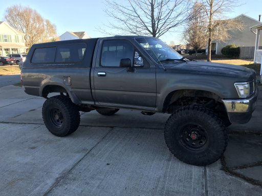

I'm just about done with my yota, I can't wait to share with a build thread of my own. 79 cab on a 84 4runner frame and drive train. Hysteer, lift shackles 5.29s and 35's. Fresh rebuild with cam header and exhaust. I wanna get a shell for the bed and build a camper out of it.

Sounds like a crawler! I think the 5.29's and the fresh motor should turn those big 35's nicely. Good luck on your build!

Good looking rig @ThexColexMAN ! Thanks for sharing. I will always have soft spot for these old 3rd gens, especially in the single cab configuration! Glad to help out with the inspiration.
