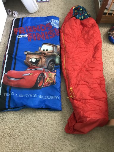

Shape:
When it comes to shape you want to get a mummy bag. Mummy refers to the overall exterior shape of the bag. A Mummy bag sleeping bag has a hood on it that can be cinched tight, broad shoulders and then the bag tapers to a skinny foot box making the classic shape of a mummy. This is opposed to your old school cotton rectangular sleeping bags. If you’re sleeping bag is a perfect rectangle and has no hood it won’t do much to keep you warm out there. I you’re sleeping bag has any kind of cartoon character print on it like lightning Mcqueen it’s probably going to leave you chilly!
Here is a child's rectangular bag next to a child's mummy bag. The rectangle bag is great for sleep overs but the mummy bag is what you want to use while camping. I don't have an example of an adult rectangular bag but it looks the same just larger and instead of lightning mcqueen it often has prints on it like camp, hunters, ducks, deer etc...they also come in solids but if it's rectangular and cotton don't use it out on the trail.

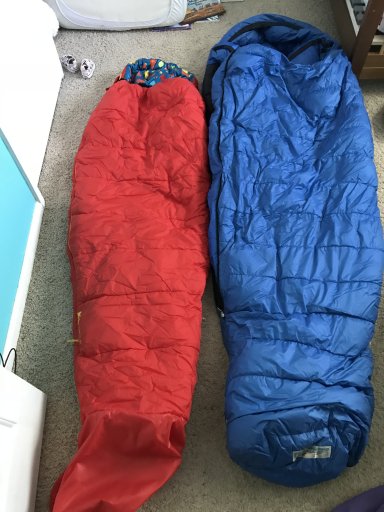

Here is an adult mummy bag and a child mummy bag:
In short buy a mummy bag with a hood. Next is fill.
