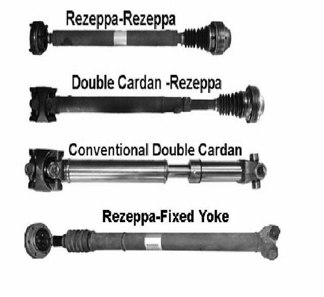

SO my WJ's front drive shaft has a CV on it and everyone is saying that I will need to upgrade it so I don't have drive shaft shimmy. Did you guys do this drive shaft upgrade?
You have what's called a rezeppa joint on your drive shaft those don't take kindly to lifts... Ditch it and find a driveshaft from another jeep with a conventional double cardon joint the stock driveshaft will work up to 6 inch lifts after and even with 6" lift it would be wise to get a lengthened driveshaft.

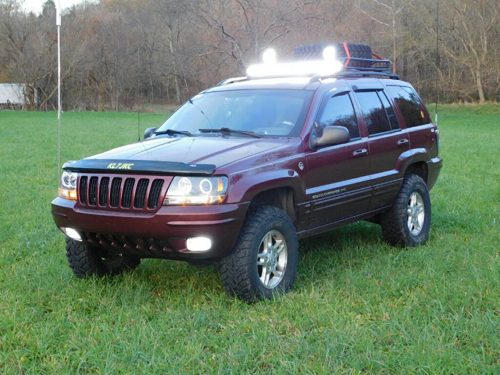

I have been working on mine for about a year. I don't want a mudtruck or competition crawler. I just want to be able to get over the mountain and still drive the highway.
Improvements so far...
3 in IRO suspension lift
32 in Kenda Klever MTs
HF VHF UHF ham radios, CB, and all band scanner
Highlander roof rack
40 in 240 watt light bar
2 45 watt spotties

Thanks all.
Forgot to mention...
Changed front drive shaft to double card and added 1 in wheel spacers to improve the stance with the stock wheels (which I like)...

I'm running a 2.5" lift on my WJ and have no drive shaft issues. I've heard you only run into drive shaft issues at 4" or higher. I have a buddy with a 4" on his WJ and went a few month without issues until he went wheeling pretty hard with disconnected sway bars and really flexed the suspension. Now he has a vibration.

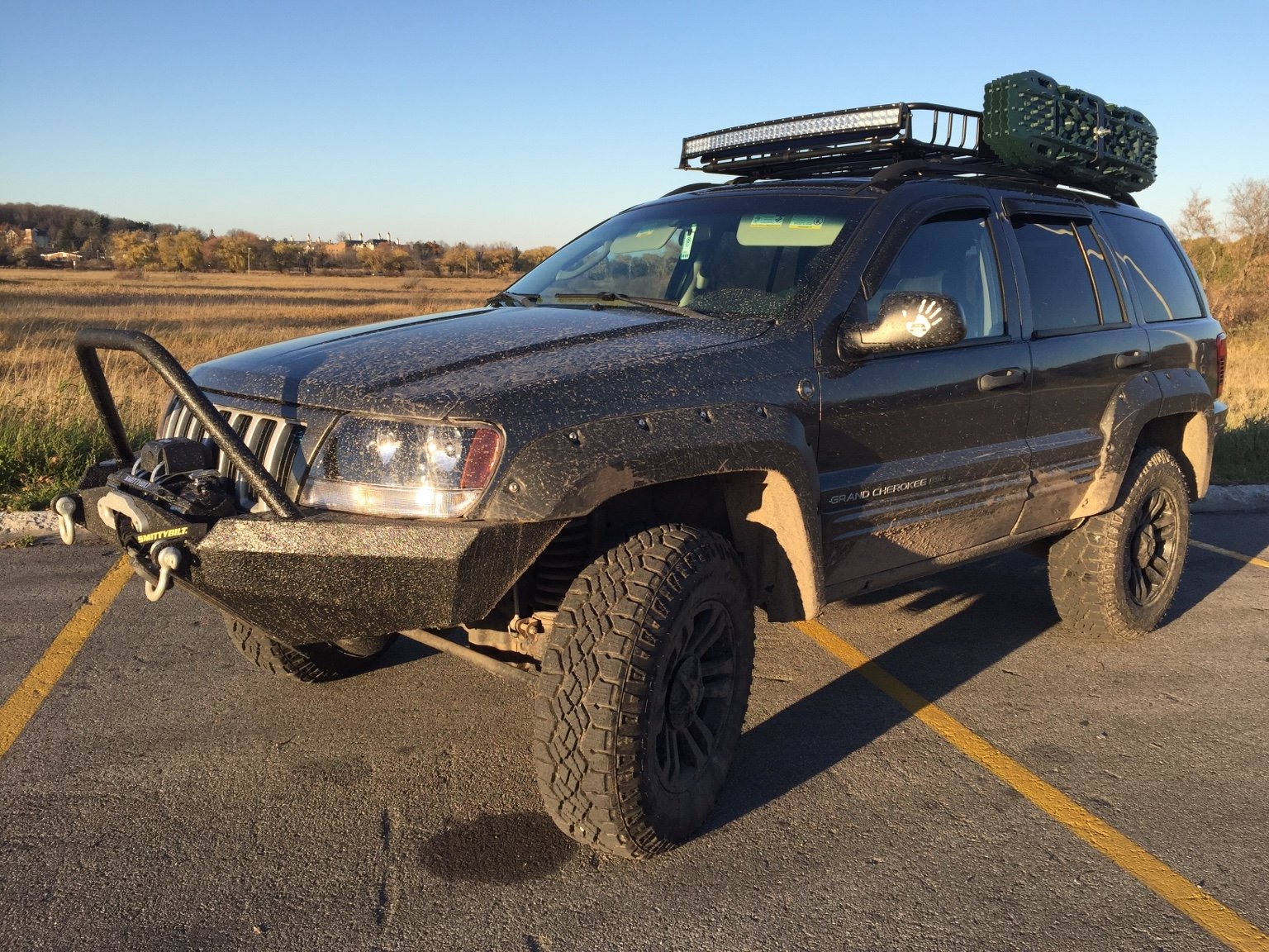

I saw your link and was just looking at that. It is nice, but I really want to get rid of the factory bumper for clearance and approach angle reasons. Still looking at their other versions. Thanks!!!

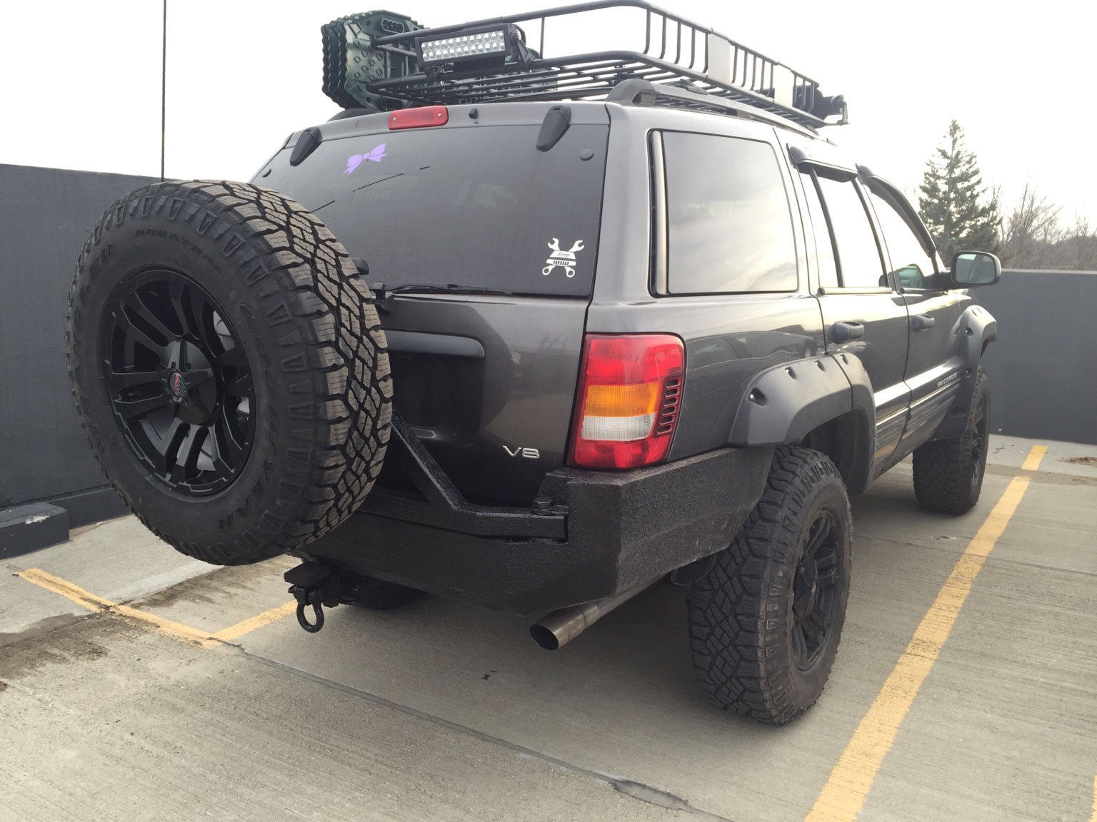

timberwolf_120
3,059
Ridgecrest, CA
0115
Oh wow you got that to fit a lot better then I did. I didn't get the tire carrier one tho.
Looks good and yea gary is a good guy indeed.
What hitch do you have btw? Is it the stock through bumper one or an aftermarket one?
Turbo Tara & Jalopy Jake
2,093
Lake ann, MI
Jake
Hurlin
633
Fits ok .. It doesn't tuck in as much as I would want .. If I spent more time and modified the mounts it would have but I'm happy with it and the gaps help with mud and dirt clean out... Had to relocate the Evap stuff.. And I retained the stock hitch . I do need to relocate my back up camera.. Down a inch or two.. And I'm going to cut the tire mount and angle it more so the top of the 5th tire tilts towards the rear glass.
