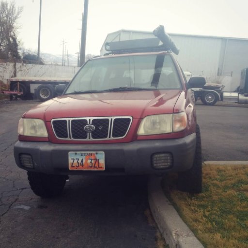

Background: Subaru mechanic for 7 years which has put me through undergrad and most of grad school. Car is completely stock and has 340k miles on the chassis and engine. Will continue to be my daily driver until it dies for good.
That being said, i know this car wont last for ever and differential options are very limited and expensive for the car. It does not have traction control or x-mode like the fancy new ones. Keeping that in mind, i am going to try and make most of my modifications compatible with a future Subaru if I can.
I am also going to try and make most things on my own, because that is my nature and im not a fan of paying for a brand because im broke. I have also read a couple a bunch of the DIY threads on here and they are awesome! I also frequently go to junk yards in my area though, so if i find something i like at a reasonable price, i will probably get it if i have the funds.
This project will be slow as i usually have only one to two days off per week and currently live in an apartment where working on vehicles is prohibited so i have to head to my dad's shop (the one car garage of his house) if i want to do anything.

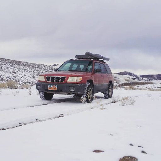

Background story of why, skip if you don't care: I have always camped and taken roads to the middle of nowhere as long as my car could handle it. I love the west desert, and Utah in general. Starting my research and my project this spring was inspired by getting bogged in a nasty muddy rut this spring. It was a place where i have been many times in the past (including the weekend prior) and i was always able to ride up or down the road with the rut. That day it happened to be raining and i had no idea how slick that mud was, and coupled with my cockiness of driving that patch many times, i took the same path. My car slid into the rut and i had a front and a rear wheel without traction. I high centered on my rear diff and my rear cross-member. I tried many things to recover the vehicle, but i only had a screw car jack and a 1.5 foot camping shovel. Put big rocks under the tires, tried to jack up the back of the car a couple of different times, aired down the tires, took everything out of the car (it was still cold and rainy), and nothing worked. My wife was a good sport about the whole deal but was visibly frustrated. She suggest we set up camp and let the storm pass and try and recover it when it dries out a bit. The next morning i was able to get it out using a pallet someone had left by the river. Took it apart and fit slats under the tires to get it out. This got me thinking about a lift kit and then the research and enthusiasm began. I have always wanted to build my own rally car (grew up in Argentina and saw the WRC a few times, hooked since) but this overlanding thing looks way more practical and can be a combination of the two based on what im seeing on some of these forums.
BUILD:
I have separated it into wants and needs with the needs being more prioritized numerically and the wants are numbered a little more arbitrarily. This is based off of what i think i need and my current budget. This will evolve over time as i will be in residency 07/19 and will actually get a paycheck! I would love to get all of your inputs on my list, train of thought, build, and other suggestions you guys may have in general. Be blunt, i dont get offended. If its stupid, or seems unsafe, let me know. In my post im looking for points of views and opinions, not for debate. Im new to this community and its ways of thinking and general knowledge base.
